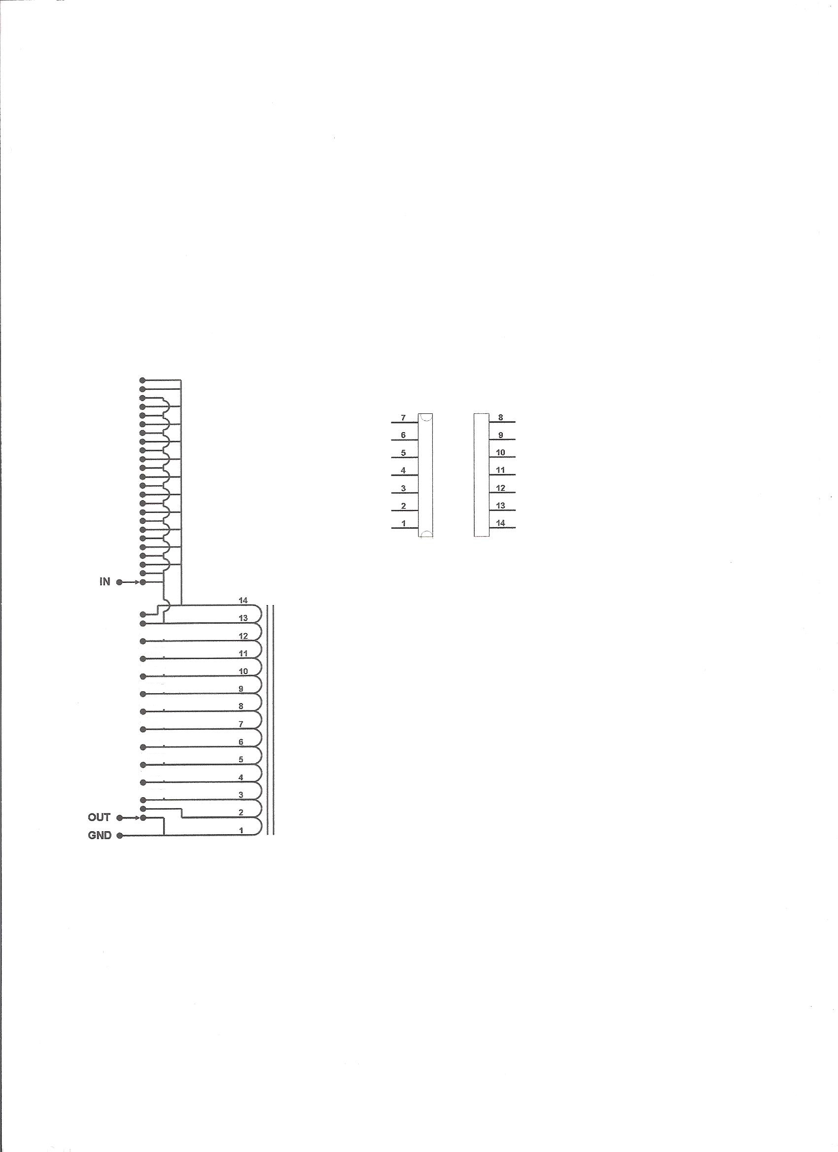

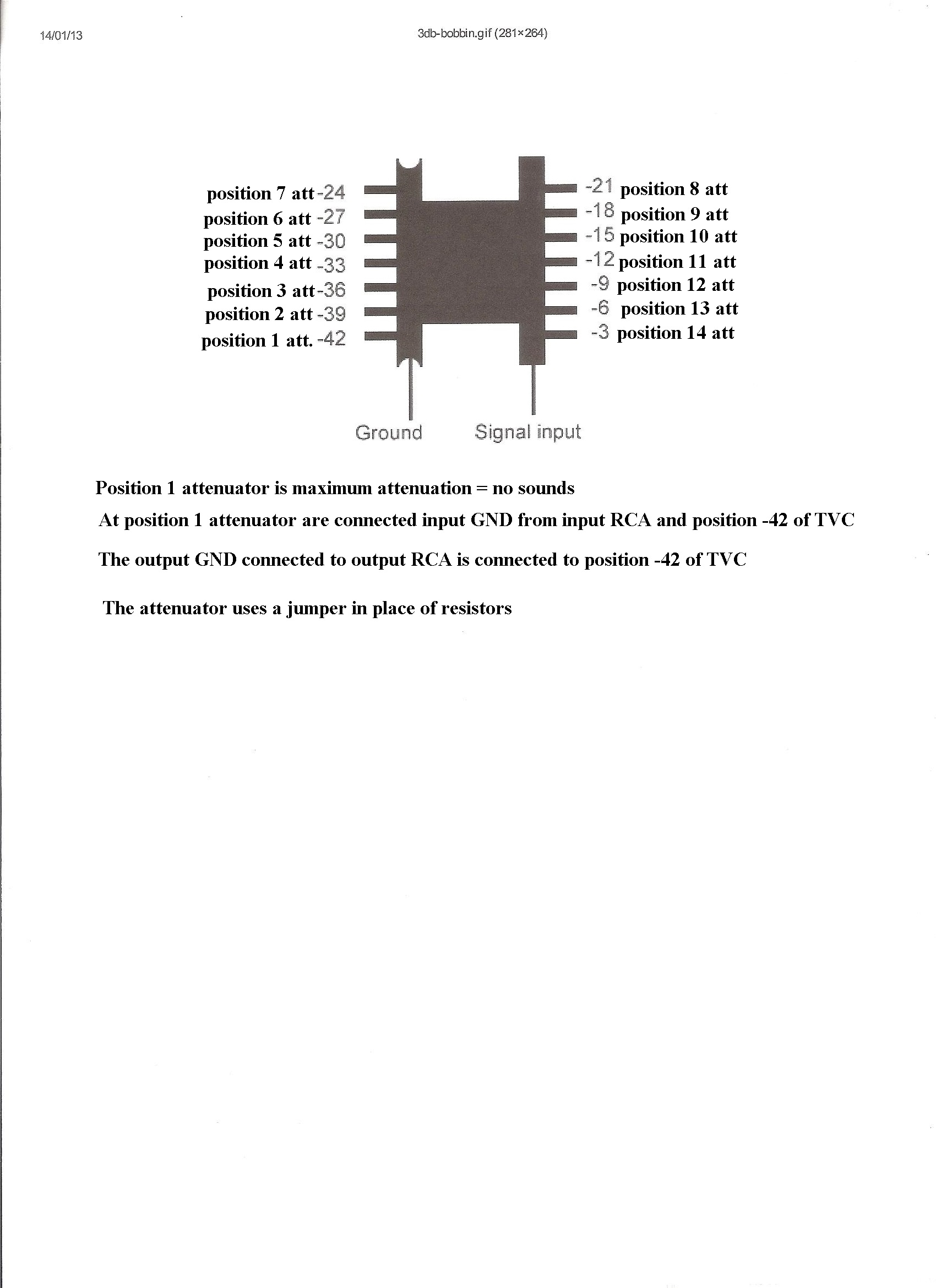

I'm not sure if it's well connected, if is well connected I prefer the carbon pot or better the attenuator with resistors.
How are you connecting the TVC Merlin? Before the 26 (on the grid) or after the 26 (after the cap or OPT, whatever you have)? What are you loading its primarys and secondarys with?
As many has said Before. A FULL scetch would help us help you. Otherwise we dont know if you have missed a grid leak or whatever it can be. A full scetch with the TVC.
If the TVC is coupled on the "switch" icon, then it is on gnd only.
So have I to use without the switch?
Of course not. You still havent published a full schematic with the selector and TWC.

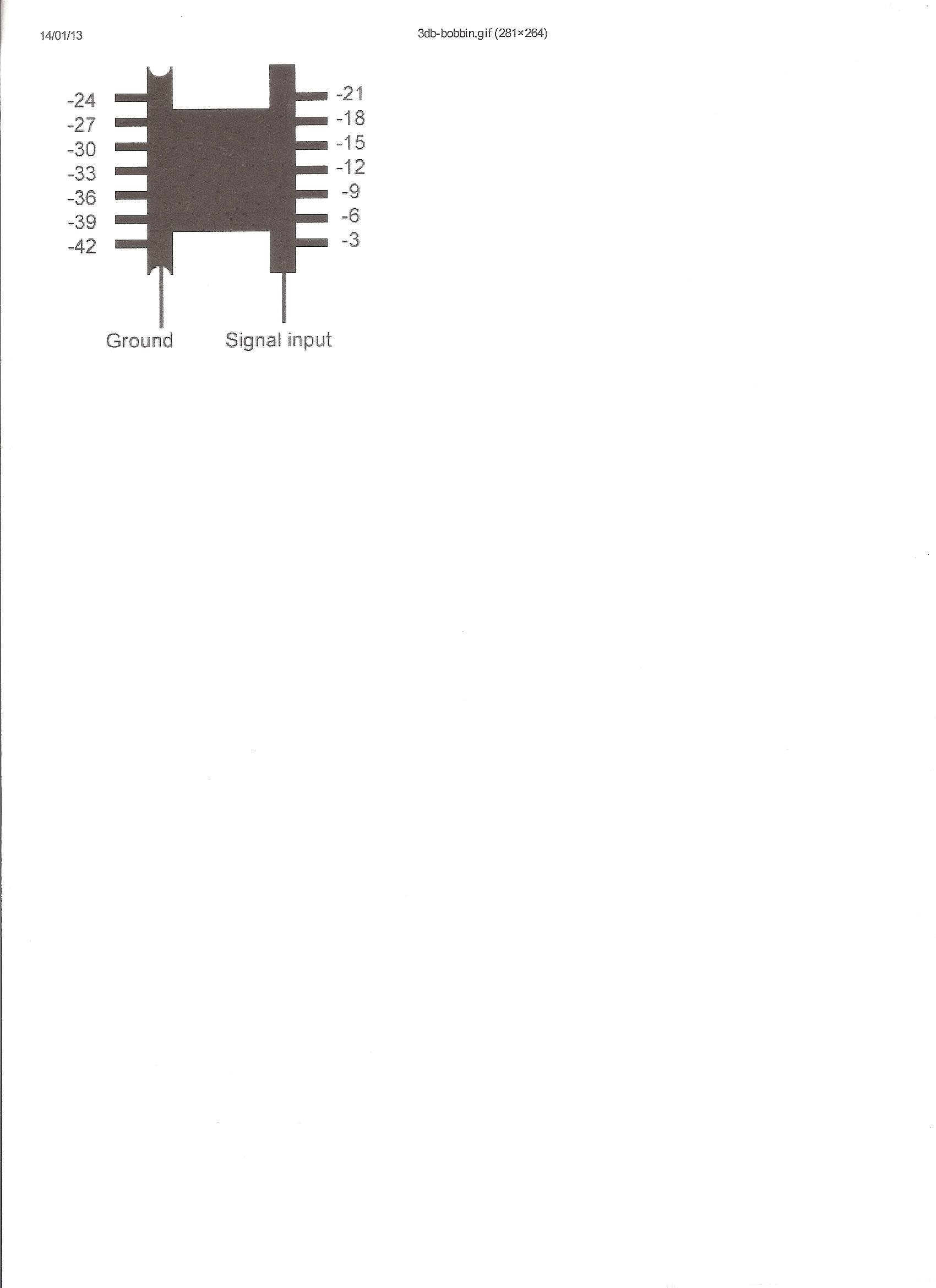

I don't understand the attached image.
Now I understand the schematic post 3397
