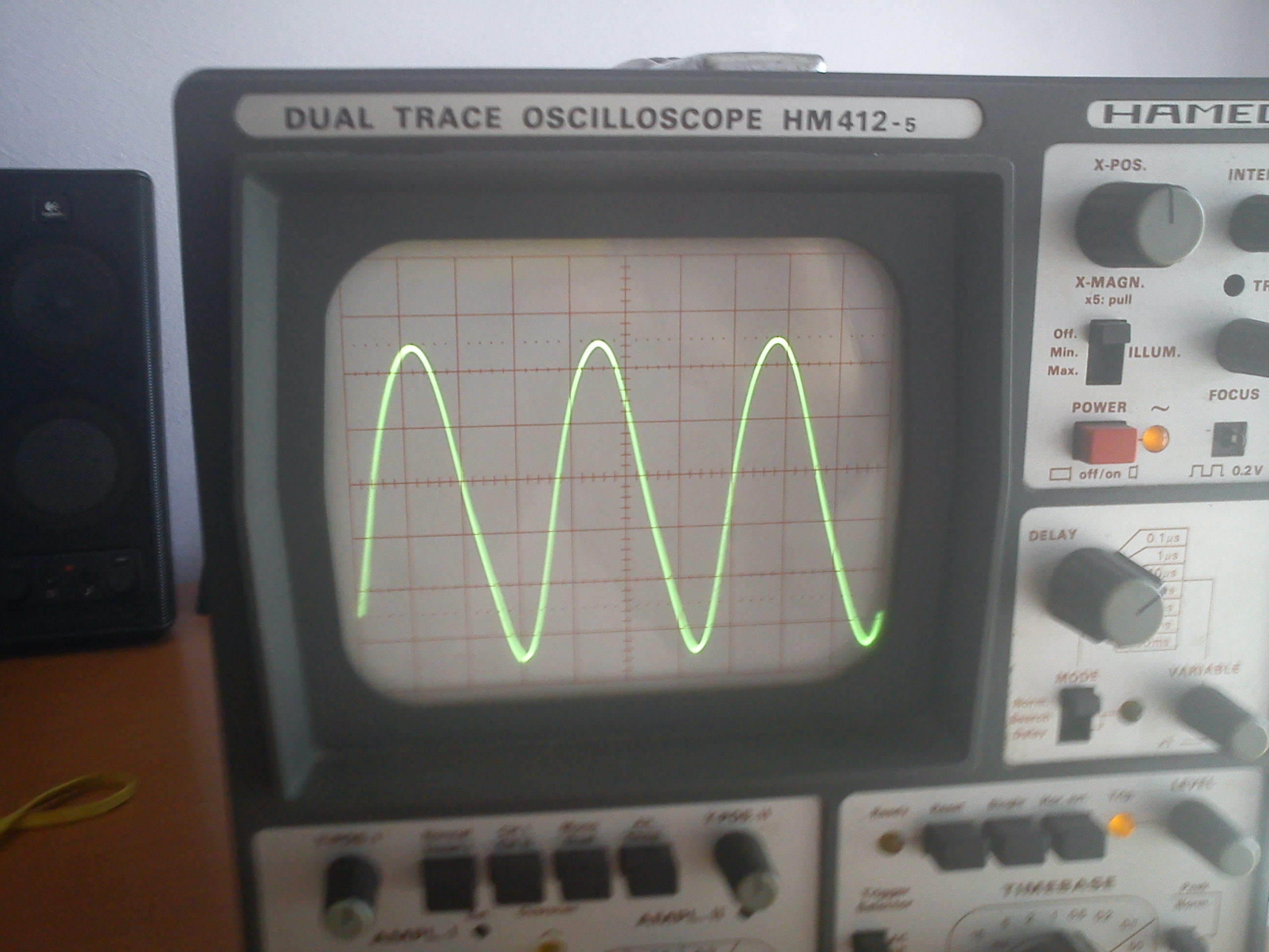

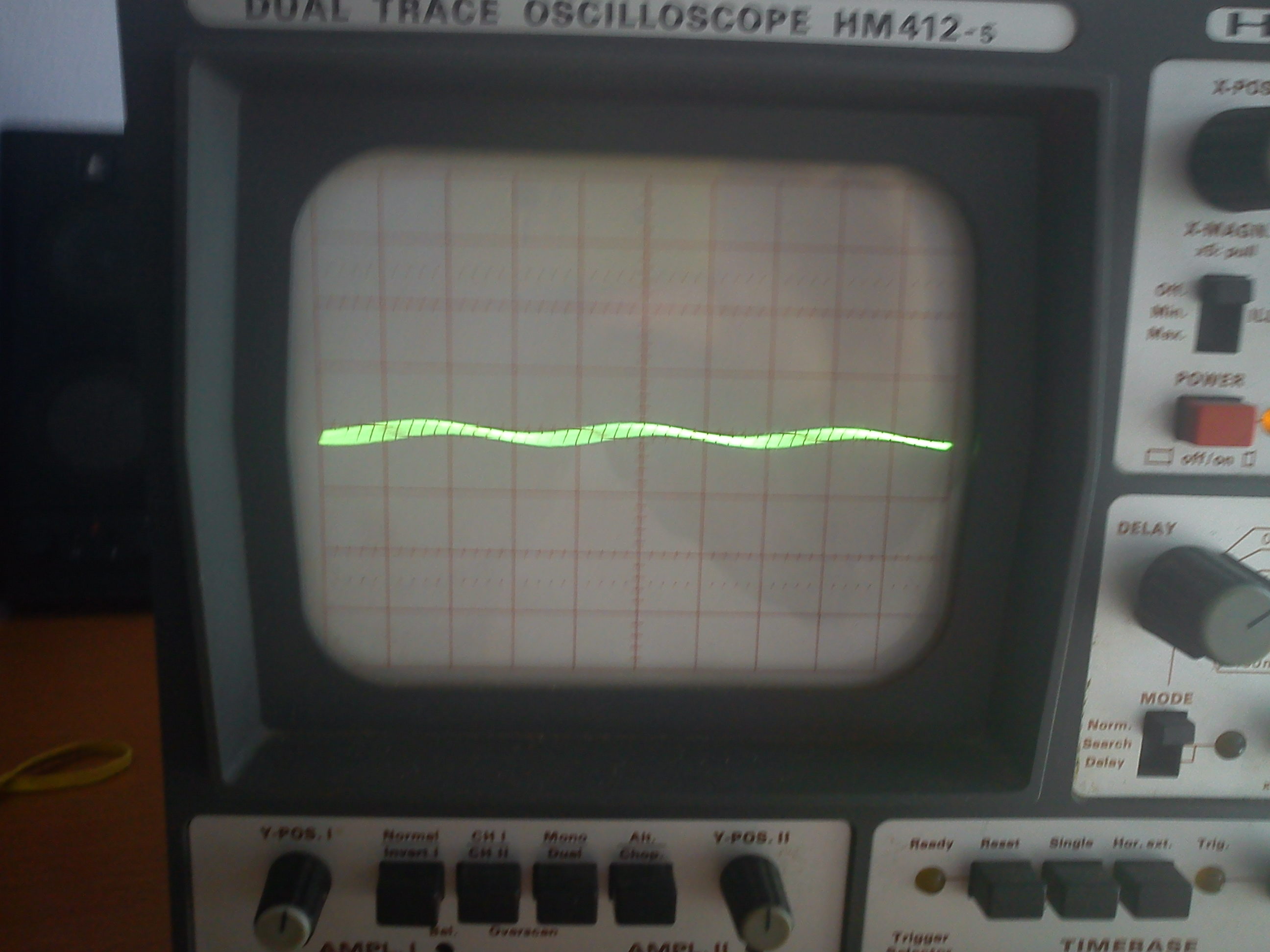

Hi!
Did you measure the frequency response?
As suggested above: Measure frequency response fully open and at lower volume steps.
Best regards
Thomas
still lacks mids ands lows.
Best regards
Thomas

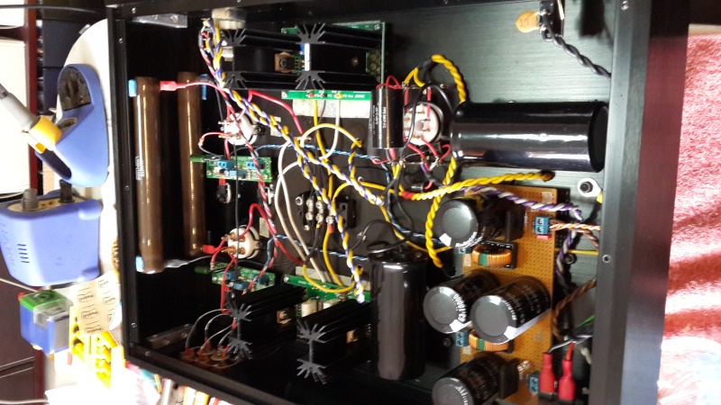

I have changed the 10R filament resistor from a Dale 50W WW to a pair of Ohmite Brown Devils 100W resistors. They are about 8-inches long a challenge to fit. However, the sonic improvements is well worth the effort.
img-2010 - Servimg.com - Free image hosting service
Good work, HMT!
You are using Filament Bias with your Coleman Regulators?
And these are the Brown Devils:
http://www.ohmite.com/cat/res_200.pdf
Are they the B20J10R?
The B20NJ10R would be an interesting comparison, with its Ayrton-Perry non-inductive construction.
Thanks for the report on the Resistors!
Hi, can you share where you bought them?
Btw nice project.
I bought them from RS Electronics. They are also available from Element14.
Appreciated, thanks.

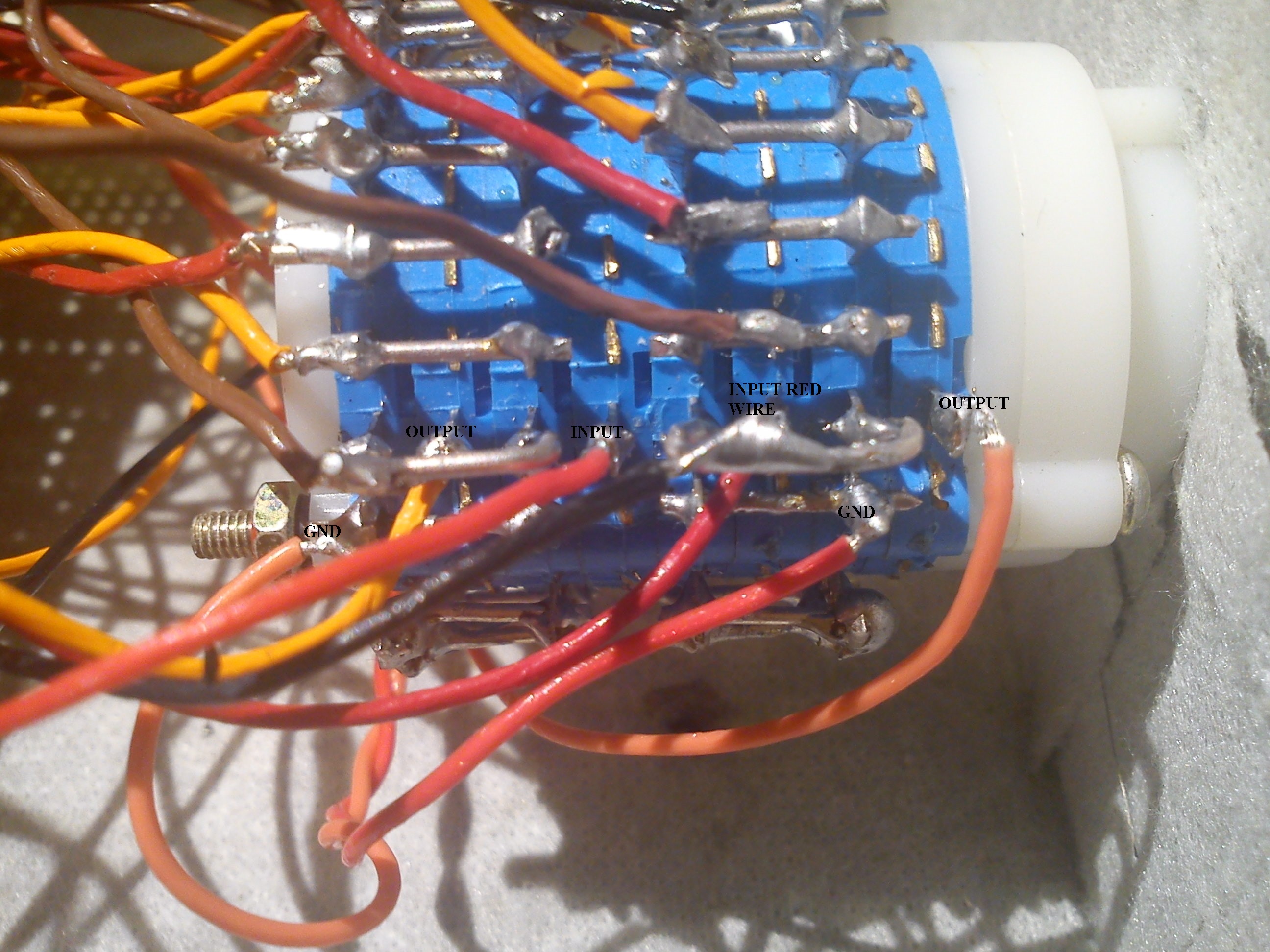

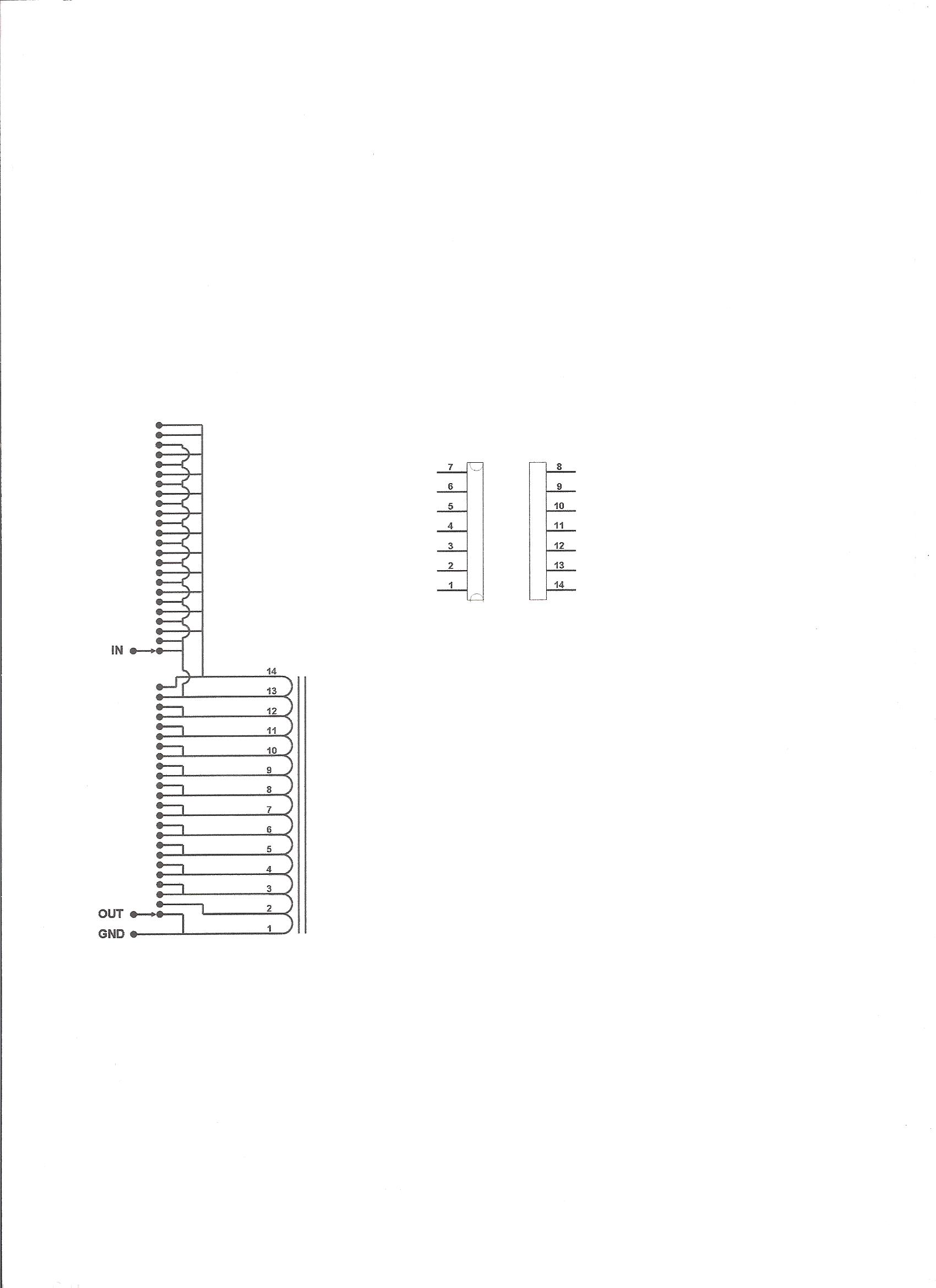

Hi Felipe,
I already stated two times how to proceed. I cannot help any further if you don't follow the suggestions.
1. Get the TVC to work first in the 4dB step set up. Test each setting. You apparently have bad connections. You need to fix these
2. Do frequency sweeps as suggested to get a clearer understanding of 'lack of mids and bass'
Best regards
Thomas
Best regards
Thomas
Hi!
So is the lack of mid/bass you mentioned gone or not? It is really hard to help with the little information you provide. I would not start to rewire the TVC until you are sure it sounds right and performs right. I did sent a detailed description how to wire for 2dB/steps. If you don't understand it please ask what exactly you don't understand.
Best regards
Thomas
Best regards
Thomas
