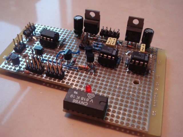

I kicked my lazy xxxx during the weekend and converted the naked half bridge to something like a class D amp.
Triangle, LM160 comparator, discrete level shifter, multiple shut down functions.
As always a breadboard not as sexy as most a proper PCBs , but Choco-handmade

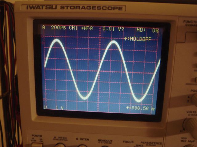

...a short look to the clipping behavior.
I am supplying all auxiliaries from my small flyback, so all supplies remain stable no matter how much clipping you drive. Nice to get blameless clipping bahvior. The capacitive couplings of my flyback are small (15pF), so easy fast floating for the high side supply is no issue.

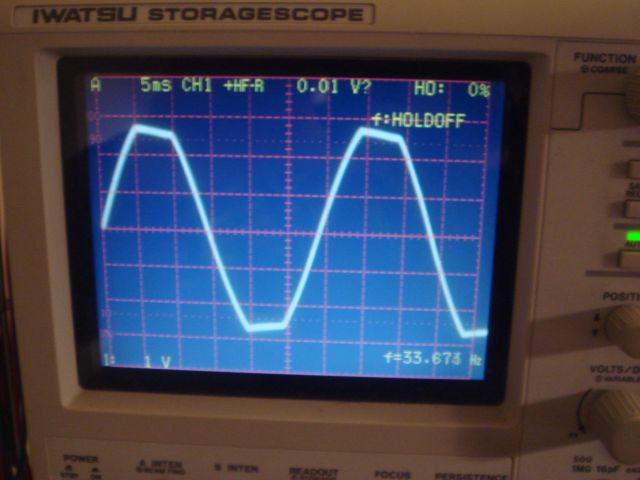

Here a screen shot in low frequency clipping with 2.5Ohms load.
Ok, Ok, for my first examinations I am using a weak power supply which is dropping from +/-50V down to +/-28V...
Please note I used a 1:10 probe, so we have 10V/grid.

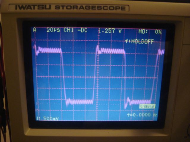

My output filter is 5uH, 3uF and a damper with 10uF/1.7 Ohms.
Feedback is splitted partially from halfbridge and partially behind the filter, this helps to optimize the transient response.

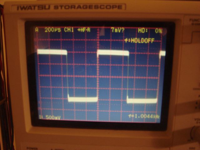

Here a screen shot of running a 1kHz rectangular signal into 2.5 Ohms load.
Probe 1:10 ==> 5V Grid

ChocoHolic:
Post like yours are what makes diyAudio such an incredible forum.
Discussing candidly your design merits and tradeoffs, providing full schematics, and a running project history....
Thanks for your efforts, and congratulations on a design which shows lots of promise....
Your square wave test shows a very well behaved circuit. Perhaps I would only use a faster timebase to better inspect the edges.

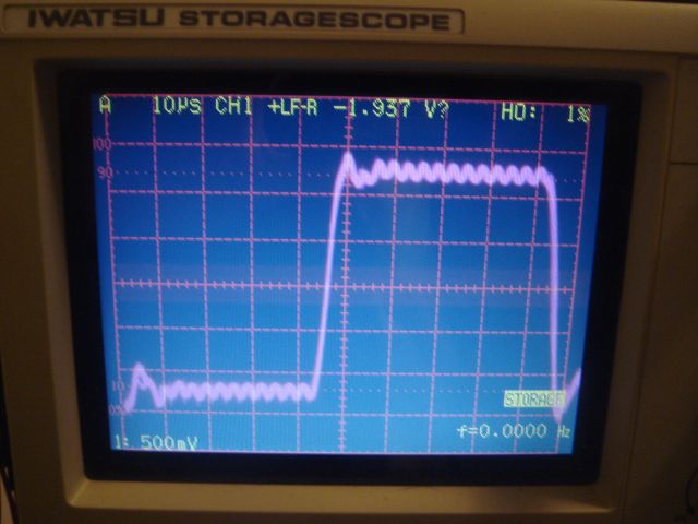

...ah well, of course I had a look with faster time base...
And of course also with higher frequency. Frankly speaking my previos post was more for 'marketing' and making people cuorios.
If you look at the next screen shot with 20us time base and a 10kHz / 24Vpp square wave, then it becomes obvious that these results are good, but not perfect.

I'm still very impressed with the squarewave performance.
I can't read the scope photo very well, but it seems that the amp's slew rate is ~ 24/5E-06 or roughly 4.8 volts per microsecond. Not bad, not bad at all!
Also the overshoot indicates minimal ringing, it settles within 2 or 3 switching cycles, very close to critical damping. NICE! You got it very close to optimal.
However if you have the time and are very perfectionist, you could try some snubbering at the output to dampen it further. Don't know if this would provide any sonic improvement, perhaps only in percussive sounds.
It is around 6V/us.
I can adjust the response speed and overshoot by the feedback network. See the 220pF cap....
Theoretically a more complex PID feedback should allow more improvements. But for first step this simple solution is not bad.
More details and optimizations to come, but probably not before Christmas. May be around New Year...
