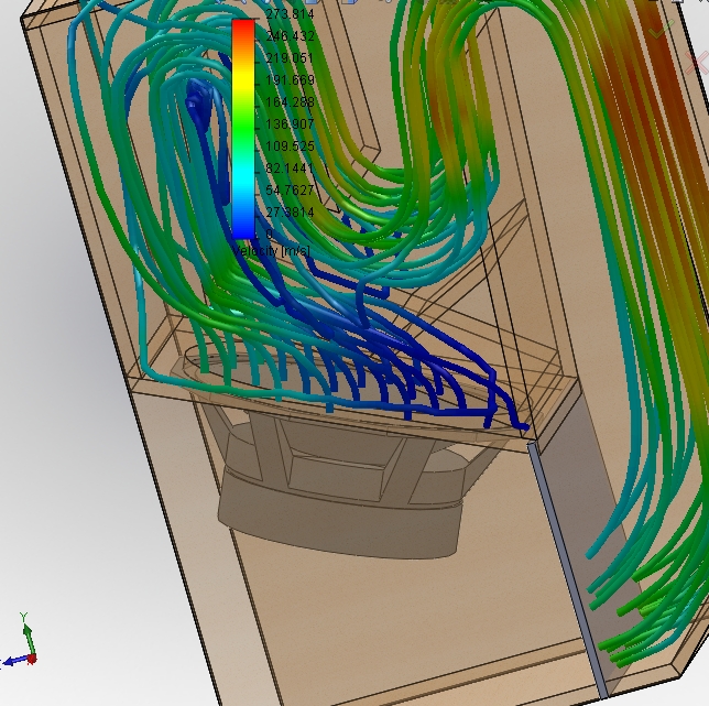

I think that the horn throat is critical to the design of high power TH speakers. Especially as highlighted by PASC in the TH18 thread.
As you mentioned ScreamerUSA has done some work on this.
I think that if a ramp is used in the horn throat then it should extend for the full length of the speaker, not stopping at the S2 point. To stop at S2 just makes me think that this point is being used just because it is easier to sim the change in Hornresp!
I am also beginning to wonder if the S2 compression ratio shown in Hornresp has any real validity. After all at the S2 point half of the speaker driver is past that point in the horn.
I am going to try to understand this area of TH design a bit better.
I am trying some flow analysis with my speaker models, and some good old fashioned thinking!
My current thoughts are to encourage a linear velocity in all parts of the throat.
Regards
Martin (Xoc1)
Regards
Martin (Xoc1)

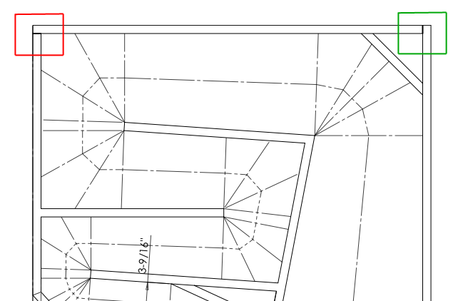

Baffle Cutout and Spacer
Hi All.
Firstly I would like to point out that I am unsure about the depth required for the driver spacer - if it requires more than 25mm clearance then please make the spacer depth adequate for the X-Mech of the driver!!!!
Cut out Dimensions (the thought process):eek:
I made the overall radius of the cut out, the equivalent of the SD of the 18TBX100 driver (1210 cm sq). The curves were them adjusted until the area of the cut out was half of the SD figure. This should mean that the average of the curved edge should be bang on the S2 point of the horn, and the compression ratio 2:1.
The spacer board is designed to be reasonably simple to setout and cut.
The overall dimension is to fit the smallest dimension of the baffle board.
The orientation of the speaker mount holes in the baffle is important, if you want any chance of fitting theT nuts;)
Regards Martin

Hi Martin,
That looks like quiet some work :up: very nice indeed!
I suggest using a brace since the pressure around the 'wave' will be high (or maybe even a double panel like you can see in the B52 picture of Djk). Rounding the edge wouldn't harm also ;-)
