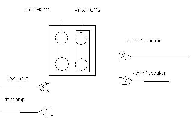

OK. Hate to break into this esoteric discussion revert to more mundane things. But I have a practical issue for which I need a little guidance.
I've previously mentioned adding one of the Allen Presence Presenter speakers to each of the HC12 speakers. The PP speakers include a Peerless 4 inch mid-range driver (same one used in the HC12s) and a dome tweeter that I think was made my Klipsch (sp?). The PP has it's own crossover on the board. My plan was to spread these out within the pipe chamber to make-up for the fact that the HC12s are rather close together. I'll determine whether this is needed after I get the HC12s running and tested with the bass boxes.
But looking ahead, I'm trying to get a sense of the wiring needs if I do use the PP boxes.
All the Allen speakers have a screw type wiring block. Two wires from the crossover go to two of the four screws on the block. The other two screws are for the line from the amp. I'm guessing that the speakers are a nominal 8 ohms. But I'm not certain of that. Can I just use a meter to measure the resistance at the terminals to determine this?
Assuming the PP and the HC12s are both 8 ohms, than a parallel connection would create a 16 ohm circuit for these speakers. That doesn't sound like the optimum situation for the Crown XLS1000 amps. I think they'll do better at 8 or 4 ohms - even 2. Crown doesn't list a 16 ohms watt rating.
I've already made the cables to go between the amps and the speakers. But I'm imagining myself at the wiring block of an HC12. I have two screw terminals for the forked spade lugs from the amp. I ALSO have two forked spade lugs that go to the PP speaker.
Here's one of my deluxe MS Paint drawings to illustrate.
I'll need another terminal on the wiring block. Won't I?
BO
