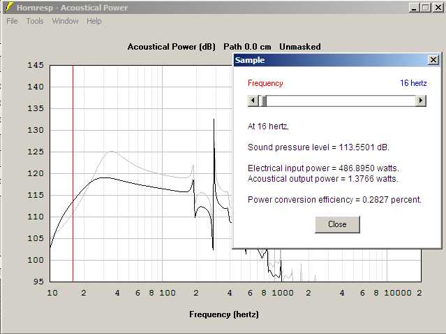

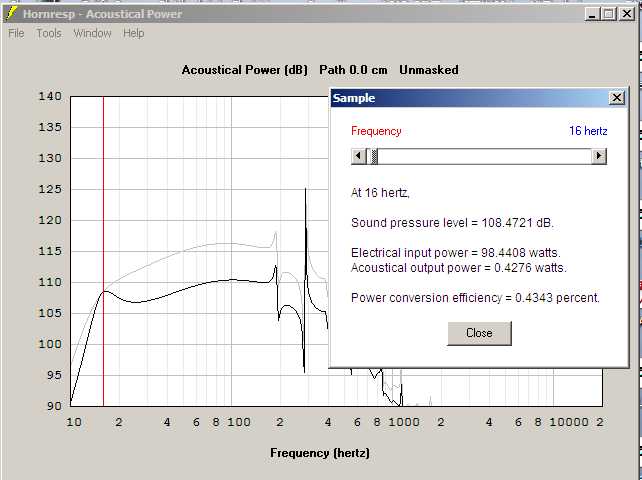

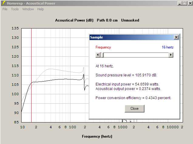

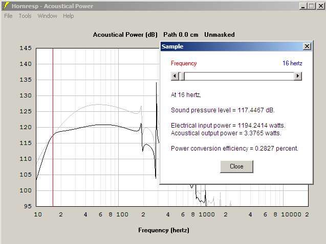

Hi Bach On,
Post #1071: "...put the PP boxes around the pipe chamber AND changed the circuit from 8 to 4 ohms..."
The circuit impedance will only change in in range that is not affected by the series capacitor inside the PP boxes. So it will not have much influence on the loading of the amplifier, as the power consumption in that upper range is much smaller to begin with.
Post #1071: "...The bass from the Dayton box is barely adequate. I wonder if changing out the two Dayton drivers for two HT18s would have improved this?..."
The box is too small for dual SI HT18 drivers. So is the triangular corner box. I'll attach four Hornresp SPL windows, 2 w/ a modified JAG tweak (using only Rg=2Ohm) and 2 w/o tweak.
From the SPL charts the single 385 w/ tweak has the flattest response; the single 385 w/o tweak has a response peak @ 16Hz. Both of these single 385 versions should work for you. Given the unknown nature of the chamber/auditorium response I might try removing one of the 385s, and closing the hole. It should give an overall flatter response. With the bigger and longer port at least now the box tuning looks correct, but you will loose the 6dB gain in the middle and upper bass that comes from the second woofer.
If you leave things as they are you need to add boost @ the very low end, and reduce the rest to match. That should work too. Just use the SPL charts a a rough guide.
The SI HT18 would work as a single, and provide higher output capability, but again EQ is needed.
You are on the right track, and it looks from here as if things are coming together. I wish there was an easy way to mix some of that low end into the HC12 sound mix (I think bentoronto suggested a mixer at one point). There is an lot of underutilized diaphragm area in those boxes.
Also, remember that those charts are 2xPi simulations, and the room will dominate the low end.
