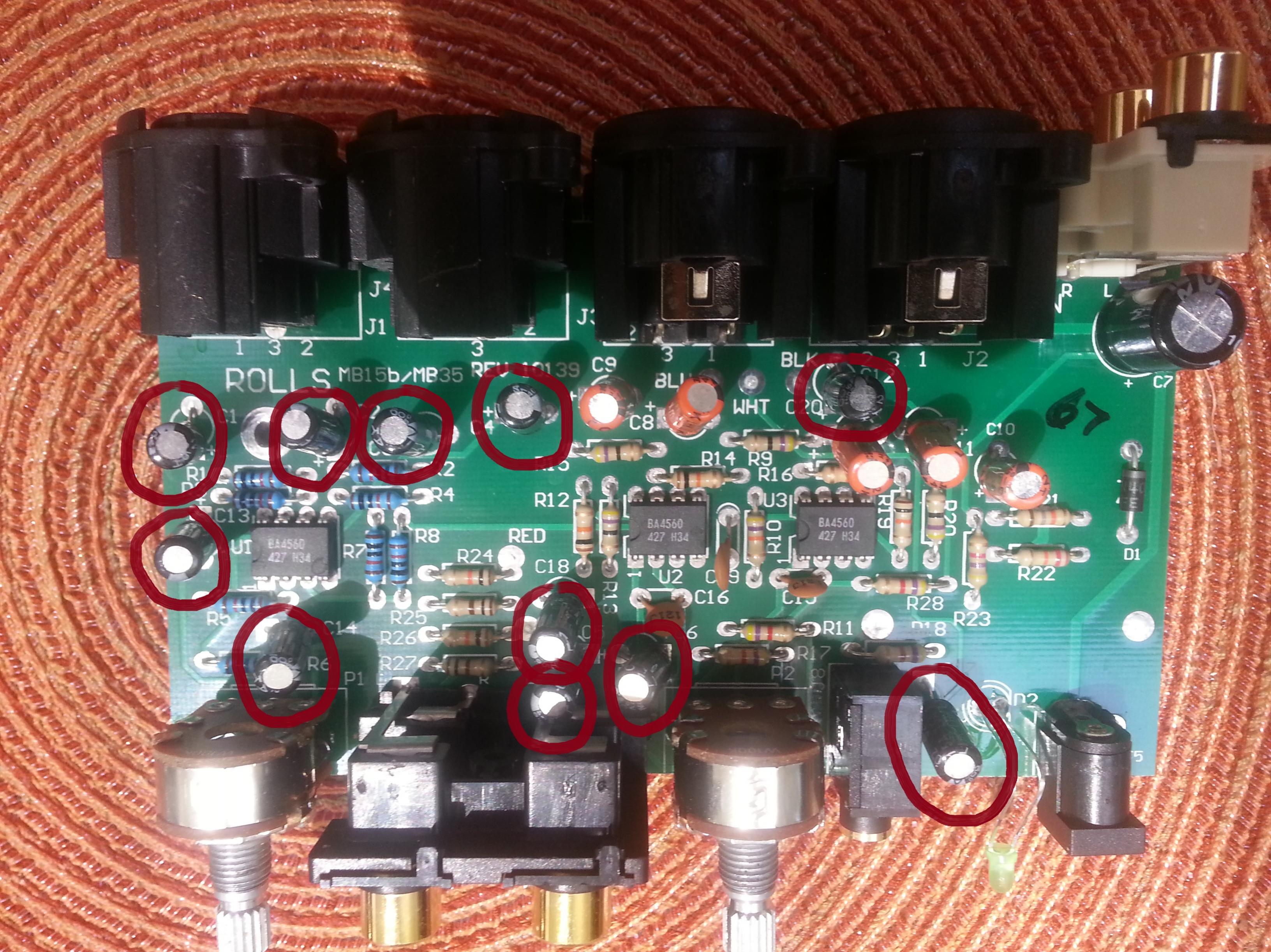

Here's some pics of the naked Rolls circuit board. I circled the 10 caps I'm planning on changing out.
I just noticed I have 11 caps circled. I'll have to double check those.

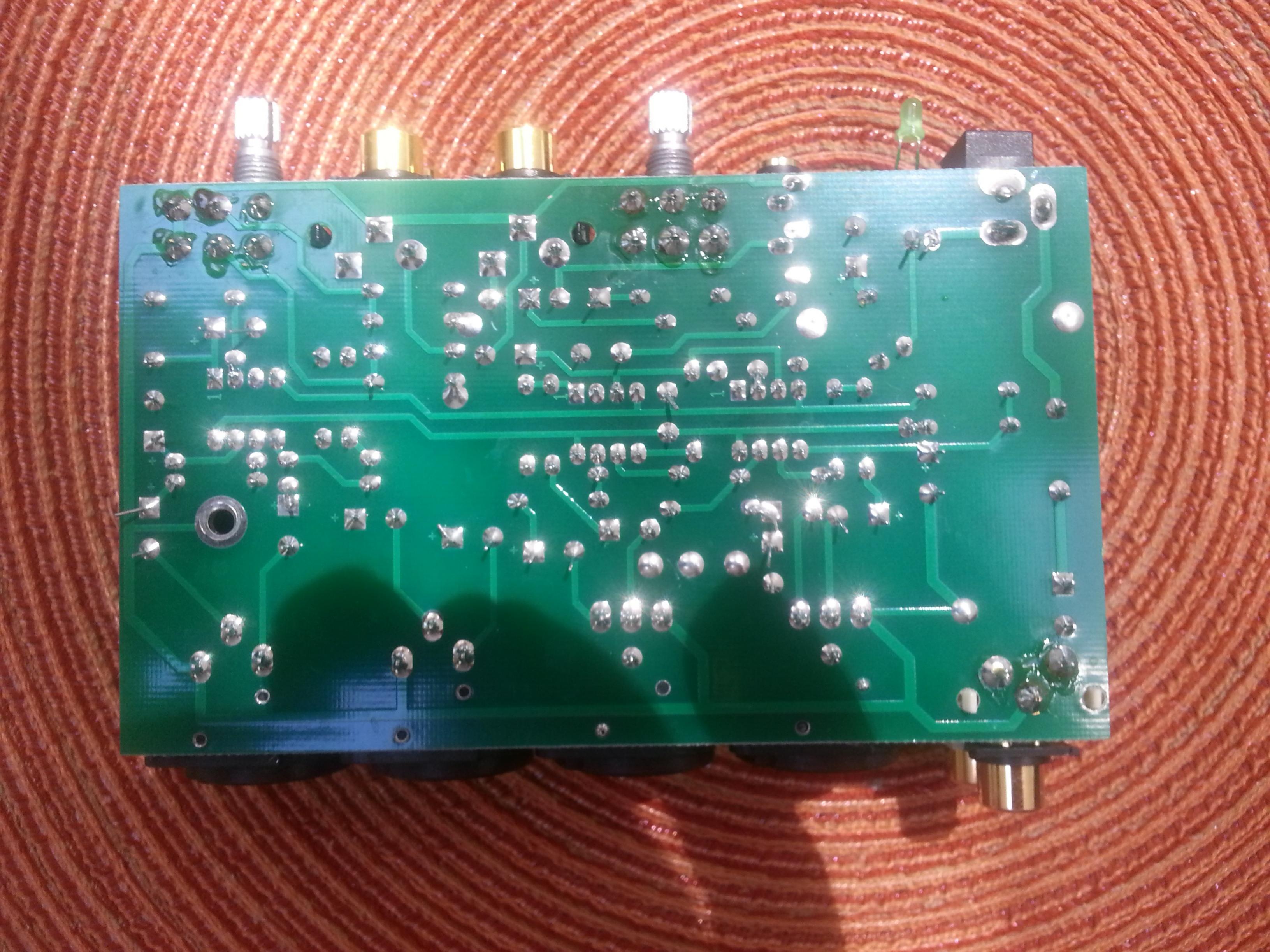

Here's the back side of the board. Looks pretty well done.

Thanks for the pictures of the Rolls board. Looks like everything is clearly labled through-hole circuitry, so the surgery should not be too hard.

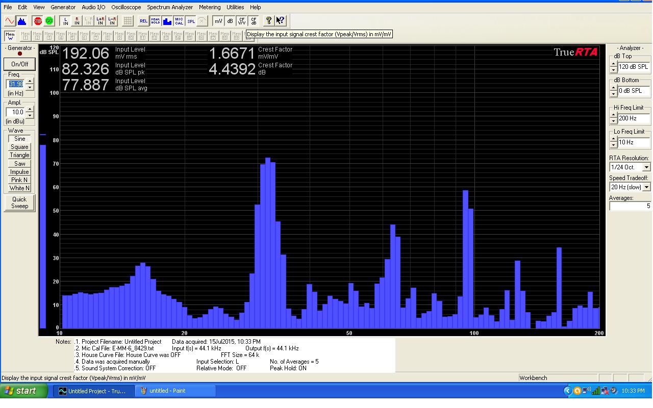

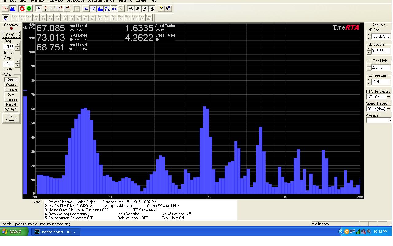

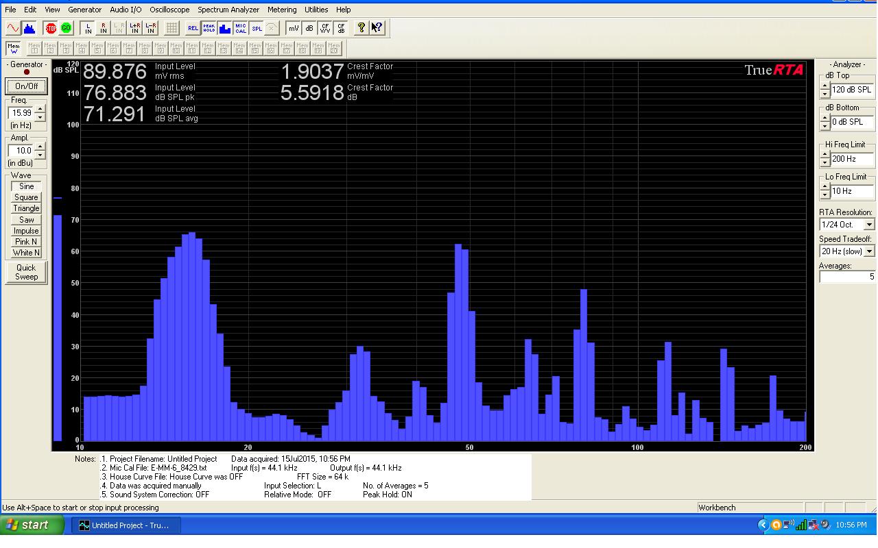

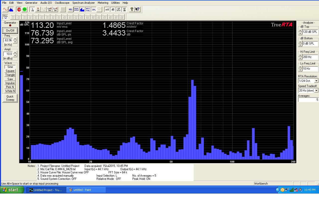

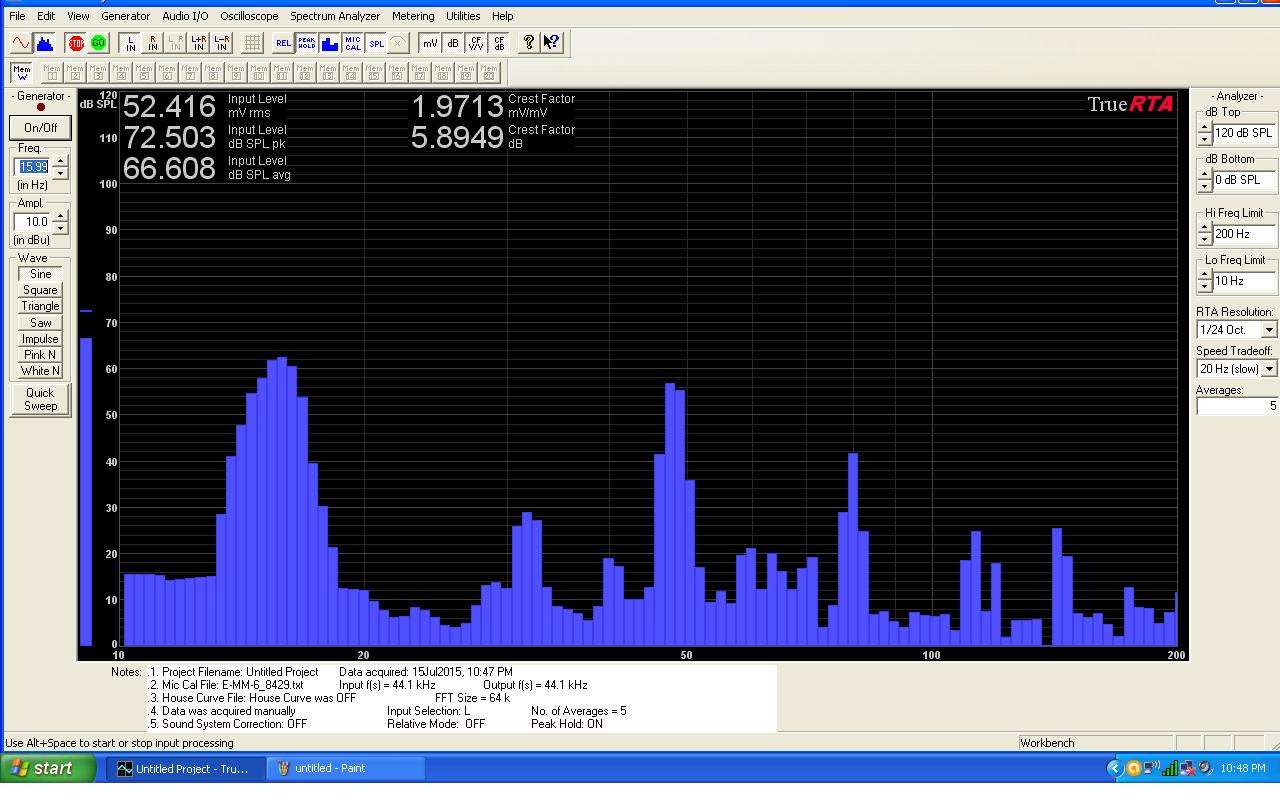

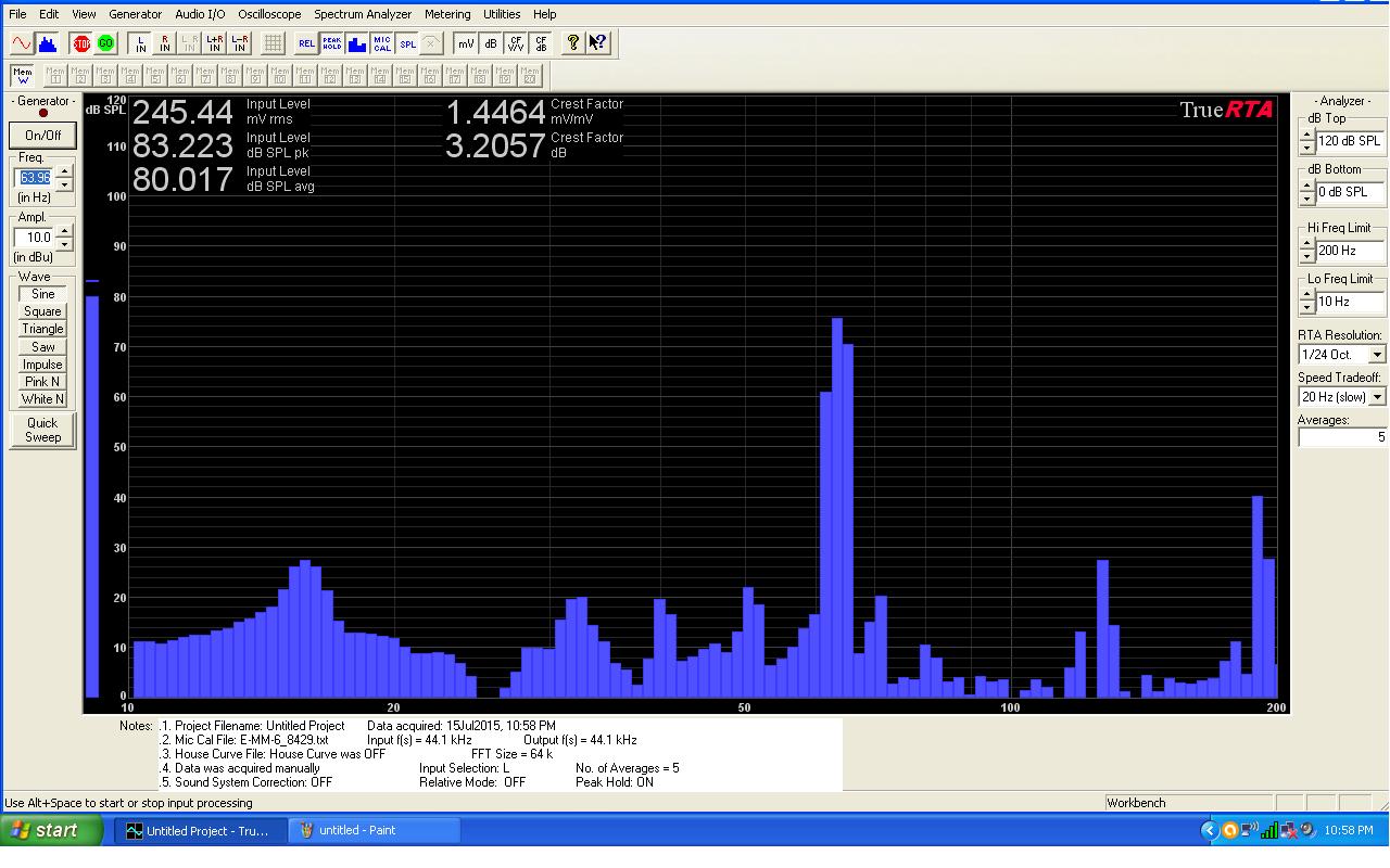

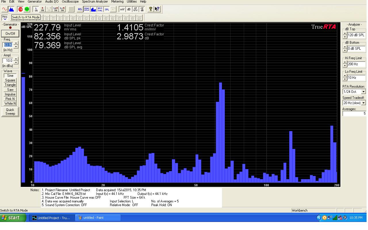

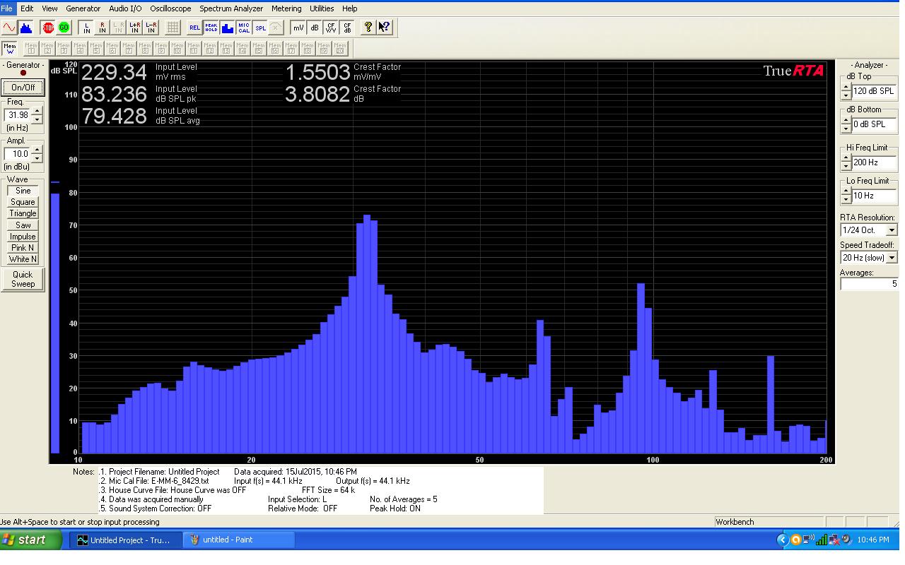

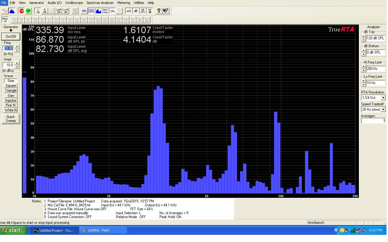

Just finished some new measurements in the Sanctuary of the two bass boxes.
First, for the REW fans. I did measurements on the box with the two Dayton drivers.
I just tried to upload it but the forum software says it is an invalid file type.
Here are the measurements in TrueRTA. Mike about 8 feet from front of speaker.
16 Hz.
32 Hz
64 Hz
More in next post.

There is still way too much odd-order distortion in that RTA @16 Hz..
+1 to Brian's comments esp. regarding odd-order.
Subjectively, how loud are you playing them? How much louder or softer during actual organ playing?
Great to see the initial data. But nothing definitive until you look at the input to the speakers, or at least the input to the amp(s) that feed the speakers. Just takes an audio cable looping back to where the mic-system plugs in or the audio input to your computer. Simple as that.
A good way to post the REW files is as jpg images. Just click on the pictograph outside the top-left corner ("Capture") which is there to take a snap-shot of the the graph; then name and save the file.
With your test set-up, a more diagnostic set is more like 16, 28, 50 Hz.

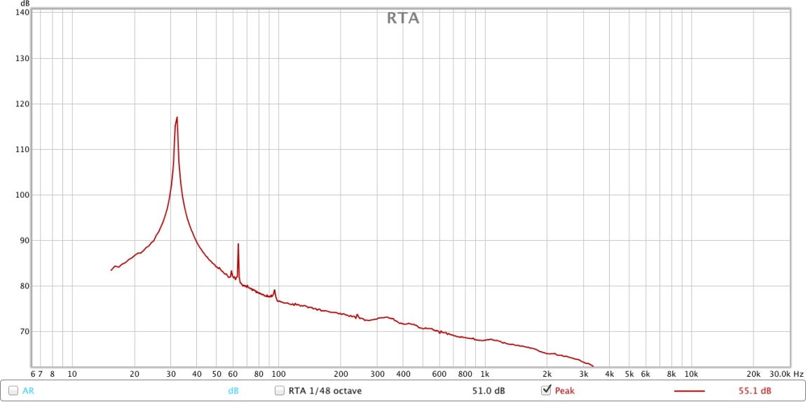

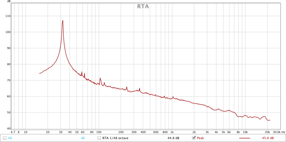

For comparison purposes, I ran 32 Hz RTA curves to show distortion in my 1955 1.4 cu foot AR-1 with the 1965 tired-out amp. The first curve is somewhat loud and the second curve is about as loud as 32 Hz ever plays in my modest-sized music room. dB marks are all relative.
16 Hz traces are kind of pushing it for this small box, but not too much worse than the 32 Hz results, with no harmonic closer than -20 dB to the note.
I'd expect that once the bugs are ironed out, Bach On's system oughtn't look too much different.
Ben
