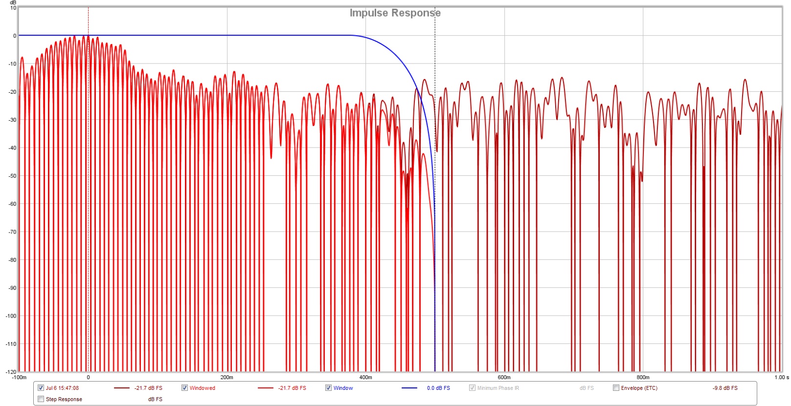

About that trace Mark posted with the flat 20-25kHz response. Either it is the world's greatest woofer ever made or could it be the mic calibration curve? What are we looking at?

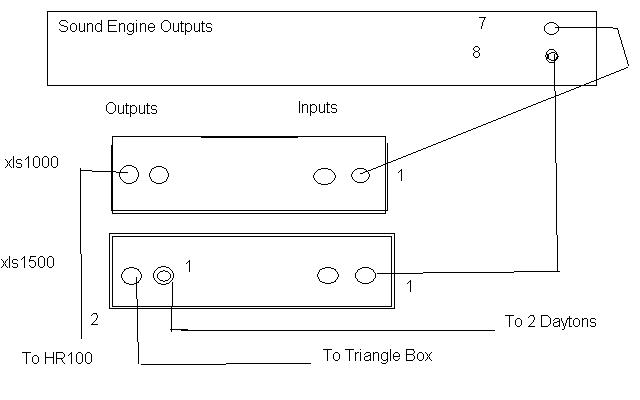

This is for Ben and whomever. Some more of more terrific MS Paint art.

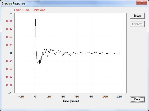

Nope the ribbon is yours.
The mistake was software related.
You used the latest version of REW. I opened the file in an older version. From there the trouble began.
You did do a very realistic measurement of your system.
It is working very well.
The only work I would suggest is to ask REW to do an impedance curve. Wideband. We can then verify your port tuning.
That may make you more work.
You can get a db or so better results with getting the tuning right. But to make you feel better, you have already stated seeing diminished cone travel at 16 Hertz. So I think you are pretty close.

Is that the final signal path?

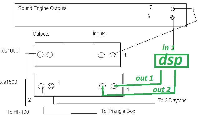

This is how mine would look, just for funsies.
Ben,
You're missing one thing. I limitation of the XLS1000, XLS1500, etc. is that when either Lowpass or Highpass is used, input channel 2 goes offline. (I did not know this when I bought them.) So anything plugged into input channel 2 on the XLS models we have is ignored. The newer XLS models no longer suffer from that problem. But we don't have the newer models.
Your drawing has a one of the outputs from the Rolls going to Input 2 on the XLS1500. That would accomplish nothing because that input goes offline in Crossover mode. If the Rolls preamp is used, it will only be used for the cable from Output 8 of the Sound Engine and Input 1 of the XLS1500. The amp goes into a modified Bridge mode so that both Outputs only carry the amplified signal from Input 1. But both volume controls work independently on the two outputs. Both of our low bass speakers will be driven by this amp.
So the idea of adding some equalization circuit in the input to the XLS1500 amp means that a signal tailored for the SI HT18 might help that box. But it would also effect the twin Dayton Box - and it might or might not be better.
The only workaround for this is to buy another XLS amp for the box with the two Dayton Drivers. And I just don't have the budget for that..
I know that is confusing. It doesn't work like it should. But I'm certain of my facts. The instructions in the manual are confusing and were modified to make them a little more clear. I've confirmed these facts with the vendor - who confirmed it with Crown. Customers bought the same ones we have and complained about this limitation. So Crown changed the design in the newest models by adding another DSP chip to process both Inputs independently like it should have done all along. The price on the old models is now about $50 less than the new ones. I bought four XLS1000s in May for $299 each. They now cost $249 each. And no equitable trade-in is offered. I'd take a beating selling the old amps and buying the new ones.

* The confusing limitation I've just been describing is not a factor when the Crossover circuitry of the older XLS models is by-passed. I don't need the crossover circuits for sound engine outputs for the manuals. The Allen HC12s have a built-in 3 way crossover system. So the three XLS1000 amps that power these speakers work fine in typical stereo mode. If I by-passed the crossover on the xls1500, I could do the circuit like you drew it. But I'd need a crossover for each of the bass signals.

What I would do is make a high pass filter. Cut all the stuff higher than the signal that we want to boost. Then we can use the gain of the Rolls unit to level everything off.
Sure thing. Of course you will need to take account of whatever LPF Bach On selects in the calcs etc. Otherwise !

If Mark designs that boost & filter to include a 18-24Db Oct HP & with a LP @ your noted 96Hz, you will be able to use Both channels independently, as the above circuit will just feed the SI HT18 driver

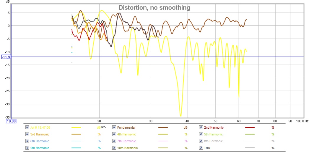

Mark,But what I have seen is that the SPL level of the harmonic can be influenced by the distance of the reflection points if there are correlations between the harmonic wavelength and the distance away from a reflective surface.
Here is a simple example. Put a cabinet under test 8 feet away from a reflective surface. Play a 32 hertz tone and look at the height of the harmonic at 64 hertz. That would be the first harmonic right? 8 feet is also roughly the half wavelength of the first harmonic. When these things line up they can influence the measurement outcome.
Your example is correct, but the 64 Hz harmonic of 32 Hz is called the Second harmonic. All even order harmonics are octaves of the fundamental, and thus are always musical, while the odd order harmonics (96 Hz, 160 Hz etc.) can/will/may change the sound of the musical composition.

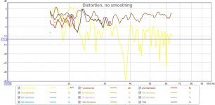

I have seen similar results on another site that I trust. It is an inexpensive driver with a lot of throw. You can't have everything.
But it will indeed sound impressive.
Thanks for distortion trace but oddly high and messy. 10% (which is 20 dB below the full output) wouldn't be unexpected for this system, short of over-load. But seeing so much in the chart more raises questions about the test method or perhaps the speaker drive signal.
Easiest on the eye and brain to stick with 1/12 smoothing (the "Goldilocks" level) for all displays. Likewise, meaningful to see THD, 2nd, 3rd, and maybe 4th can still be seen clearly; anything more too hard to handle.
Honestly, time to see if the input signal to the final amp is clean and flat. All you do is turn off the Crown and then connect the input cable to whatever your mic (or mic box) is connected to. That's it.
