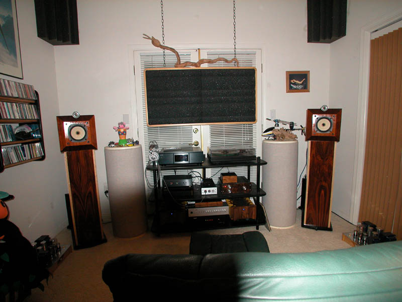

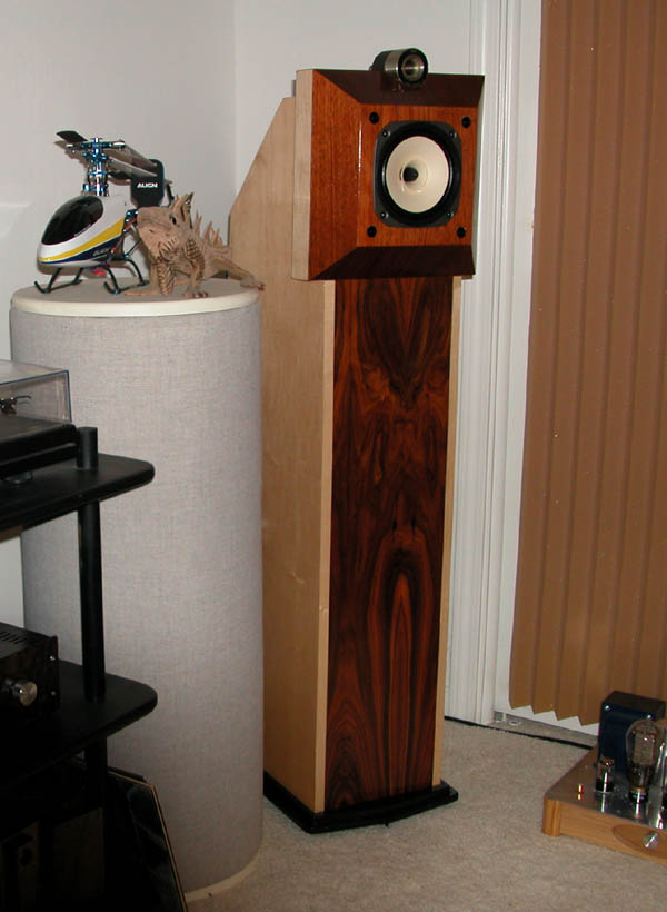

I finally finished these up, I have to admit the construction was a little more difficult than I anticipated. On top of it I had a friend help me cut the panels on his table saw and I either miss communicated or he misunderstood and I ended up with the with the sides being 1" wider than plan. I did not realize it until I had glued them up less one side. In order to bring the interior back I had to cut pieces to fit inside the baffles. In any case I ended up with a well dampened box (and quite heavy). To make the rounded curves I purchased some adhesive backed linoleum and filled the voids with sand. They do sound quite amazing throwing out quite a good sound stage with a remarkable amount of bass. They are now on the Pass F4 but I also have a pair of 300b set amps. I prefer the set amps they are less dampened and they are a better all around match but the hum was driving me nuts. I will be converting them to DC filaments and my tube pre is giving me fits with oscillation ( the joy of DIY).
Bill

Thanks Ron,
Chris that was my plan, but truthfully the set amps have plenty of power by themselves (will try it anyway). The room is quite small (and square) hence the the bass traps to breakup standing waves. Oddly it was Nelson Pass that recommended the FE166 as a sanely priced full range driver. His current pet preamp is the B1, but he plans on a B4 with Eq network for full range drivers. I am not sure if it will based on base reflex cabinets and how it will interact with the BLH , it will reasonable inexpensive so what the heck. At the pace I have been trouble shooting my tube preamp I could build it and be enjoying the music in the mean time.
Bill

The horn is a Fostek T90 crossed with a single Fostek copper cap (not sure of value and sealed inside). The jury is out on it and I should probably disconect and get used to with out it and reconect it. I have been moving amps around so critical asessment has been thrown out the window. I had the sets on the workbench and resoldered a bunch of joints and fideled with the star ground and improved the hum from 15 mv to under 5mv. Then my XBOZ preamp decided it didn't like driving them, since they have built in volume controlers I may drive them from the source directly (need longer cables).I have a sub system with a Reckhorn AMP / Equilizer but want to get the rest stabalized befor integrating it. I am always at odds with my ear calibration, I never realy trust them. I am looking into Siegfried Linkwitz's toneburst sytem of measurement. I would like next to build a set of his Pluto speakers triamped with some alephs I have laying around and a Jan Diddon style modified Beringer DCX2496 speaker management system.
Bill

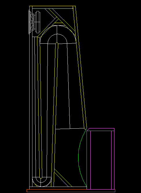

Greetings from Shenzhen... Took a bit of a hiatus to focus on building my F120A speakers in prep for BAF'08, and then work got pretty busy again. Now it turns out, I'm on one of those business trips where there isn't a lot to do, so I'm plugging away on the A166 plans again.
Referring back to Ron's comments about the history of the pdf plans, I took some measurements of what I've got in CAD right now... mostly looking at the horn expansion to see if I got the corners right. Have a look at the attached photo. For the corners, I used the centerline arc length to calculate the expansion rate (maybe centerline is not the right length to use for this, but it's a start), and came up with the following. This is the expansion rate measured from the curves, in terms of width increase per unit length:
1st section: 0.017
1st bend: 0.117
2nd section: 0.047
2nd bend (the big one): 0.082
3rd section: 0.124
I didn't bother to calculate expansion at the horn mouth due to the difficulty of measuring it on the plans.
So two questions arise:
1) the 1st bend at the bottom seems to expand quite a bit more than the preceding and following straight sections. Maybe it doesn't matter due to the short length of the bend, but does it seem correct? The dimensions for this bend are quite accurate, as shown in the pdf plans.
2) The first angle in the large bend does not really follow the circular curve very well, cutting into the arc quite a bit. This creates extra room for the compression chamber, badly needed with the 166ES-R's huge magnet, but will it affect the horn performance?
I've been thinking about the magnet size problem, too - it's really a giant pancake that's going to be quite restrictive in terms of airflow between the cone and compression chamber, so I'm a bit concerned about that. Anyway, I'd like to focus on getting the horn taper right first, and maybe I can adjust the suprabaffle and / or CC dimensions to better accommodate the big magnet after.

Here's a pdf of my reconstruction as it is now, with dimensions shown on the first two pages. For the most part, I've tried to keep it as consistent as possible with the dimensions on pages 3 and 4 of the available pdf plan, with a few dimensions lifted from page 6. But there are some inconsistencies - a number of dimensions didn't come out the same, or didn't reconcile once I drew it up. So I've had to prioritize what I would guess are the more important dimensions, and make a few small trade-offs here and there.
Please take a look, and if you see something which looks to be in error, please let me know so I can adjust the design.
I will probably work on the compression chamber area of the design some more, in order to better accommodate the giant 166ES-R magnet. I will keep the overall volume the same, but hopefully improve clearance for airflow around the magnet. I will add provision to increase or decrease the chamber volume easily by bolting in extra pieces of plywood at the back of the CC (it is already double-thickness). The top 'lid' will be removable for easy access to the driver, CC, and a small compartment for binding posts, supertweeter crossover, or rear-facing tweeter, etc.
I haven't decided quite how I'm going to integrate the suprabaffle yet - I would like it to be removable / separate piece for experimenting, but also for cosmetic reasons - I want the option to finish the SB with a different veneer from the main body of the speaker. Pages 4 and 5 of the pdf show two different SB options that I've drawn up so far, along with the 166ES-R driver, accurately drawn from measurements of the real thing.
