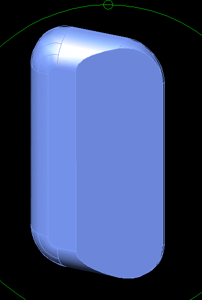

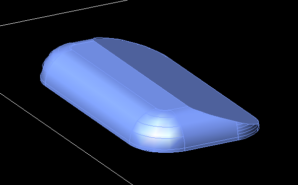

Another update...
Just wanted to show you guys what I've been playing with the past few days...
So I'm now working on a curved version of my own, optimized for the FE166ES-R. The main problem I've been faced with is the huge magnet blocking airflow into the CC. So I knew that a protruding baffle probably wouldn't work, since a straight-through hole would be completely choked off by the magnet, and a cone-shaped hole would end up too large to fit in the box dimensions. The driver pretty much needs to mount flush to a single-thickness front panel.
Two other objectives:
1) I want it to look good.
2) I'd like access into the CC for convenient stuffing adjustments etc.
So the other night I dreamt up how to accomplish the above and integrate a nice baffle into the design, which doesn't protrude forward. In keeping with the semi-layertoned construction, it makes judicious use of curves.
With a driver mounted flush to the front panel, the baffle needs to extend outward to the sides, and also upward past the usual top of the box. I decided to extend the top of the box up to the height where a 12.7" x 12.7" baffle would stop, and then add 'cheeks' on either side, to extend out to the correct width. The vertical extension uses a 2" radius round off, created with the layered CNC panels. The cheeks would be built up from laminated stacks of plywood, then shaped on a router & table saw. The largest roundover bit I could find is 1.5" radius, so that's the curve I used for the cheeks. A deep angled cut then tapers the back side of the cheeks in, forming a nice teardrop profile from above.
As a bonus, the cheeks can be made detachable, with access ports behind. These cutouts additionally provide some extra internal clearance around the sides of the ES-R's giant magnet.
I just finished modeling the cheeks in 3D... still need to finish working out the CC internals.
