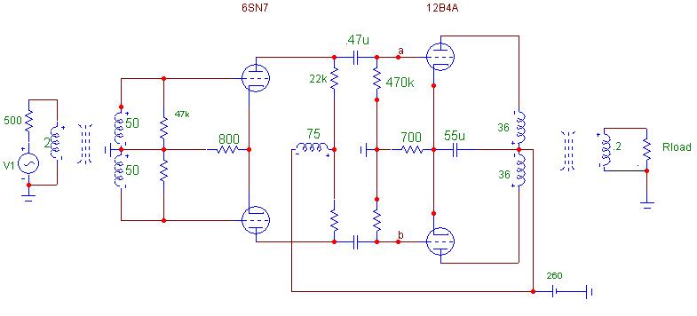

R vs L
Hi all,
Got around to replacing the 75H choke in the plate circuit with an exactly equivalent R and a 55uF oiler to the star ground. Same DC operating points as in the first analysis. Results of distortion analysis are in the graph below. You might have to look back around page one to compare. Soundwise, it was competent but nothing special was hitting me. May have been because I am in a bad mood from dealing with an ongoing computer problem. I also tried moving the cap to the cathode side of the 6SN7 resistor. Sort of plate to cathode feedback? That resulted in cutting 2nd and 3rd harmonics significantly, as in 30-50%. Noise was about the same as with the choke with a little more emphasis on the lower Hz. After I switched it back to the choke, the first CD struck me the same, but then a Cassandra Wilson CD just really stood out, kind of like what I have been feeling pretty much all the time for the last month. I'm not saying the lower distortion levels are the difference in the sound, but something seems to be doing it different.
Michael
diyAudio Senior Member
Joined 2002
Michael,
Replacing a choke with the equivalent series resistance of that choke does away with the property of the choke that's the most important here: it's very high AC impedance as seen by the plate.
Comparing both conditions is just the same as comparing apples to oranges.
Hold on...that's a PS choke you replaced, not a plate load choke.
The choke should make an audible difference, certainly a measureable one in your PP design.
Cheers, ;)
PS choke
Right, the choke is in a power supply position. Where as a series element it is neither a low impedance DC supply nor an easy AC path to ground. So why does it make the circuit sound so much clearer and livelier? And why does distortion go down ~10-12dB?
Stumped,
Michael
Joined 2002
The choke provides for some degree of regulation an it also has much better PSR than just a resistor.
All this means that your circuit proper is allowed to work more freely as it is fed from a much cleaner supply.
If you care to make some measurements on residual ripple on the supply line you'll notice that the choke supply is much cleaner.
Cheers,;)

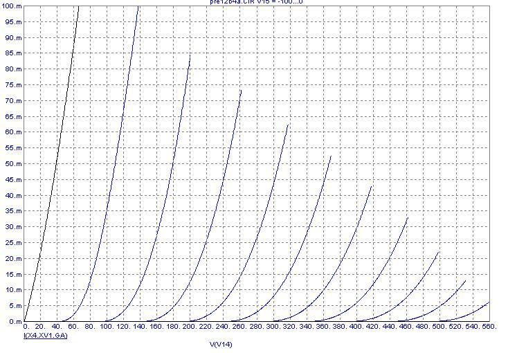

Hi Michael
I am actually experimenting with the following
setup.
Note that to have 22V rms at the grid of 12b4a
and 8 at the output I have changed the trafo
and now it is (5.76k:8). May be, the trafo was right
and I have some other differences (tube gain?).
If some value is different, please tell me.
ciao
Federico
schematic
Federico,
That looks very close. The DCR of the 75H choke is 2190 ohms. The DCR of the OPT primary sides are 189 and 209 ohms. According to the specifications for the amplifier I removed the OPT from, the impedance is 8.6k.
Did you get the curves for the 12B4 from Spice? Very nice in any case.
Michael
