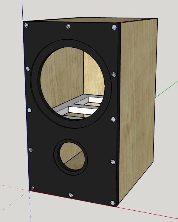

The cabinet is starting to take shape, at least in my mind anyway. Here is the latest take on the "ATC Monitor look". That new XO, btw, rocks hard. I am falling in love with the sound of these speakers all over again and listening to my collection. I can hear new details not heard before. The transient perfect aspect is wonderful for live ambient mic'd recordings.

Cool X! Do you have Visaton B80 to try out the XO? Lot of folks liked that driver in the blind tests.
I have the B80, but the bezel is totally different than the 10F. I have interchangeable baffles and can modify the spare baffle to fit the B80 and give it a shot at some point. Good suggestion though - the B80 and RS225 both have a black phase plug so visually similar.
Would something like a dayton cabinet work (for those of us still not too used to cabinet making)? :)
something like this: Dayton Audio TWC-0.75CH 0.75 cu. ft. 2-Way Curved Speaker Cabinet Cherry
Looks similar in dimensions to your sketchup drawing, 10" front baffle (narrower at the back), 14.5" deep, 17" tall. I guess volume will be a bit smaller than your design due to the curved design (around 21-22 L), how would this affect things?
Looks like a great design, would be fun to try once i clear my project backlog!
That is very close, and would be perfect if a few mm wider. According to the spec sheets, the RS225-8 bezel is 223 mm dia and the max width before the roundover starts is 218mm. You could probably do it if you did not mind the bezel protruding into the mild front roundover. The 21L vs 24L volume is less of an issue and you will lose a few Hz of bass extension, but should be ok. Don't forget another 1.2 liters for the Dagger rear chamber as well.

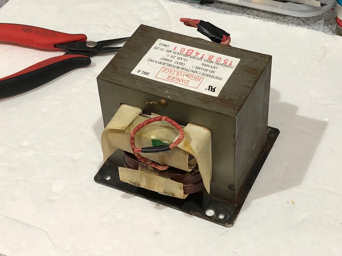

I was going to say same thing. Microwave ovens have the ultimate inductor. 100mH, 0.47R, 10amps. Many times are free curbside trash pickup. The oven breaks and people throw out the whole oven. The MOT is bullet proof and never breaks. I use to to double the power on my SE Class A amp for free (same rail voltage). The MOT stores energy and releases it back to the speaker, increasing voltage swing beyond what rails are.
Here is what I pulled out of a dead microwave:
It weighs 10lbs of steel and copper.
