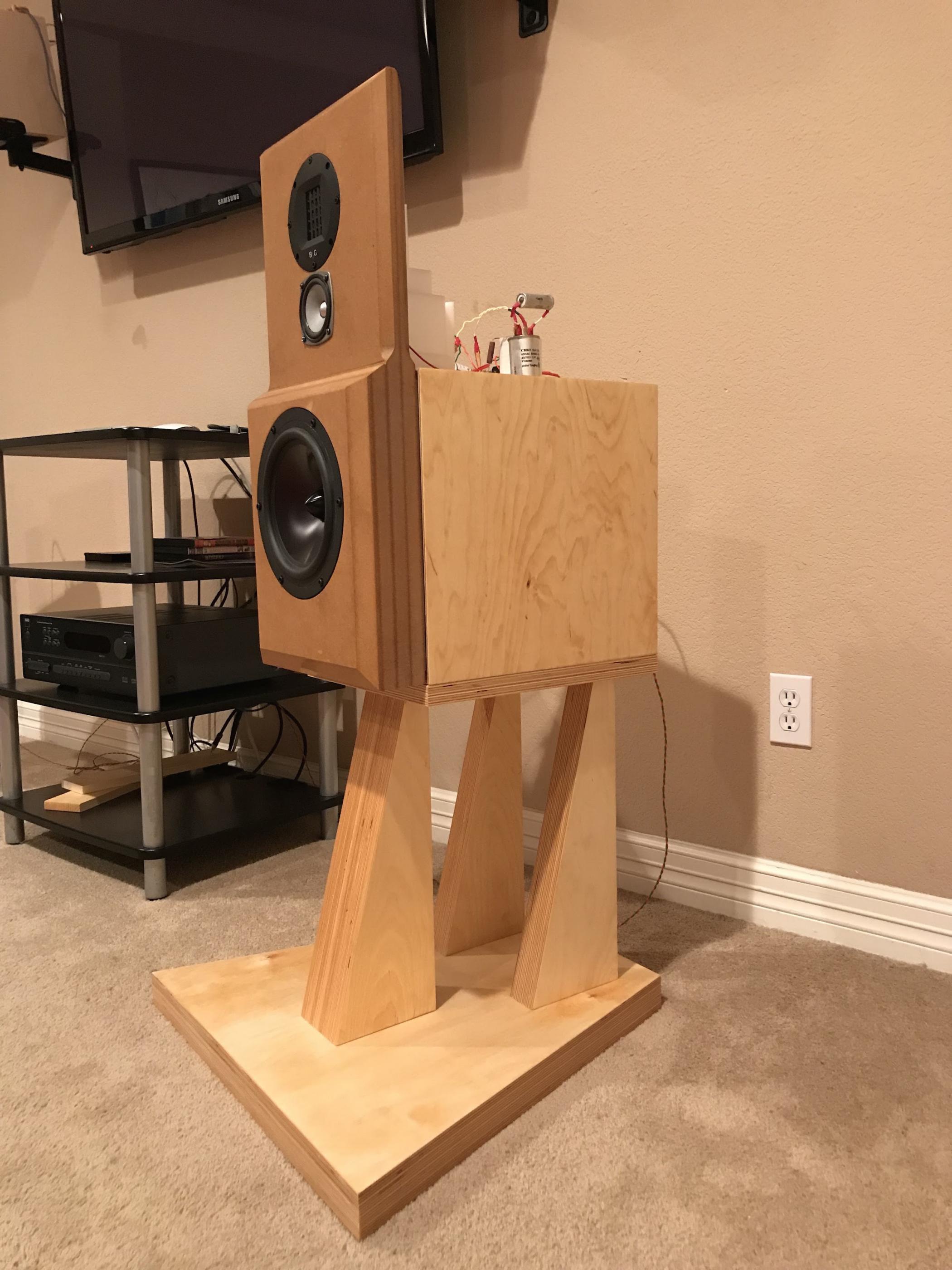

Yes, the crossover is 1st order on both, with a Zobel filter on 10F plus some padding. Here it is redrawn with values currently used in the above pictured XO. When used with the woofer on top and speaker on 30 in tall stand, the path difference from mid-tweet to the ear is delayed just enough to make it transient perfect.

Very similar to the crossover I'm using, inspired by this thread and your build.
Currently I'm not using the tweeter, I find myself missing just a tiny bit of hf. I'm also making new baffles, and about to upgrade a few of the crossover components as well.
It looks like the 10F/8424G has a bit more of a rising hf response, perhaps that would suit my ears better in two way configuration.

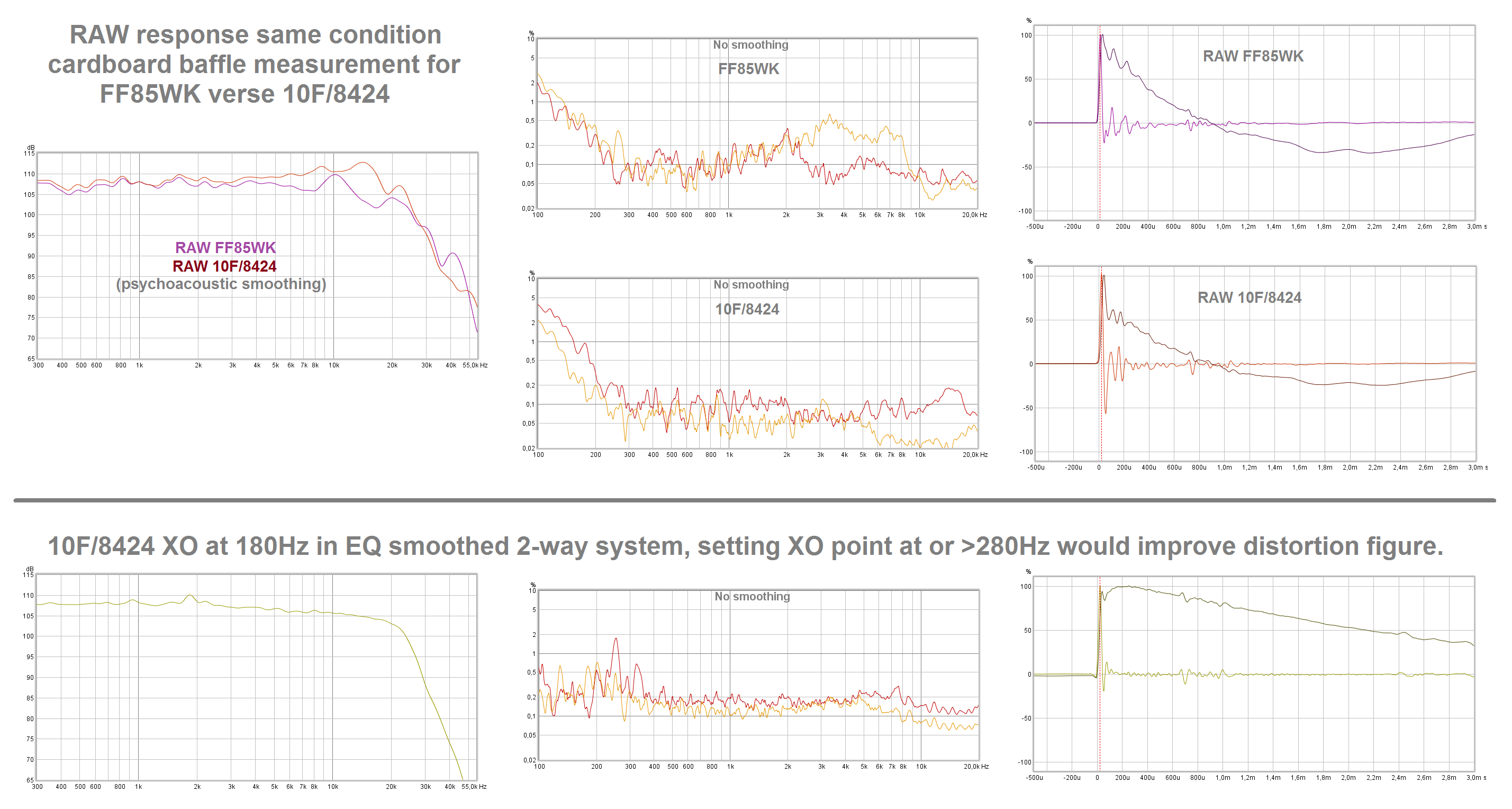

If it can help below have some same condition data for FF85WK verse 10F/8424, on distortion front in general it looks like drivers as FF85WK / SB65WBAC25-4 / TC9FD18-08 have a mostly forward 3rd harmonic dominant profile where 10F/8424 is close to be 2nd harmonic dominated.

Nice data plots there Byrtt. Was the data taken by the FF85WK from the ones I brought you when we met at Wesayso’s a little over a year ago now? What a fun night that was. :)
Great to know they are dominant 2nd order distortion drivers. So that means that there is an asymmetry in the suspension restoring force. Neat.

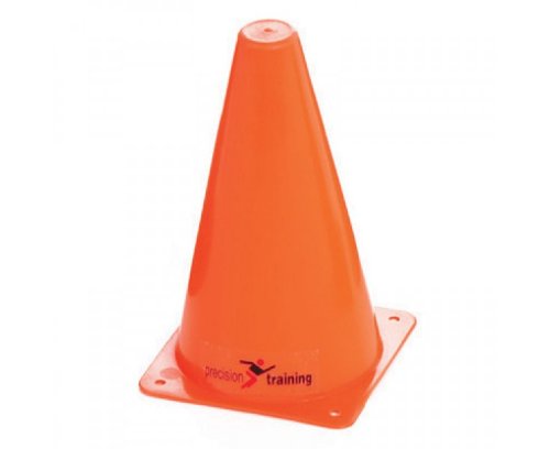

Trick is the mouth needs to be big enough to fit the driver cutout and basket/magnet. I agree that the semi-rigid vinyl is an ideal sound dampening material.
Oh o.k. I've looking at megaphones. I'll put some of those Amazon ones in my cart. Quick,easy and cheap way to swap drivers. If they don't work I could always work on my agility which I'm sure my wife would find hilarious.

Yes thanks those FF85WK curves are what you kindly brought me at that pleasant meeting :).
The higher costs for 10F is general not to like but in directly comparison test under same condition it have areas where it stand out and distortion profile looks be one of them.
I bought these ones: PRECISION TRAINING 9" Traffic Cones (Set of 4): Amazon.co.uk: Sports & Outdoors
The mouth area is plenty big enough for a 3-4” driver, and the four fixing holes make for easy mounting. I filled one with water to find the 1.1L volume.
I applied some adhesive 5m closed cell foam to the front face before mounting. That made an air seal on the inside of the cabinet.
I applied adhesive foam and loose wool to the insides. I used a very sophisticated scientific method to confirm the damping properties: held them over my ears to hear how well they worked as ear defenders :D
