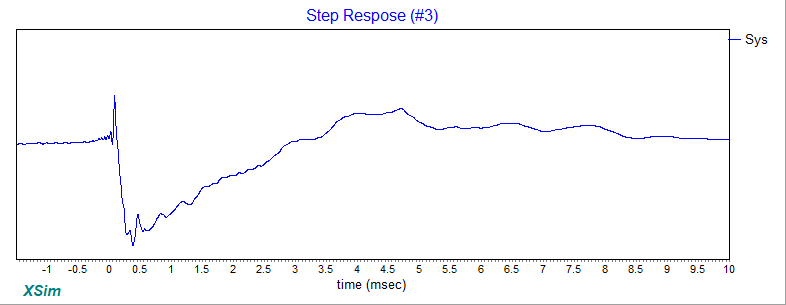

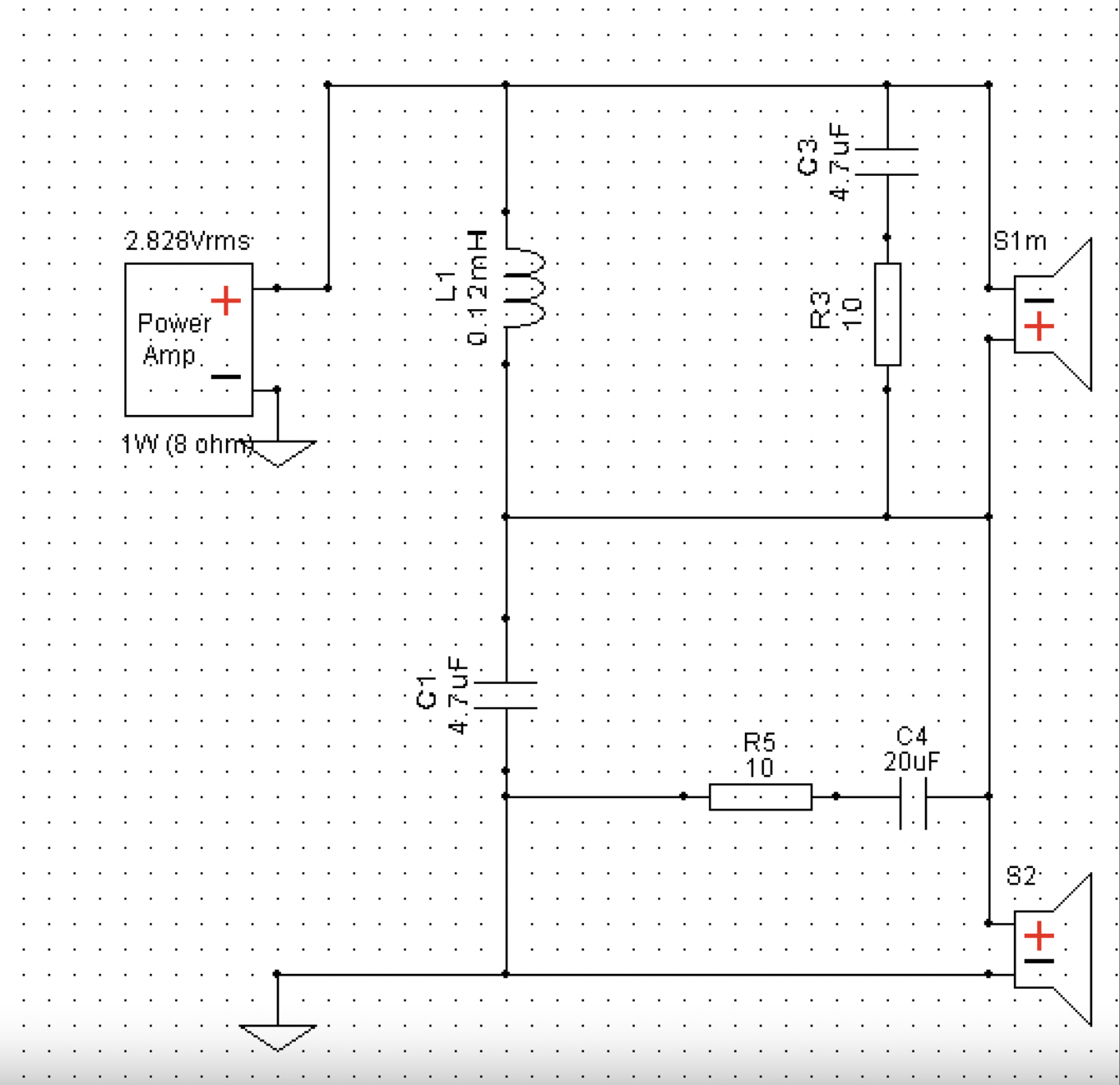

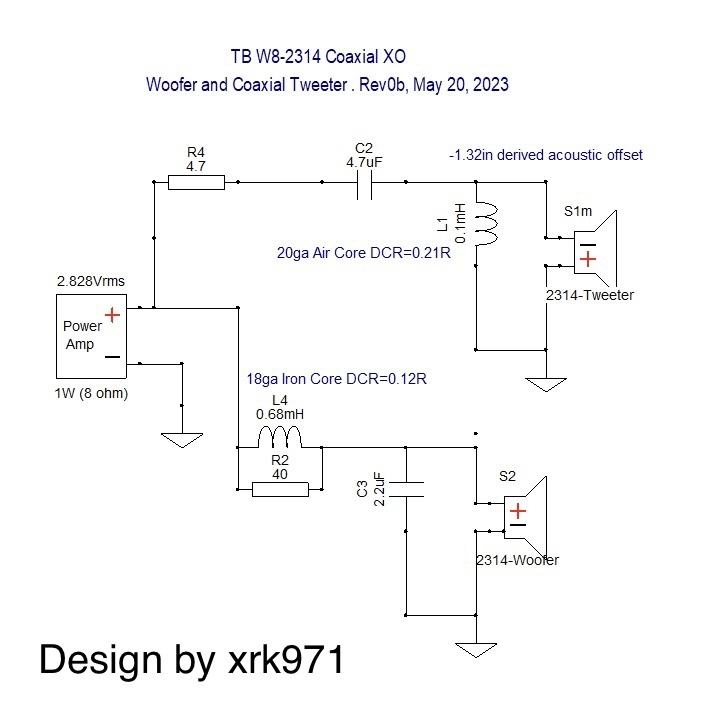

The TB W6 and W8 are quite nice, but not easy to dial in the XO between the woofer and the tweeter of the coax.
It's not as simple as adding a cap on the tweet!
Not it’s not which is why I designed a XO for it back on post 3907.
The coax allowed a nice time alignment almost transient perfect like right triangle step response:
(Mic is inverted)

Also made my series XO for them, and dang... I like how they sound.
