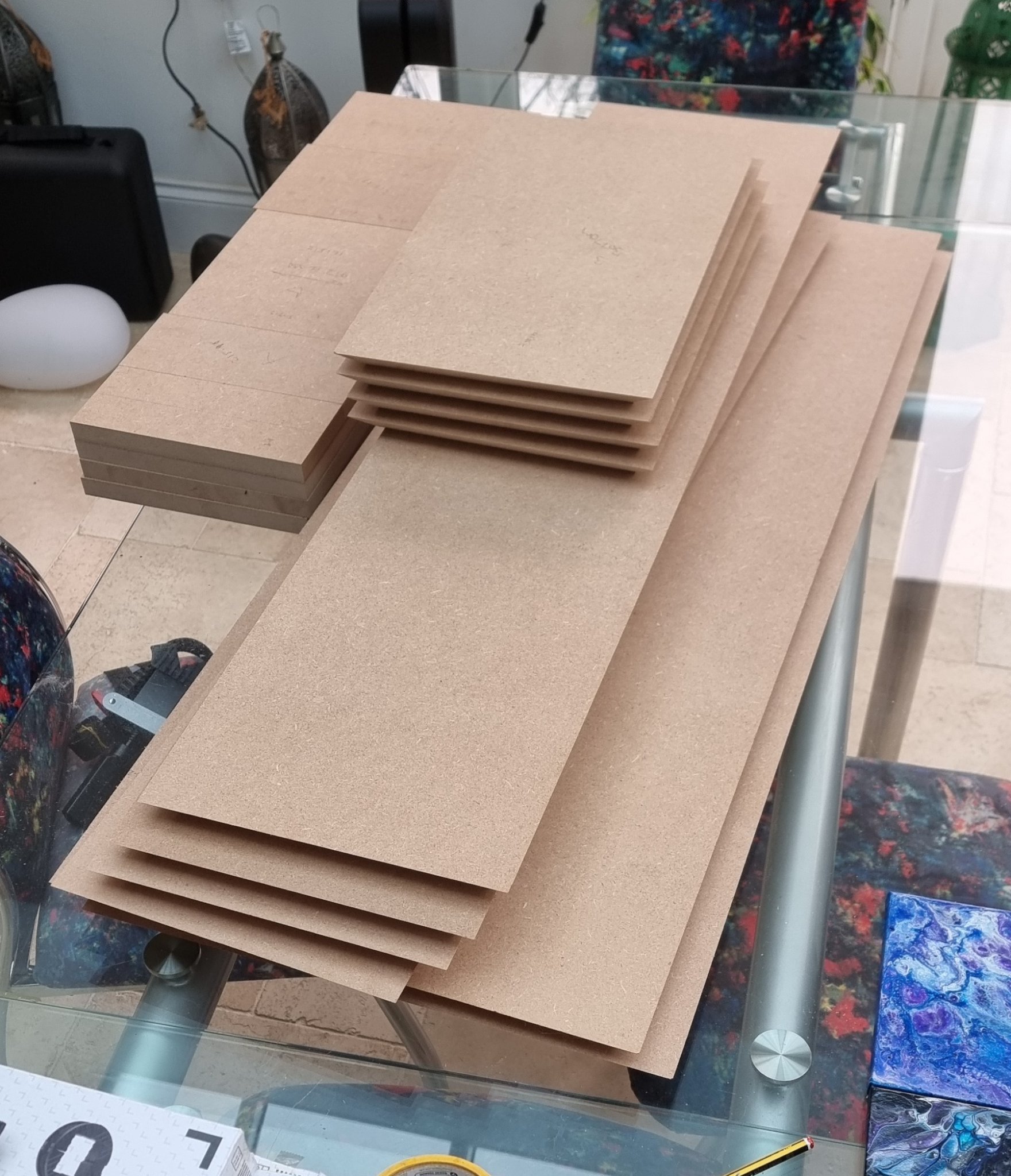

Quick question. Both drivers should be flush mounted, correct?
Coming together! Just wainting on inductors.

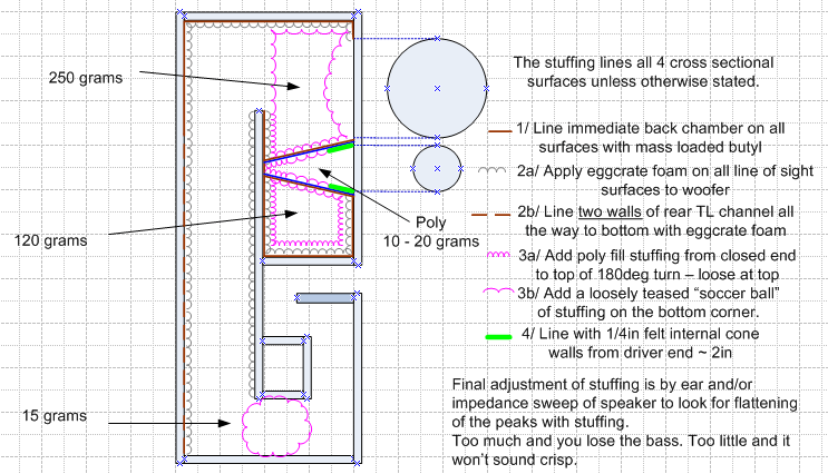

Quick question on the soccer cone.
Line the outside with butyl sound mat. Fill the inside with polywadding -10 to 20 grammes. 1/4" felt on inside, 2" band at driver end.
Seal so its airtight.
Fill area outside cone with polywadding too. (back of woofer and all around cone.)
If anyone has any photos of this bit, I'd appreciate it!

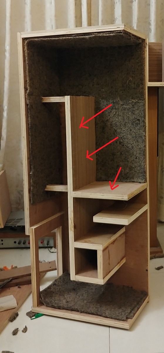

Found a pic of a partially lined cabinet from my build - attached for your reference.
The red arrows point towards internal spaces that were not lined at this stage, but need to be lined. I used jute felt instead of egg-crate foam.
