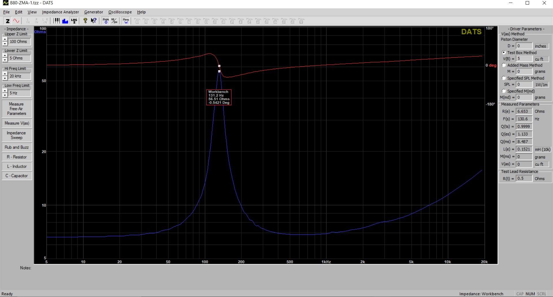

My B80 were quite off in specs from the online specs offered.
I assume you did run the drivers through DATS before going through all this trouble.
Did you find the same thing?
BTW, even though it might look like it, I am not complaining about the driver's sound.
I also felt it was very nice, but I wanted an opinion regarding it and the 10f.

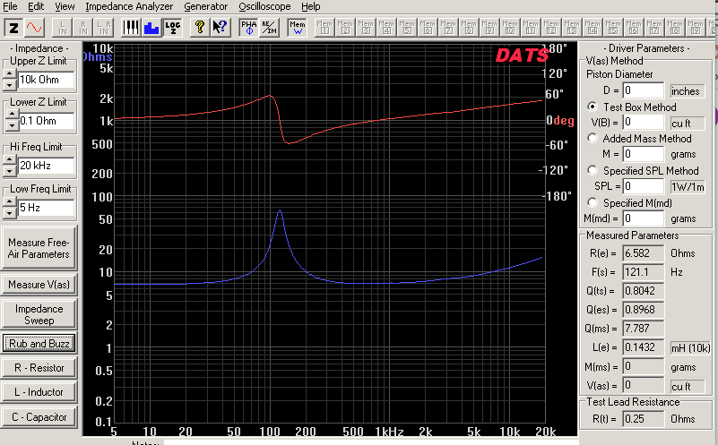

I posted this earlier, both drivers were similar. I never bothered to see if it matched the factory specs because in a sealed Dagger rear chamber, it doessn't really matter.
828416d1585383932-10f-8424-rs225-8-fast-waw-ref-monitor-b80-rs225-fast-impedance-air-1-jpg
Spec sheet here:
https://www.parts-express.com/pedocs/specs/292-660--visaton-b80-spec-sheet.pdf
Factory spec says Qts is 0.63 and I got about 1.0 for both of my drivers, so appears the magnet is not as powerful as they specify - nothing new here. Even 10F/8424 doesn't measure as specified. However, 0.63 to 1.0 is a big difference. The Fs is close off by 15Hz and may lower with some more break in.

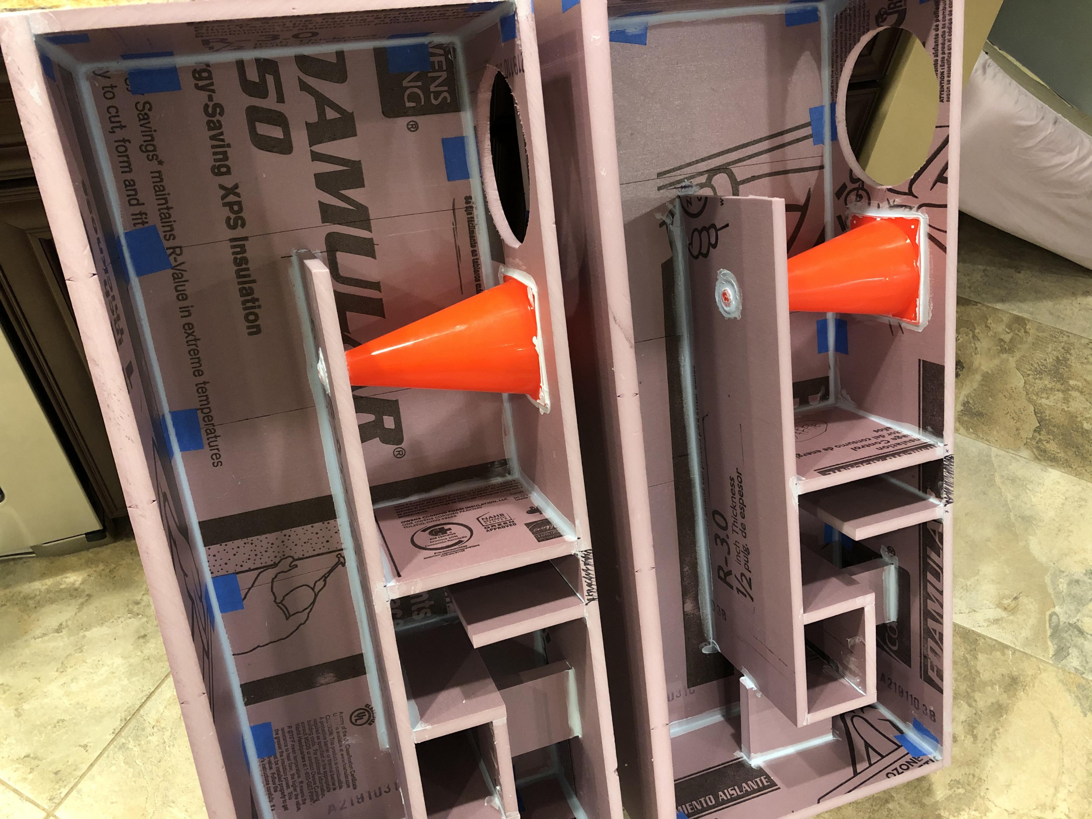

I want to start a small discussion about our choice of 3/4" (11Ply) Baltic Plywood.
I specified 3/4in ply for this speaker once I decided to make it out of wood vs XPS foam. There are already plenty of threads discussing the merits of BB ply vs MDF. I chose 3/4in BB ply mostly because it is high quality, looks good, takes on stain and varnish nicely, and retains dimensional stability, and it is tougher than MDF. I am not opposed to making speakers out of MDF but the stuff make some nasty dust when cut or sanded. Regarding panel resonance or damping - I think with adequate bracing and judicious use of constrained layer damping (CLD), even foam core speakers or XPS boxes can be made to sound great. The measurements of the BB ply cabinet with Noico and eggcrate foam is not too much better than the original pink XPS foam box with thin 3/16in luauan subfloor ply baffle.
Here was my comparison of the speaker with XPS vs 3/4in BB ply cabinet:

XRK - Sorry if this has been discussed previously. I'll try to find those discussions. I just brought up question about plywood to see what people though about that video. Maybe there is a better thread for that? I'm personally am in favor of using baltic birch plywood for all the same reasons you mentioned. MDF doesn't seem to have many good properties, other than being cheap and it's not really that cheap. XPS foam seems like a real winner. I'm very surprised by that frequency response comparison. I'll consider the XPS foam for future builds. It seems like it could easily be combined with ply, veneer, and acoustic treatments to make great speakers. I feel like 1/2" ply glues to 1/2" XPS could be nice. Can XPS be cut with a hot wire? I have some very large designs I want to build and I'll need to keep the weight down. These FAST TL speakers are going to be heavy but they will each be in three pieces: Base, Body, Top Hat.... so it's a good thing and should help performance.

Progress looks great Studiomic! No worries about the discussion about MDF vs BB. Just use the search function in DIYA. The bevel around the vent looks great.
The XPS glued with a thin ply cover makes an excellent lightweight speaker. It can be cut with hot wire, table saw, or a sharp utility knife and metal straightedge over maybe 10 gradual strokes.
Yeah, when I ordered the B80, originally, I had made a TL for it, followings specs online.
When I received the units and measured them, I had to throw that idea away!
I placed them in the Nola Brio clones instead and they sang well in there.

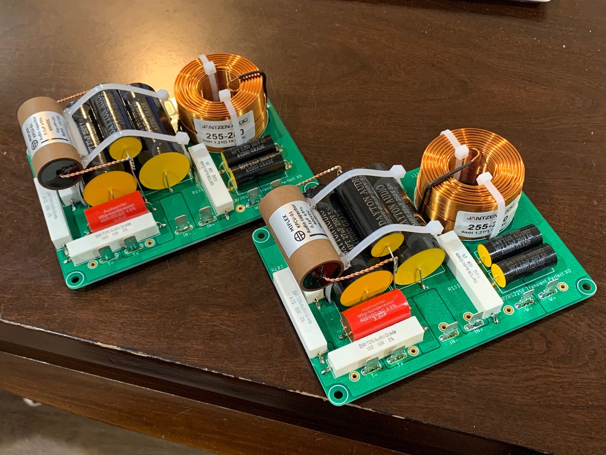

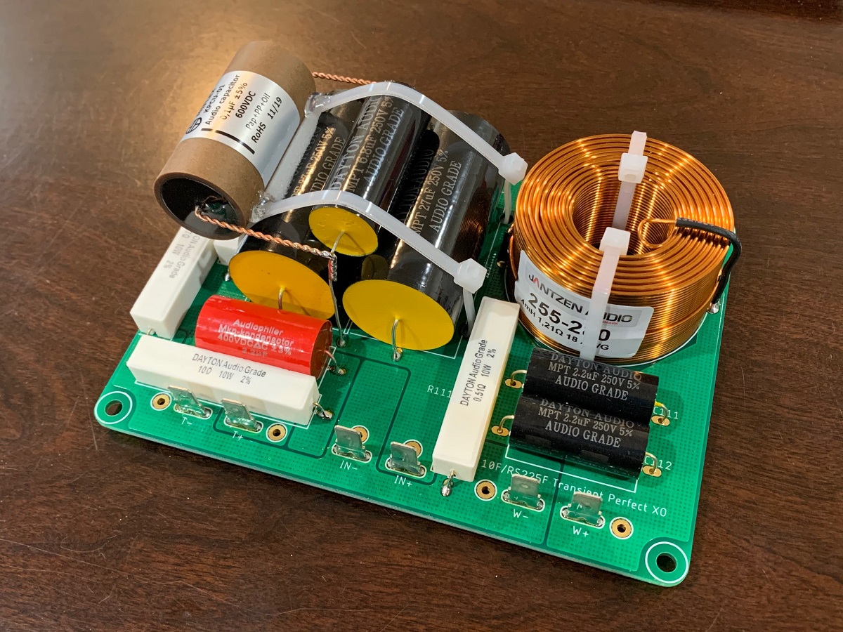

I finished up the XO's for the new TL's, slated to be completed soon. I was out of the usual boring black Dayton MPT 2.2uF, I am using a 2.2uF "Audiophiler" MKP 400v cap (on sale at PE for $1ea) with a marketing-enhanced red case :) But the seriously good (optional) Milfex KPCU-01 0.1uF 600v bypass has been added across C1 for enhanced resolution. The Miflex sits on a piece of melamine foam to help reduce microphonics in the HF range. This XO board is amazingly easy and fun to assemble with nicely spaced component positions and double thick copper with ENIG. The entire assembled XO board weighs about 2 lbs, which is kind of amazing.
attachment.php
attachment.php
The next upgrade would be to change R1 and R2 to Mills 12w MRA resistors.
