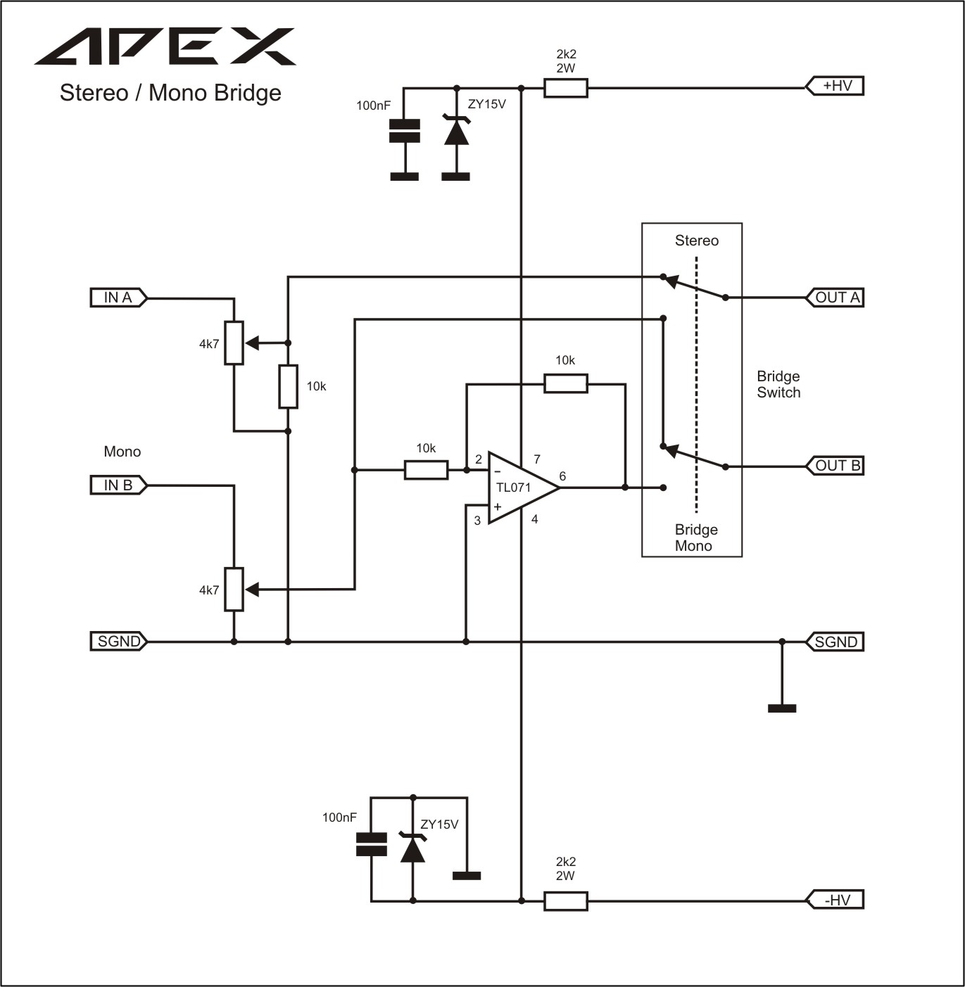

master can i bridge the b80? what is the procedure?tnxx
You can use this circuit for bridge two amps.

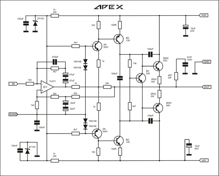

im thinking of starting the construction of ax14.is this the correct schematic at post #1240?
APEX i found this schematic of yours. can you give some information and pcb?
Schematic in post #1240 is correct, and there is to many amps schematics this is B50 but only for test B500 sound in home audio.
thanks for reply.i have also seen o photo of B500 with one pair of output transistors.can you post the pcb?
so ,for home audio in the range of 50-100 watts which one do you suggest? ax14, B500 with one output pair, or something else?
B500 with one pair of output transistors is not my work.
I suggest SR100
Regards
