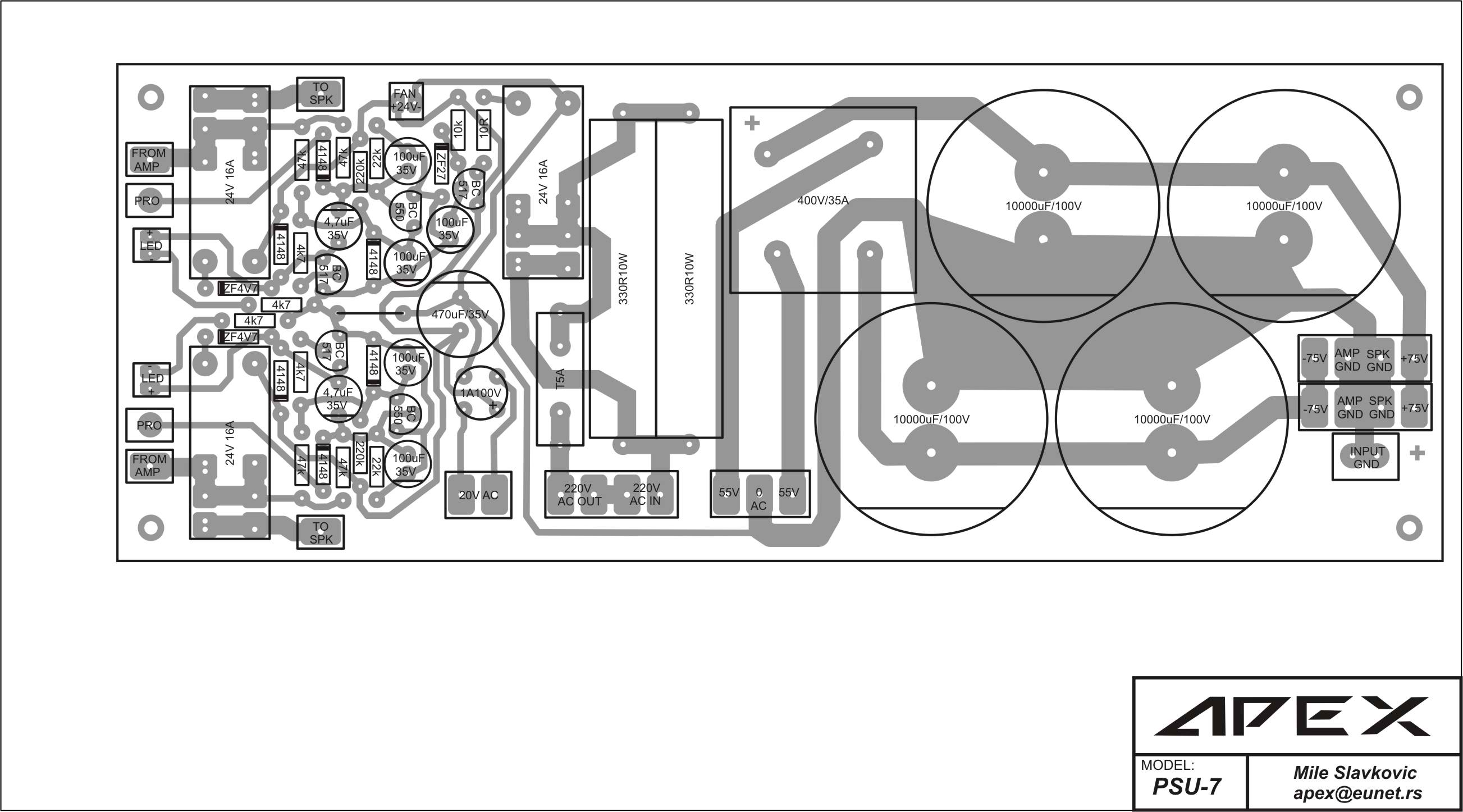

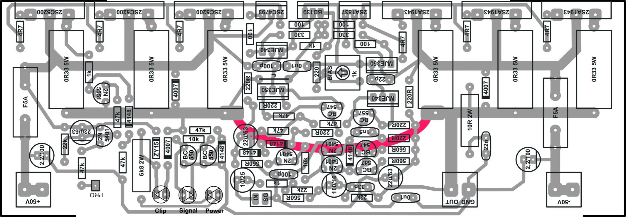

Hi! Sir Apex,
It's been a while guess I have lost track of the progress in this thread...
Actually I have been keeping these files for my future DIY project and I guess it's about time...will these pair of circuit work effectively? (below image)
However I may have a problem acquiring BC517, any sub for this transistors?
Also what could be the safe value for T5A (thermistor) in the soft start.?
I assume the protect terminal of the amp connects to the protect terminal of the PSU? Kindly clarify would there be any component changes on both circuit. I will be using +/-50vdc rated at 500w.
Guess I have asked too much
Regards!
