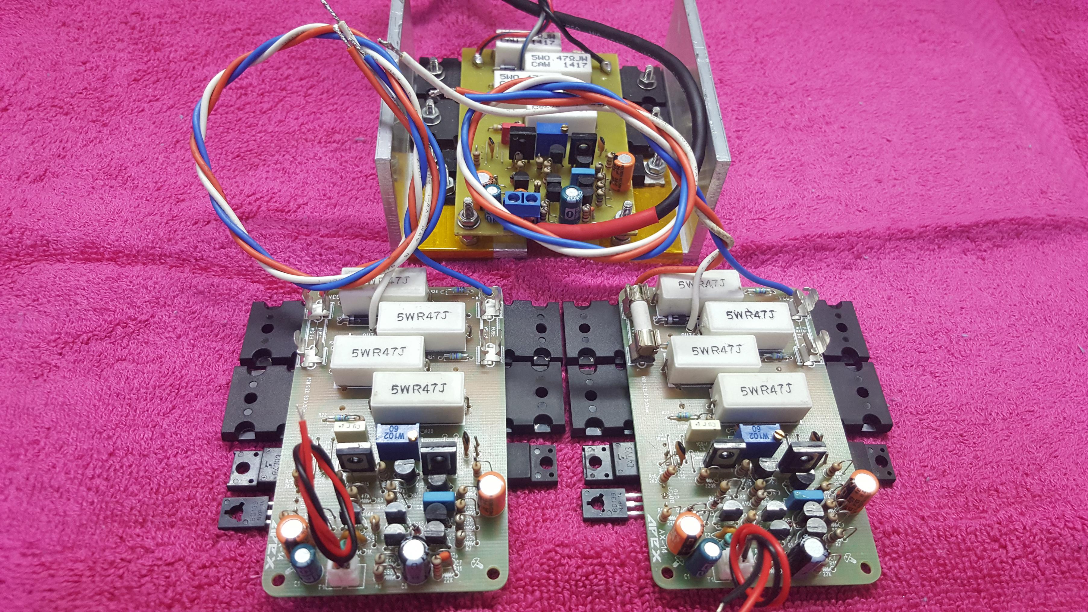

100W Ultimate Fidelity Amplifier

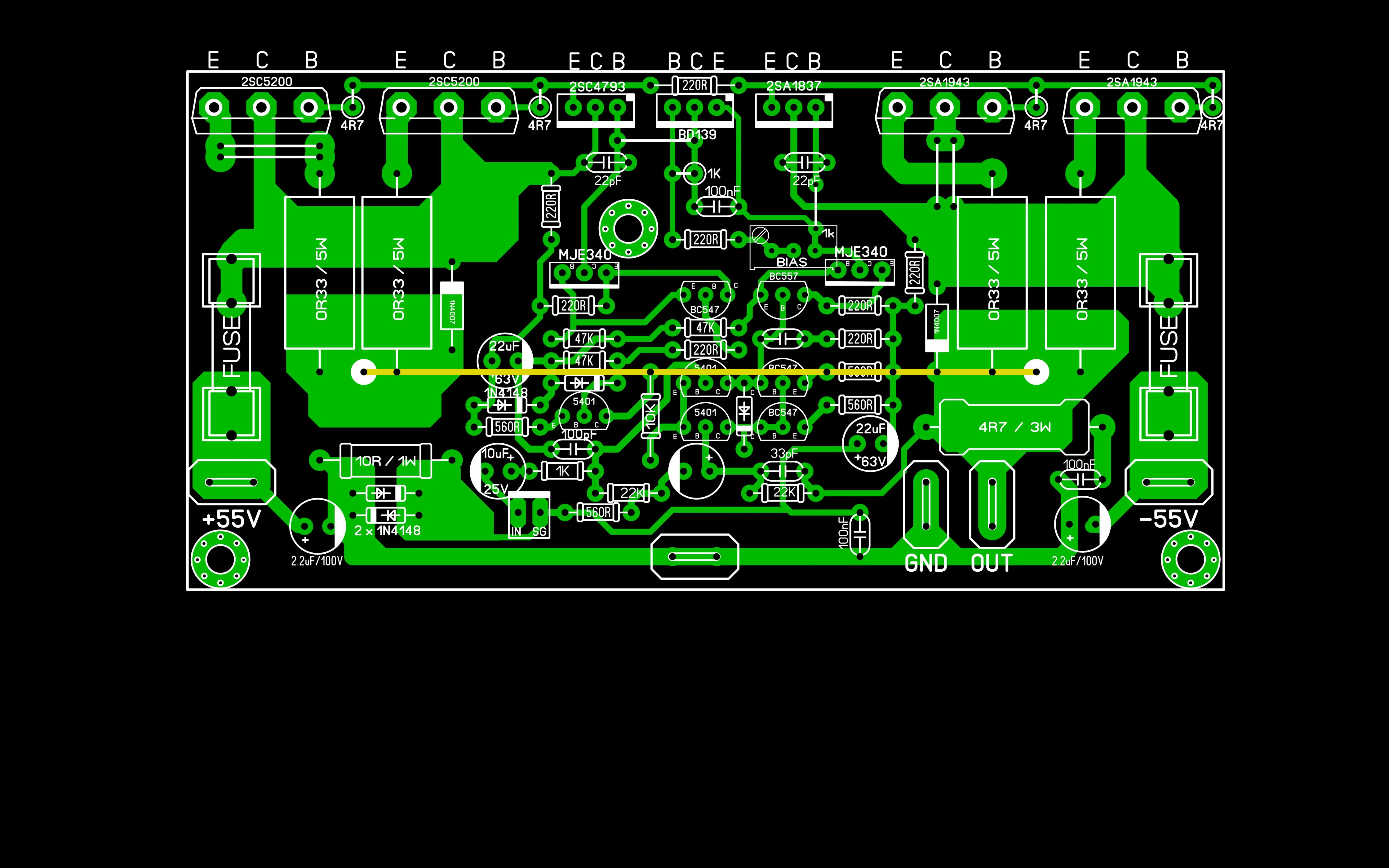

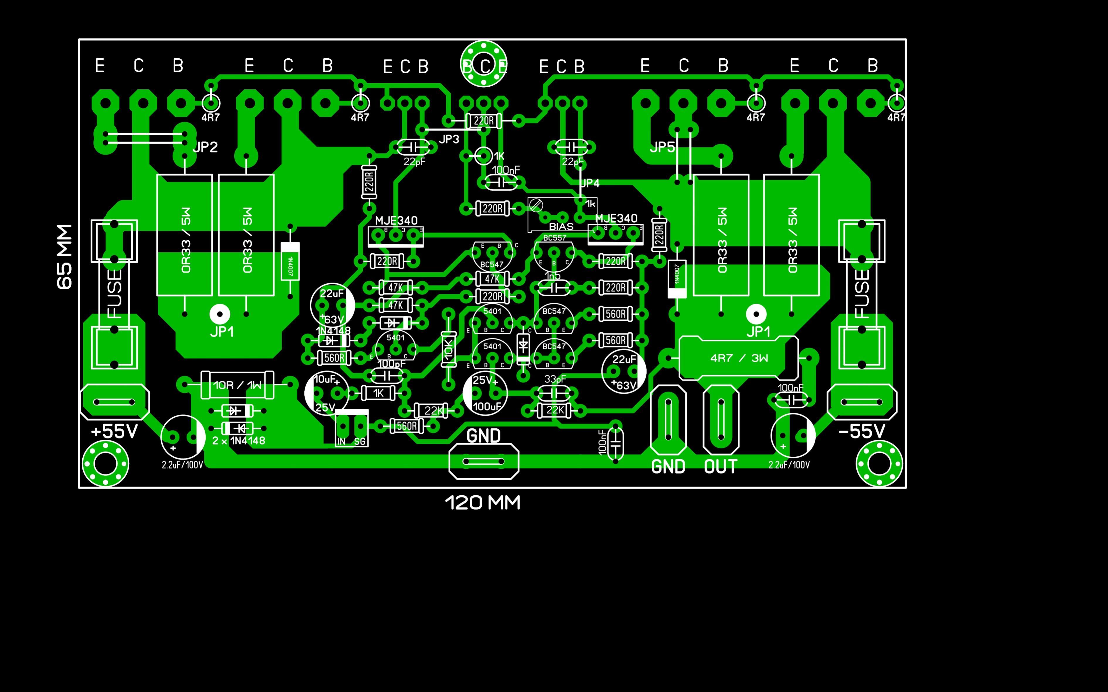

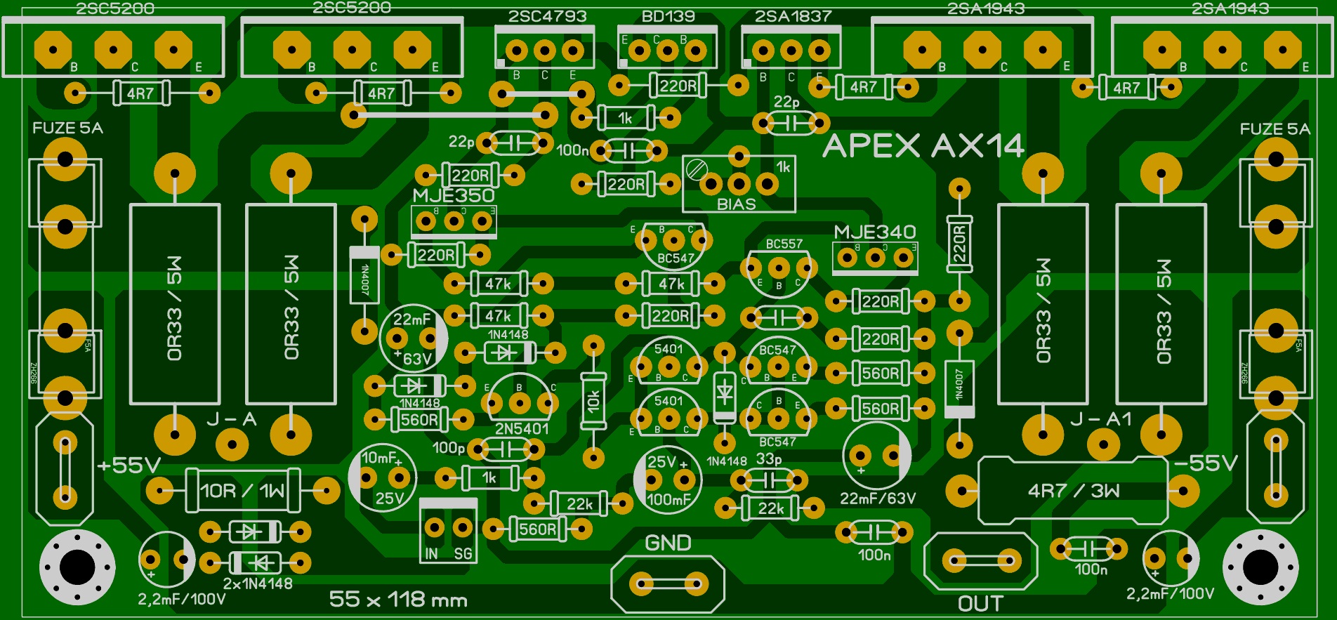

No. If you don't find it, it's not too difficult to work out. Quickly comparing it with the original schematic in post #1 :
- R21,22,23,24, Q12 and Q14 are doubled up, as you would expect.
- C13 has been replaced with 10R and 2 x 1N4148 all in parallel, ground loop breaker.
Also there must be link between points J-A and J-A1, not shown on the layout.
I'll leave it with you to follow through the rest of it for any other changes.
Looks like quite a nice single sided layout, I may use it myself, when I ever get round to it.
Simon

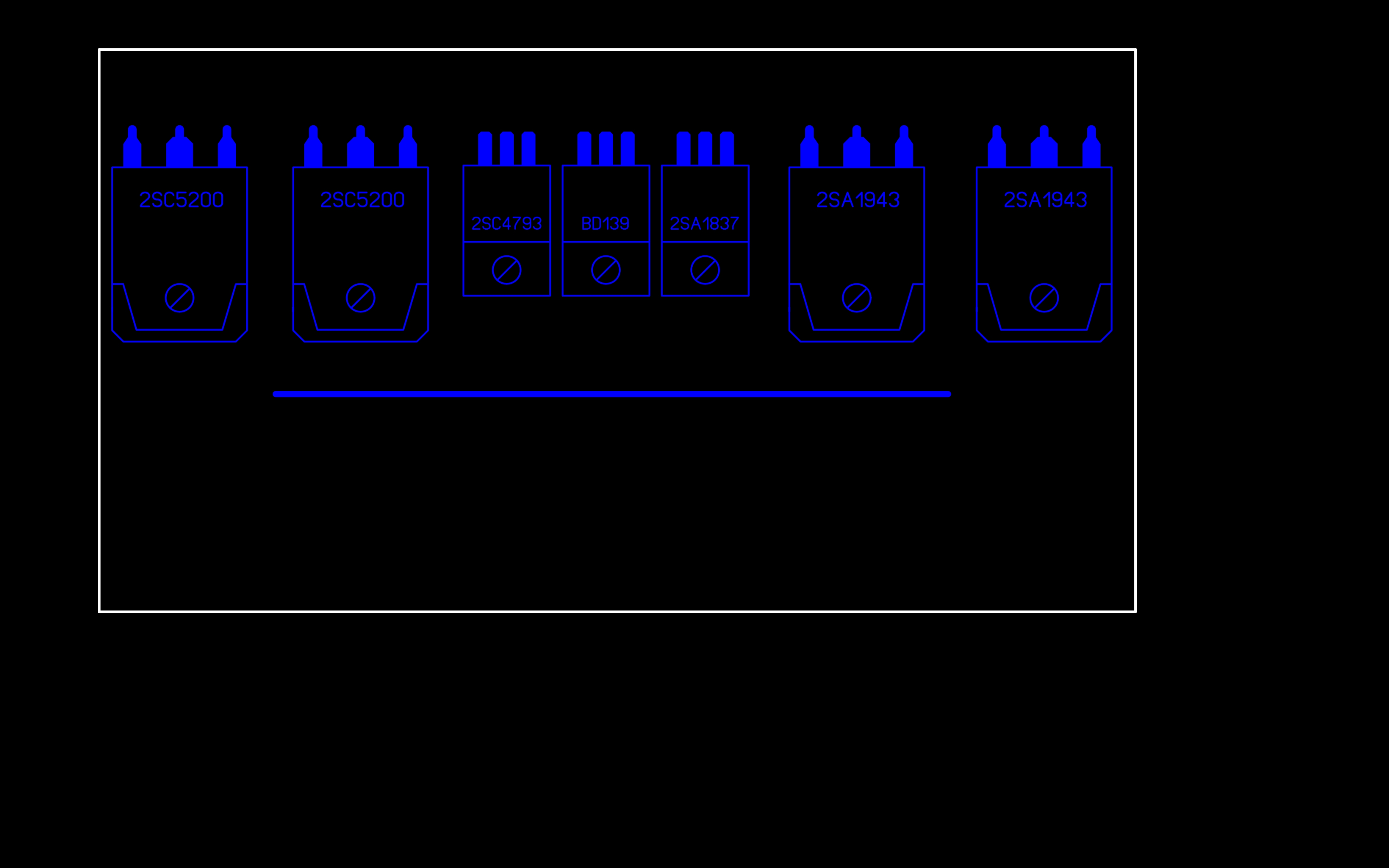

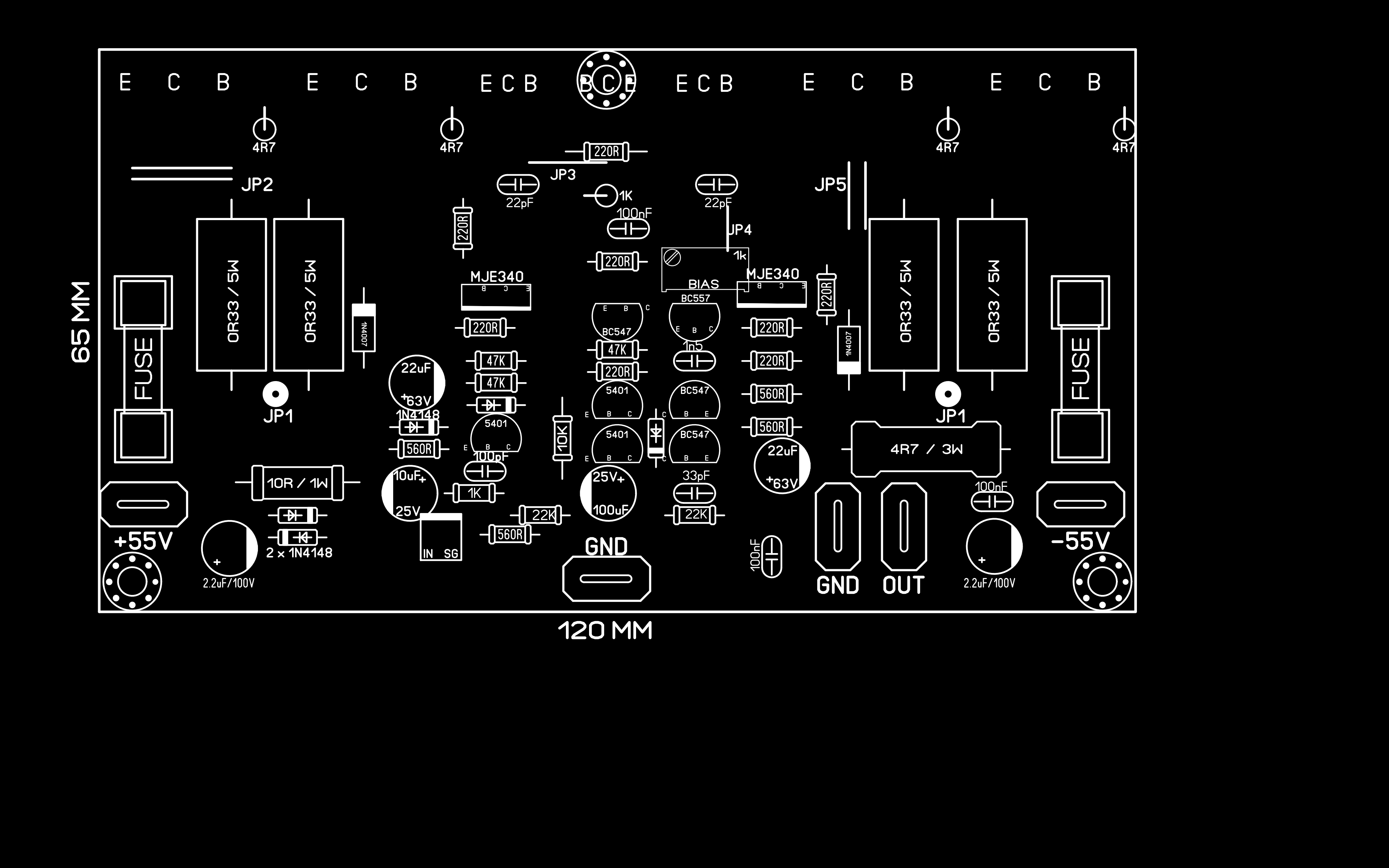

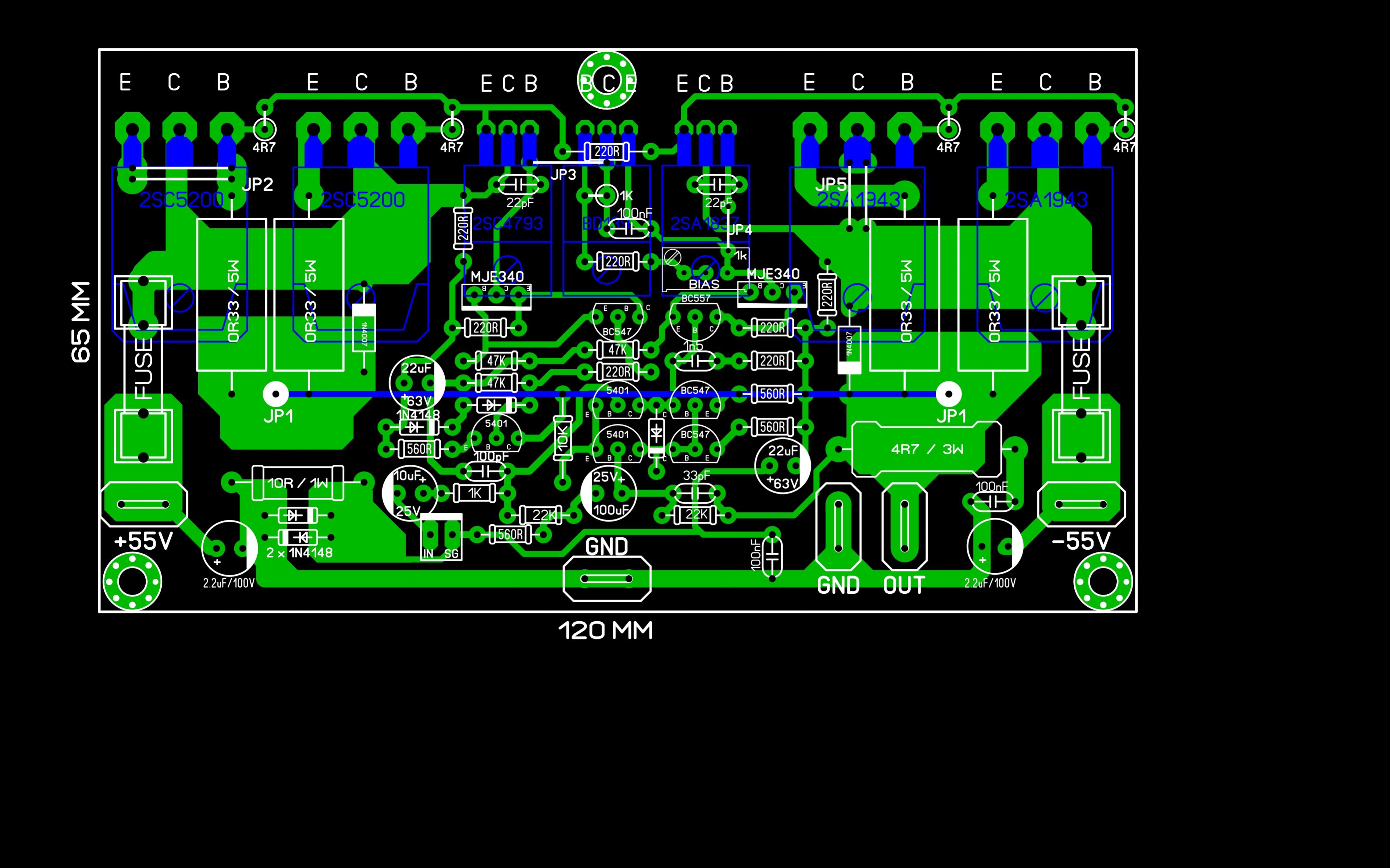

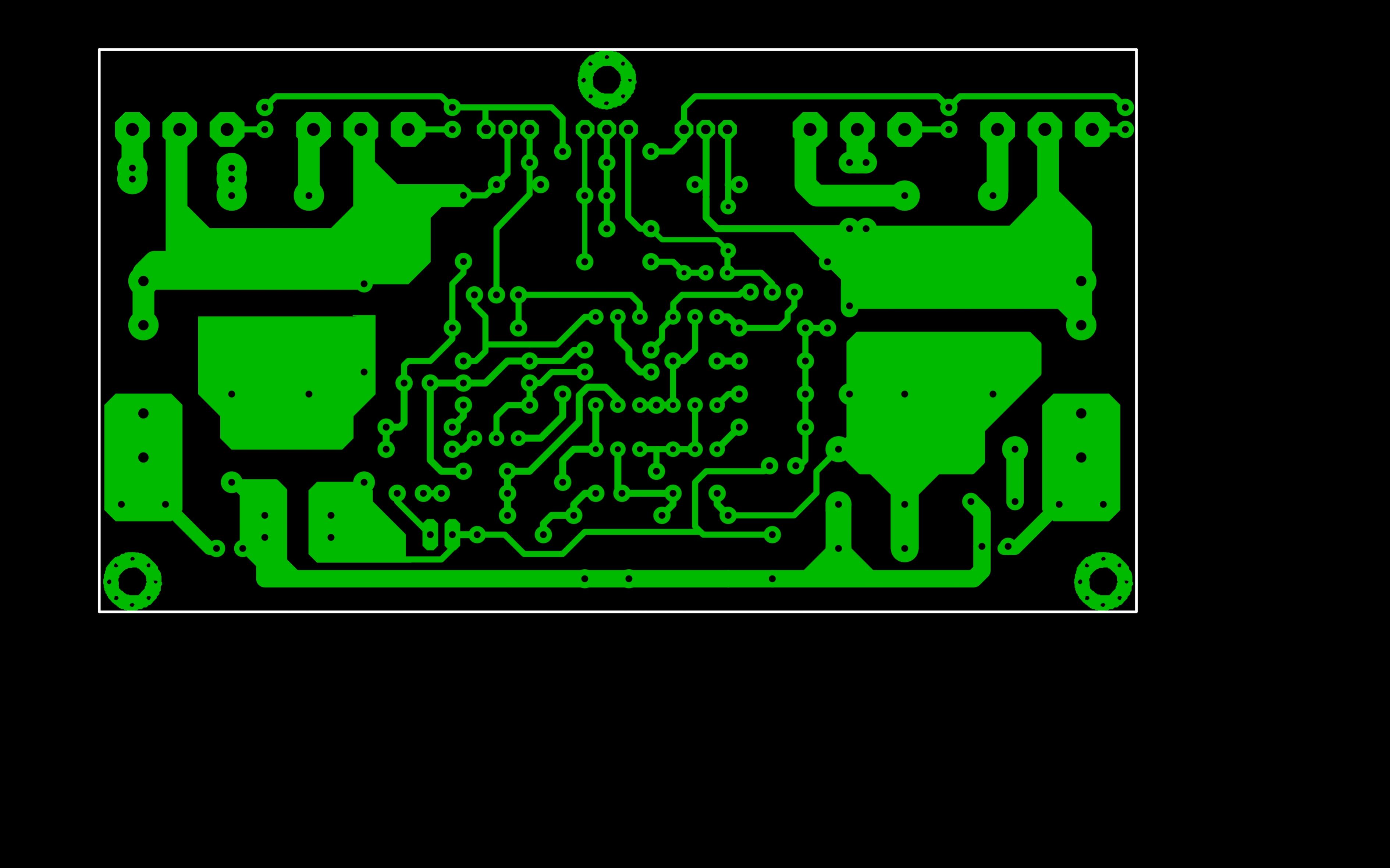

If anibody have any sugestions.. post please.
  • Silkscreen.pdf
  • pcb mirror.pdf
  • pcb.pdf
Simon
schematic in post #1 is not final. the one in post # 22 is, IMHO.
regards
Prasi
