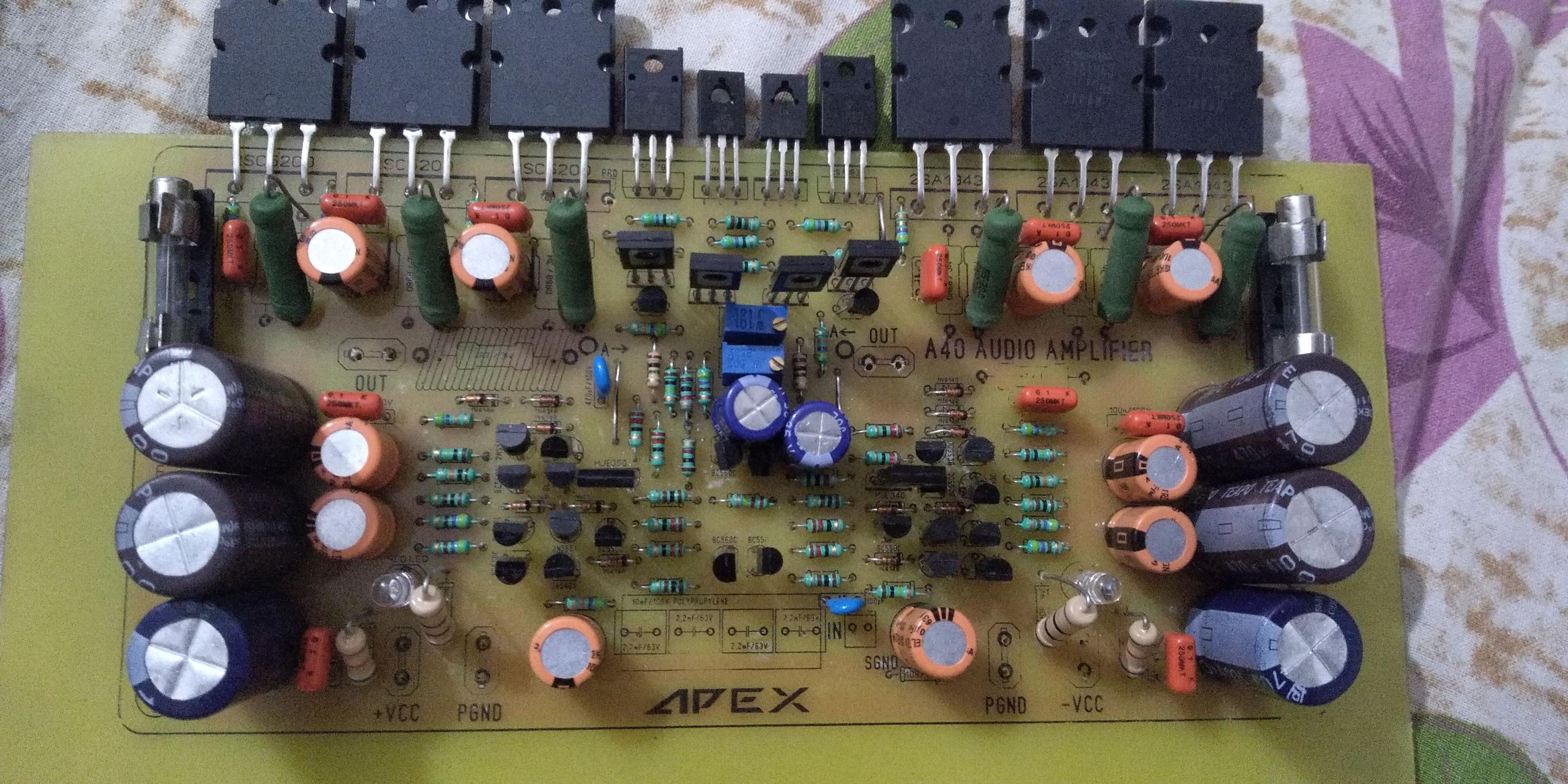

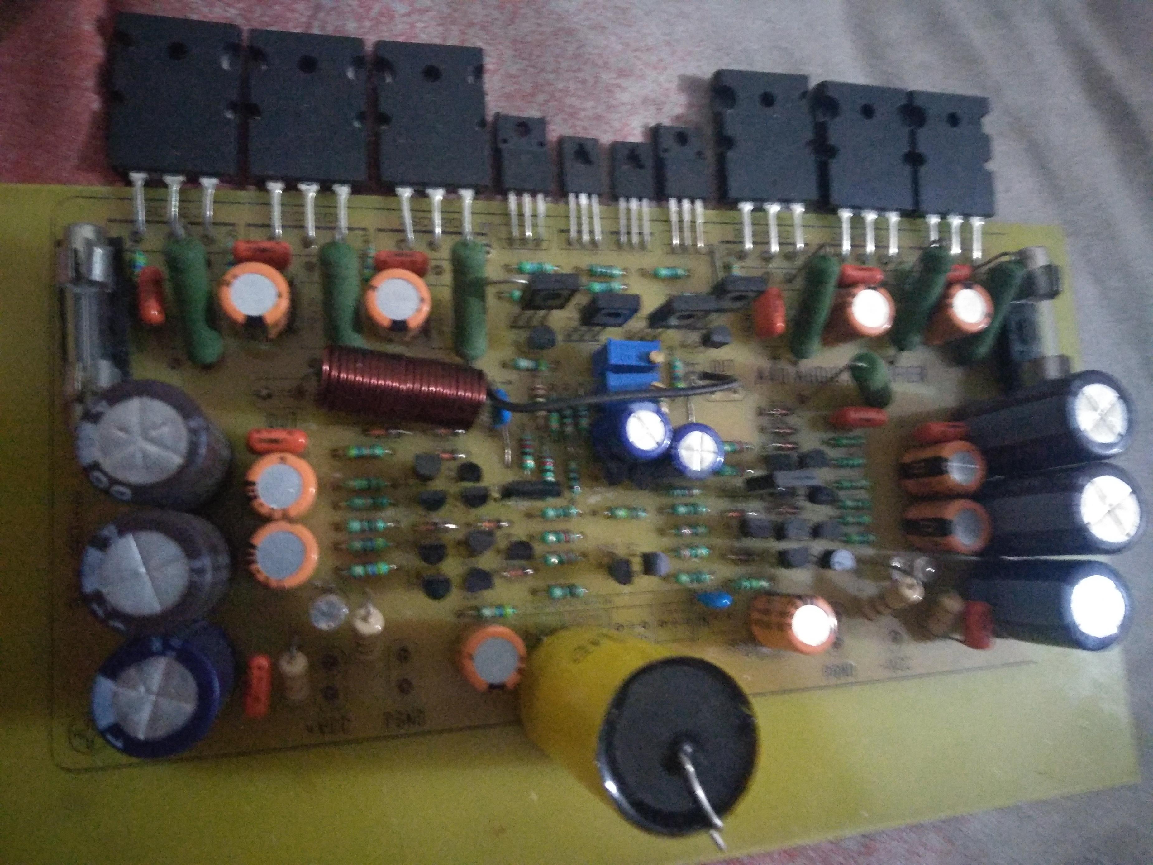

Here is the list of change,
Bc546/556 for bc547/557
A1220/c2690 for 340/350
Mje15034/15035 for 1837/4793
Mjl3281/1302 for 1943/5200
Offset is on the high side, actually one channel is around 6mv another is 17mv, but no problem so far, no hiss or hum.
For the sound, high is very good comparable to class A amp, bass is not as deep as I would like it to be. I will change the main filter cap and see what happen. Now I'm using panasonic I plan to change to Nippon chemical.

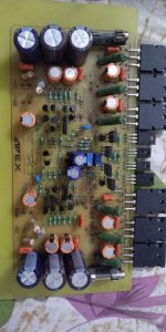

First, you have to change fuses with smaller type 5X20mm , missing input capacitor and ground lift resistor, don't forget to link A points with wire under PCB . Cut PCB at normal size, make some hols in corners . Pcb was tested and it's functional .....

Can I use 55_0_55 15 amp transformer for ax40.i use 5200 .1943 pair.or 470uf100 volt.guys plz tell
Hi Sunny22g,
AX40 or A40, hope it is A40. And 55-0-55 volt AC is little high for A40 I think. Better get advise form experts over here.

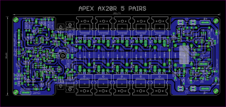

APEX AX 20R
Is this pcb available in black&white for home etching?

Chat 72. Bro it's to gain resistor r8 .What u use upper like 1k 2 k then gain is low.when u come down then gain up
