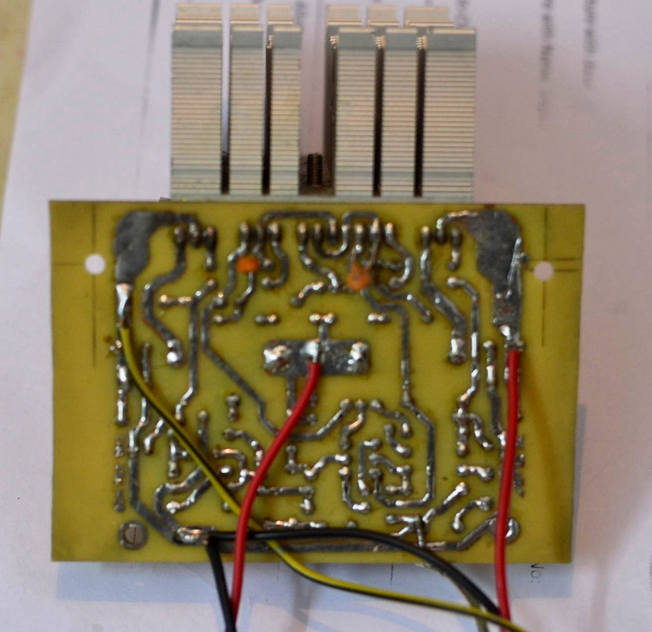

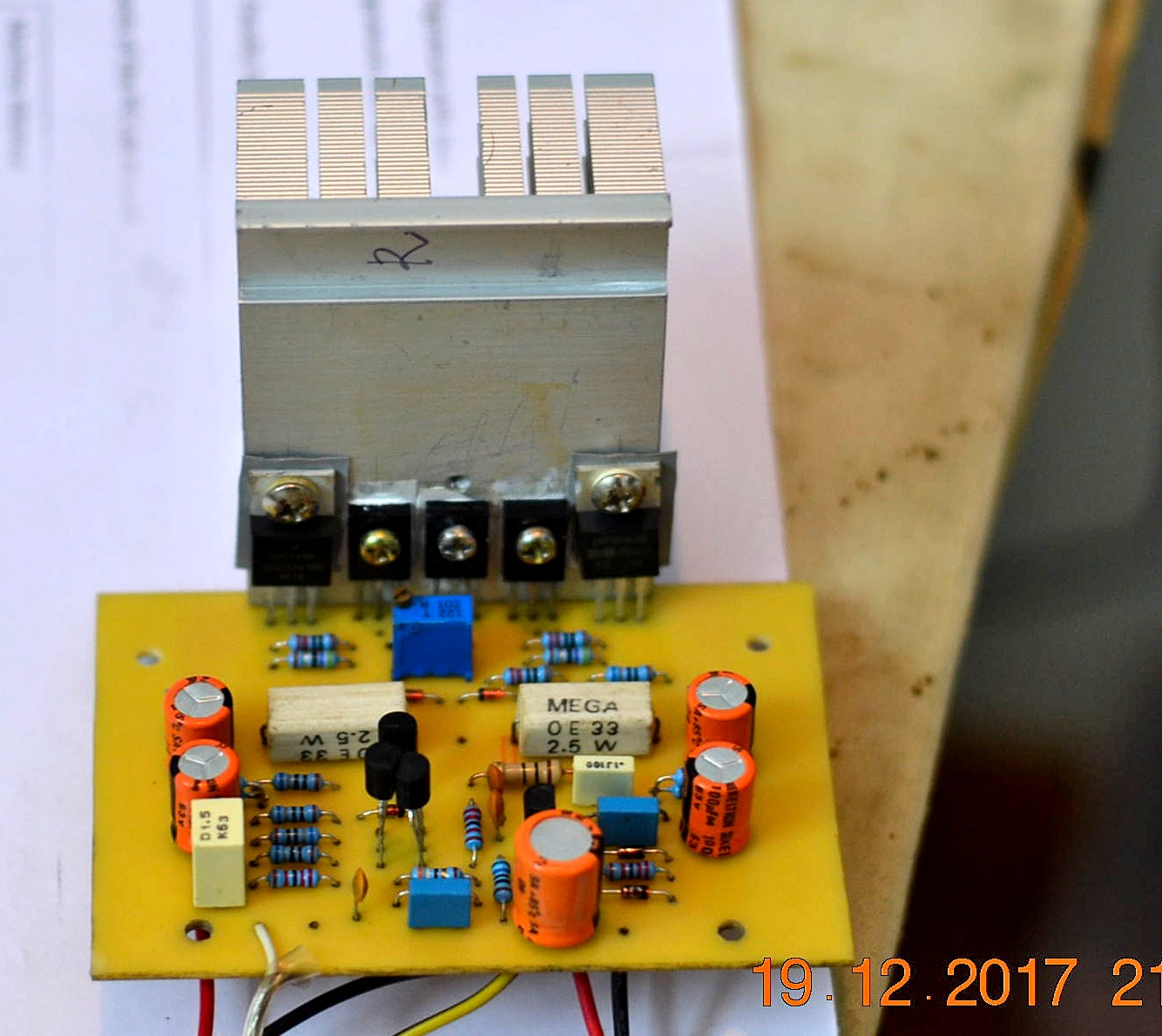

Apex FH9-with IRF540/9540
Completed Apex FH9 with IRF540/9540 withe the following modifications:
Driver transistor used: KSC1381/3503
Reduce the capacitor from collector to base to 33pF.
Sounds nice...
Thank you Mr. MIle, XRK, SK KAchhap and Prasi.
I don't have access to oscilloscope.
Please clarify my doubts:
What is the maximum supply voltage for 4R load with 1 pair of IRF540/9540.
Will there be any stability issues if we reduce the capacitor on collector to base of the driver transistor?
Will there be any improvement in the audio quality if the LTP transistors are changed to 2SC2240?
Kindly reply.

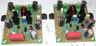

I finished build apex A9 with irf540/9540 outputs. The sound is amazing, tight bass..exceptional imaging.
What is the resistance value on bias 10k VR to obtain proper bias?
