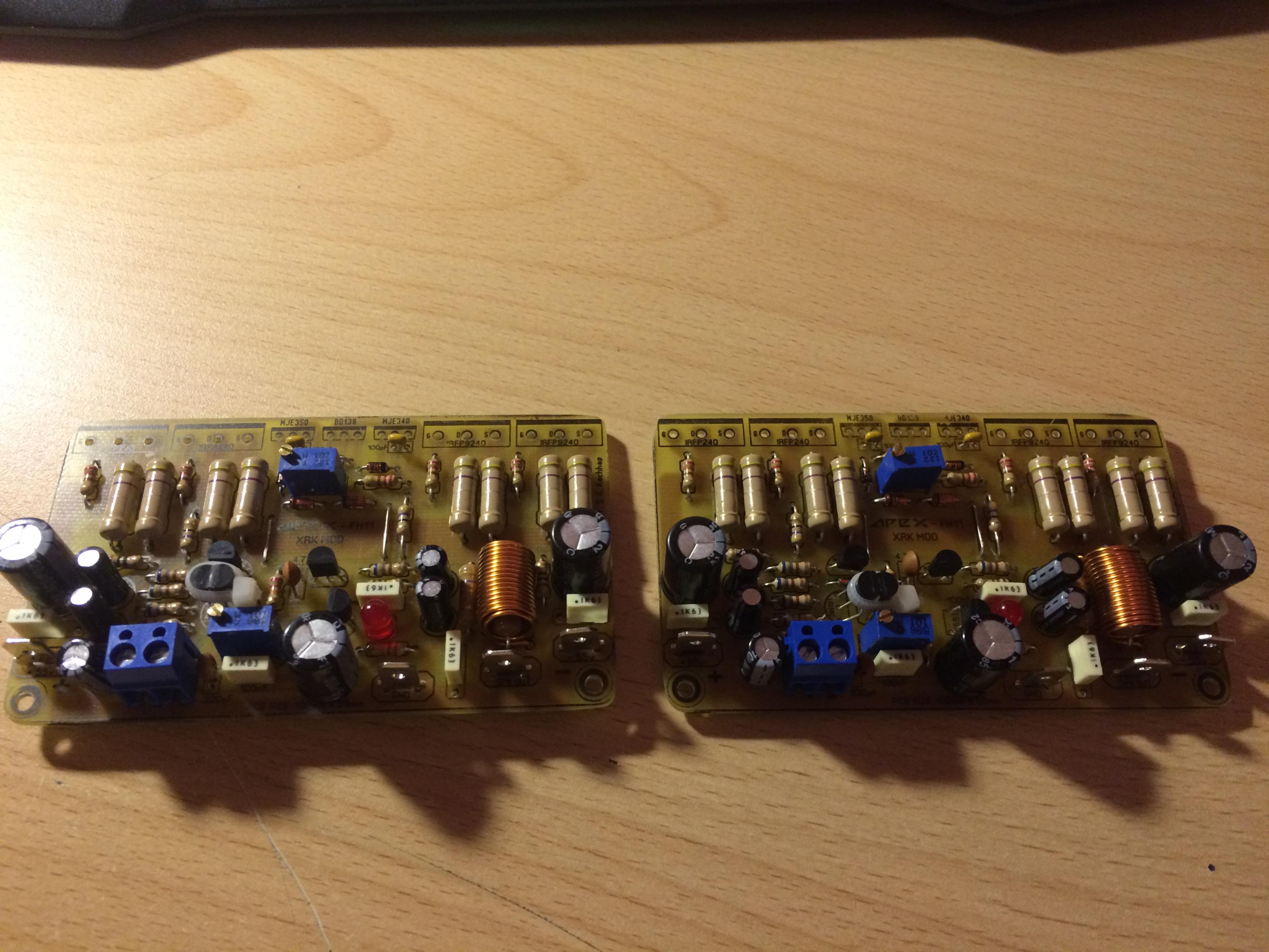

FX8 Bimo mod.Sound very dynamic.super.
Very nice build...I need to join the club urgently, I have the original renesas 2sk and 2sj from VSSA and basic FX-8 builds from long ago.

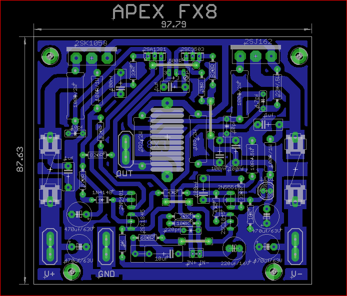

2SK1529 and 2SJ200 can be use for FX14
Hi Apex! can i use 2SK1058/2SJ162?
and 35+35 v.dc?
and 35+35 v.dc?
