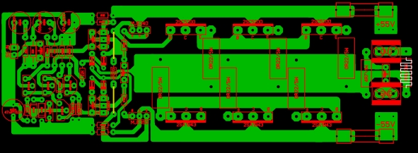

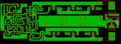

So you picked 2SA1381 / 2SC3503. Nice PCB layout too. Don't you think Q7,Q8 should be on the edge of the PCB for a sink?
There are quite a few varieties of physical layouts that will accommodate attachment of heatsink. This one appears to be the mounting of Q7 and Q8 to the bottom of the board allowing the screw to be tightened where the device peeks out of the left and right sides. This gives the devices a larger physical separation, and to my mind, better heat dissipation, at the cost of perhaps a less-convenient overall chassis design? I like this arrangement. Can't articulate it better. Might just be superstition.
I have only given this a quick glance, however... Should the heavy, flat line representing the back of the device be on the other side - i.e. are the devices rotated 180 degrees? Sorry, if I am mistaken. Alternatively, I have seen a few designs that actually run wires from the MOSFETs to the heatsink, apparently as much as 6-8 inches - not recommending it, but it's been done.
AX11 TEF.JPG AX11 TEF
Learning S.L

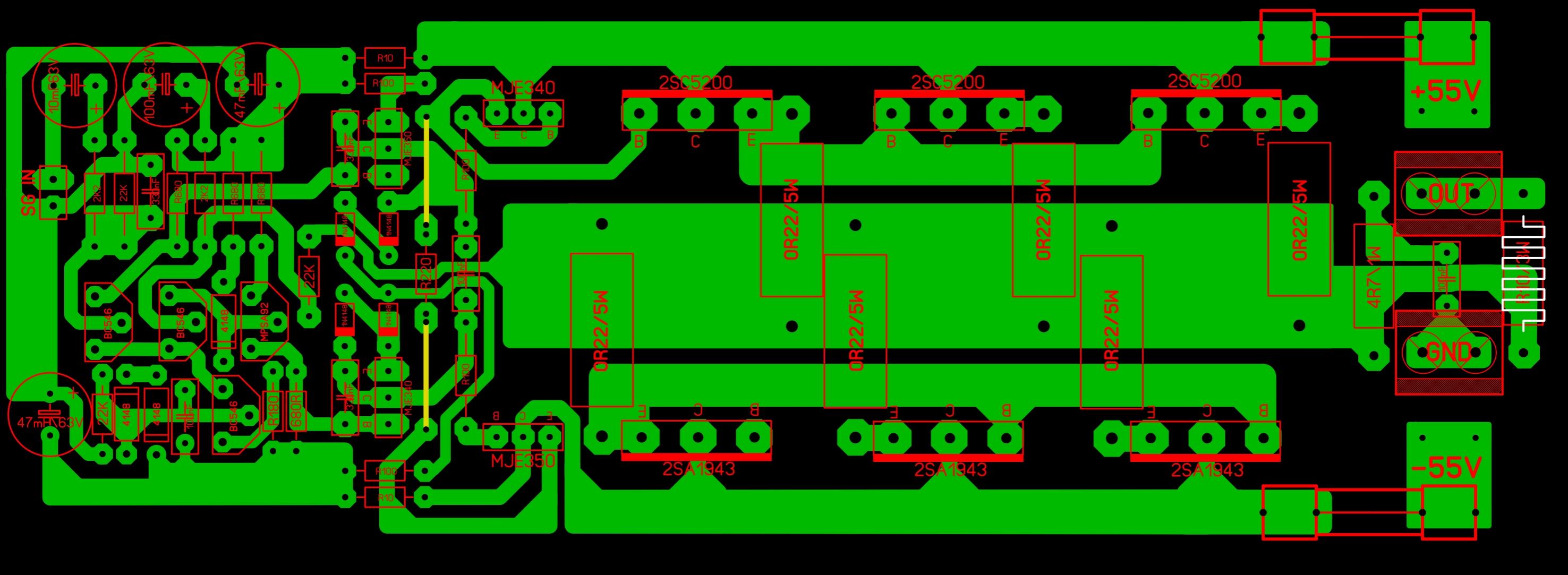

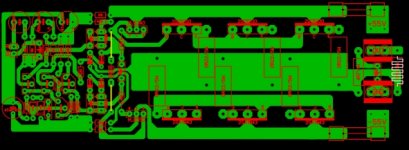

Can you Please check the layers of the board
regards Student

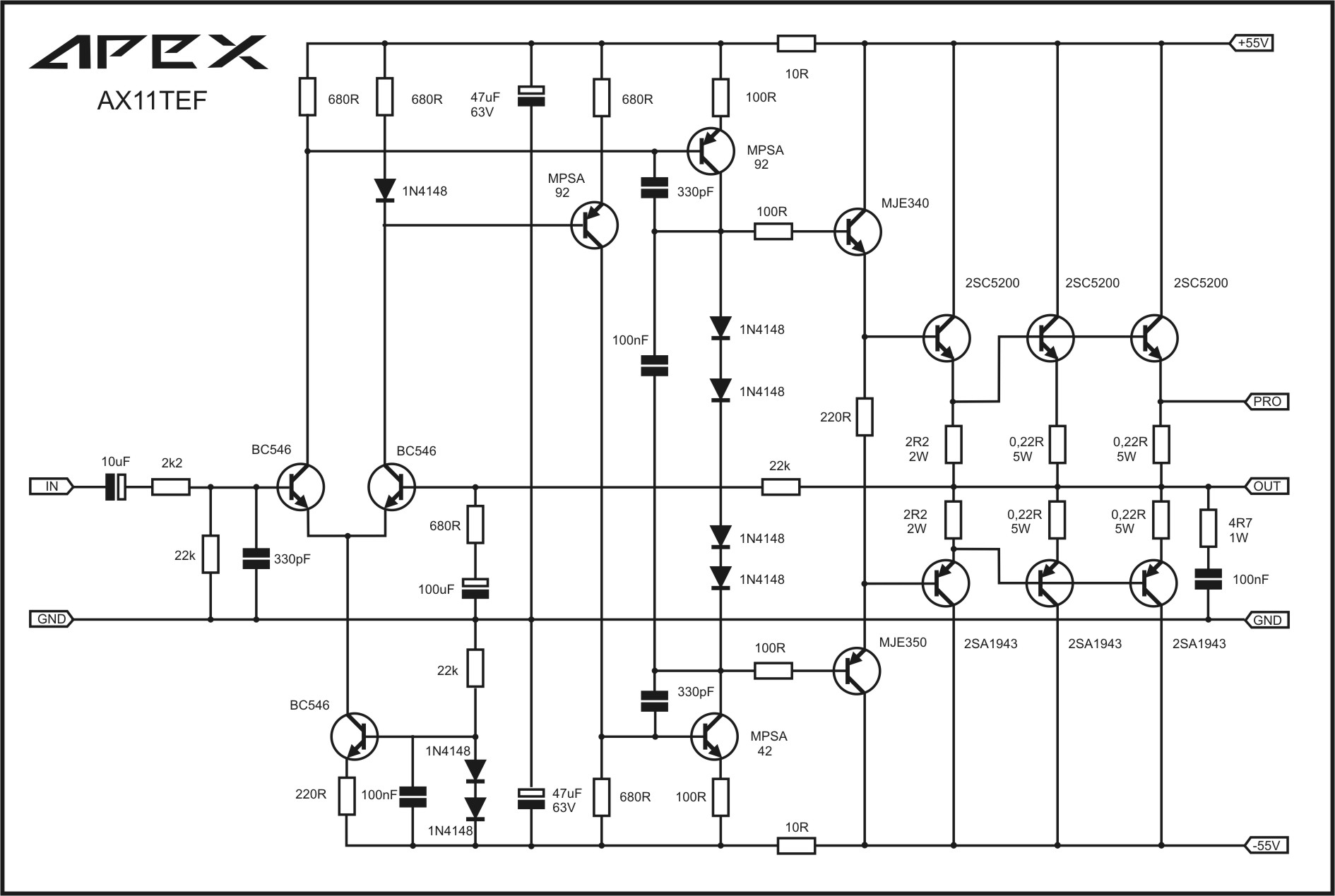

No local supply decoupling.
NFB tapped off wrong end of the output rail.
Output Zobel return route not connected to amplifier output devices.
Drivers have lots of capacity for far more than a 2pair output stage.
Output stage of 2pair of 1943/5200 cannot drive 150W into 8ohms reliably from your ±55Vdc supply rails.
Three pair would work. And use smaller, faster drivers. Try mje15034/5
No base stoppers for the drivers, nor the outputs.
Ask Apex what happens if ONE supply rail fuse opens.
Ask Apex how well the lack of bias tempco works.

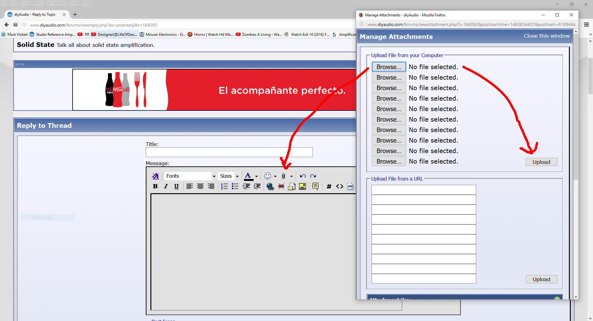

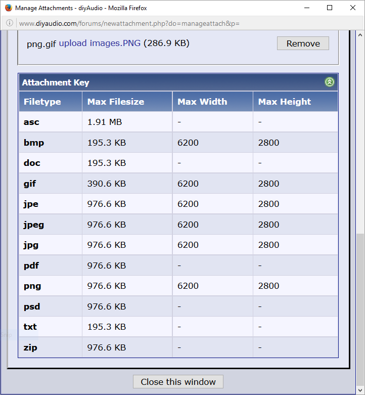

hello sir try to use the image attaching from diyAudio webpage the link you post of your images maybe in the future, might be lost also try to keep images in small size there is guide of how many kilobytes are allowed but don't make them too small, in case you need help for troubleshooting a circuit they are good eyes here that always help for sure :)
