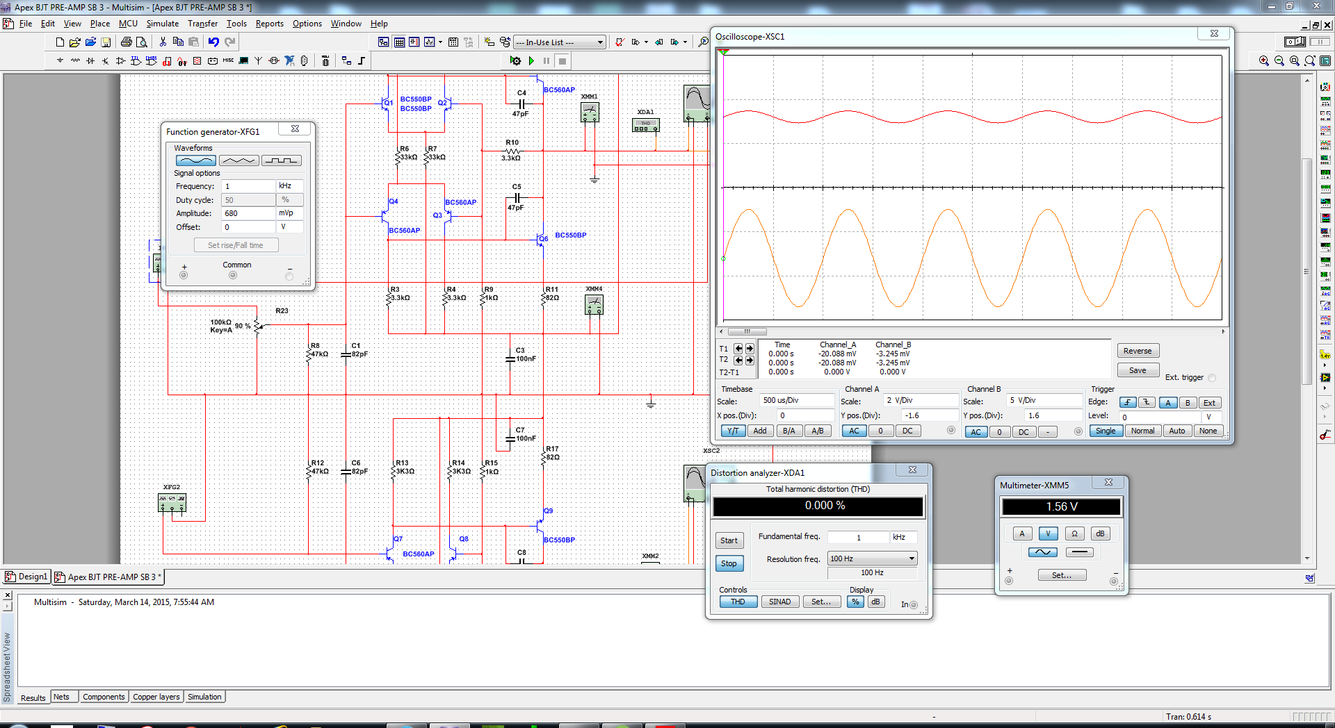

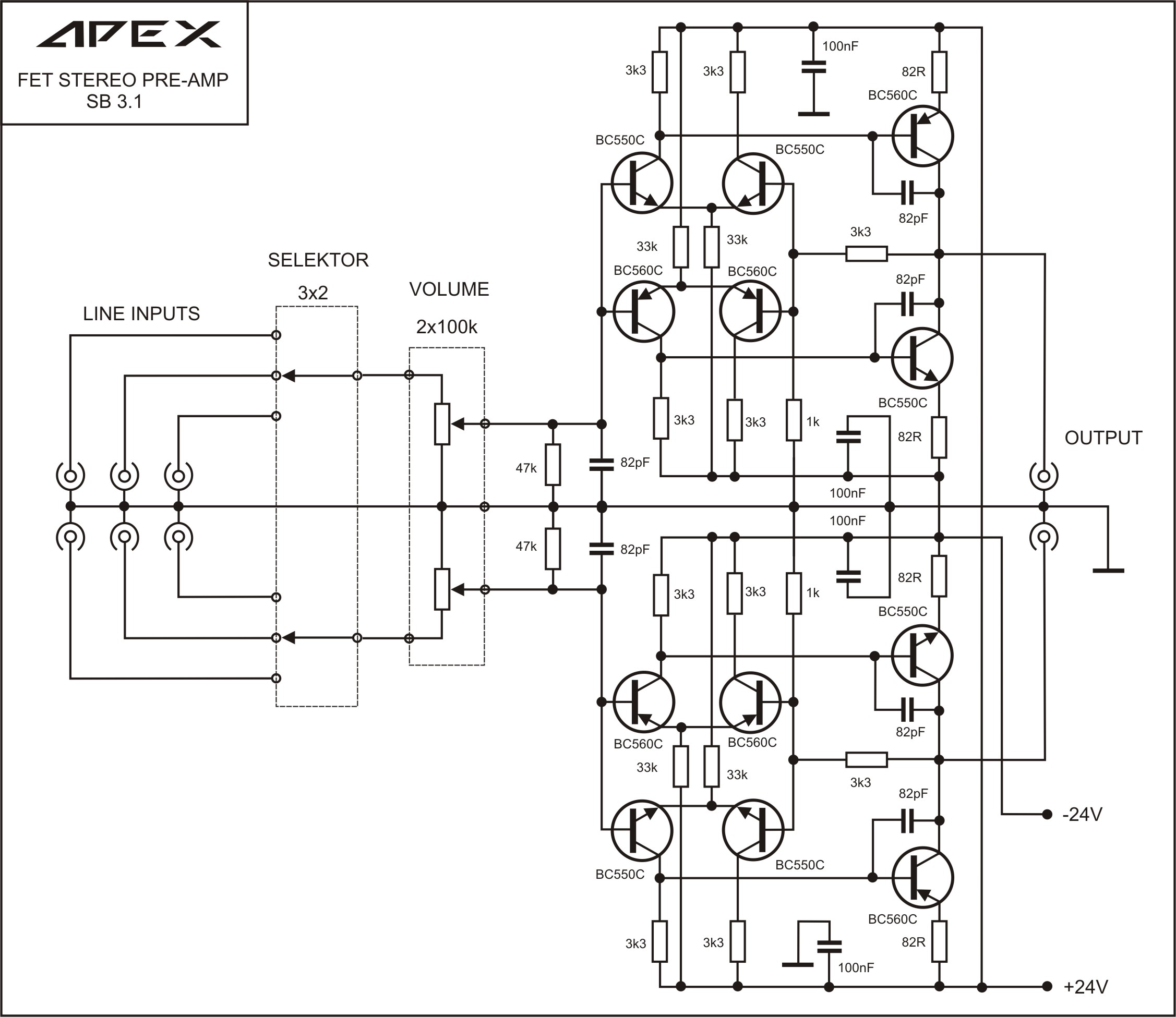

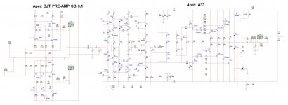

Do it JuanHello guys I was just playing with the Preamp SB 3.1 and A33 together
maybe .... I will make preamp SB 3.1 later

Make a buffer ,we have so many amplifiers.....it is absolutely nessecery.:
Something simple using common bgt.

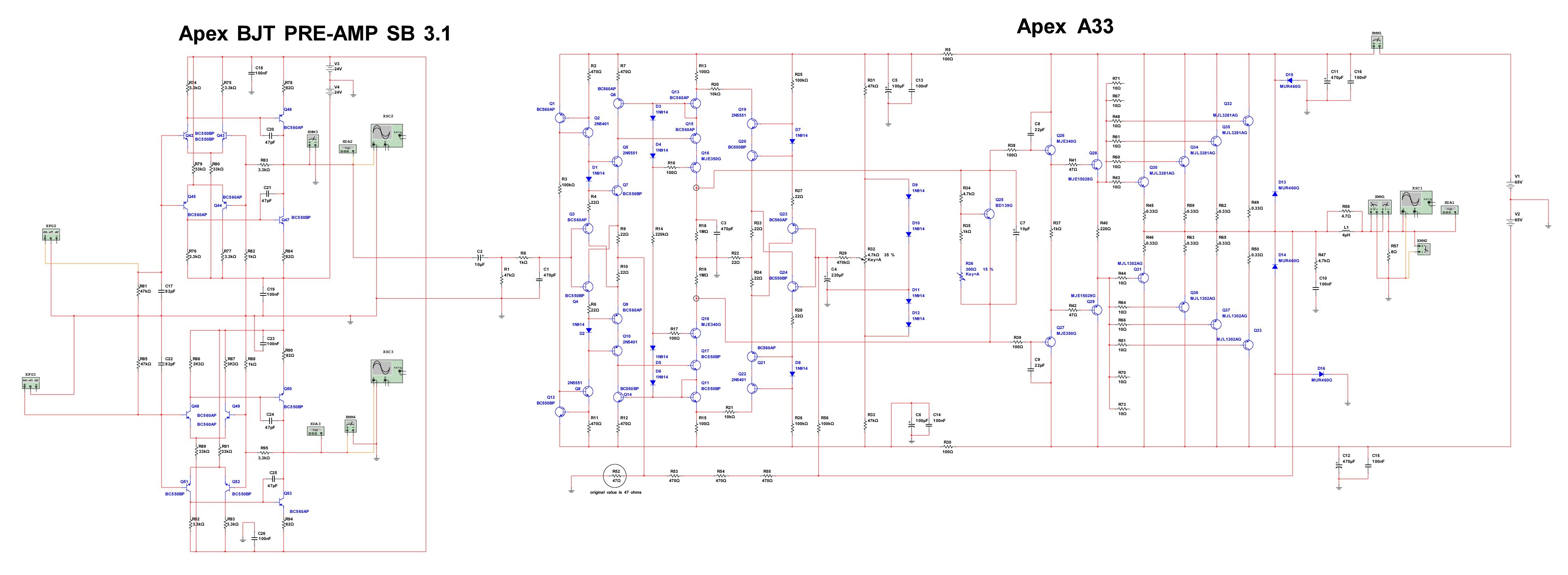

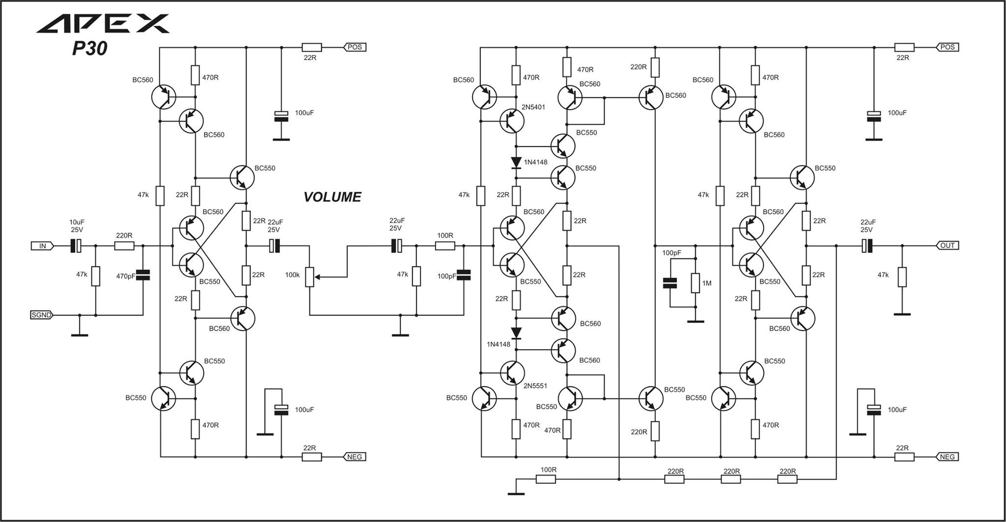

P30 is preamp made for A33

In what post is the P30 mister Mile ?

I found the P30 schematic

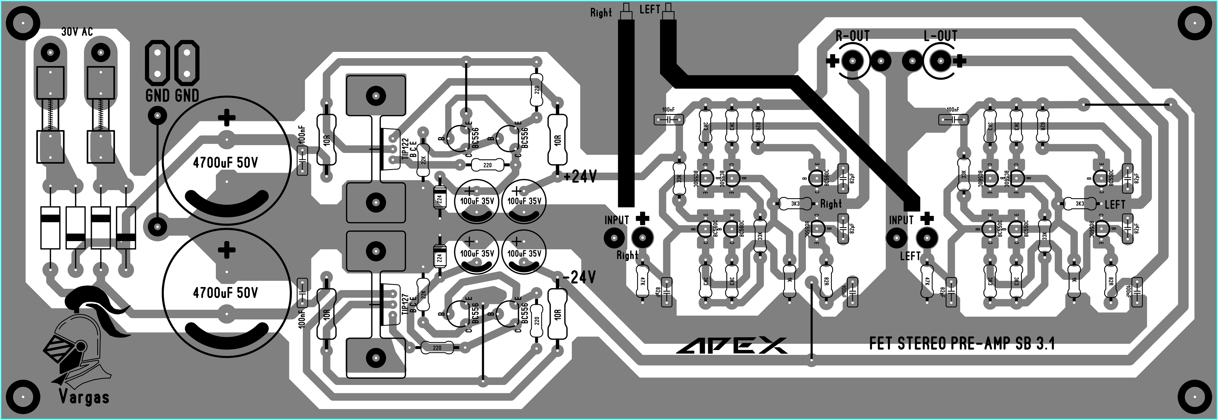

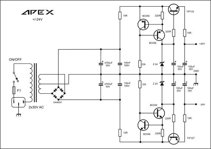

Use this simple psu for SB3.1

oh thanks

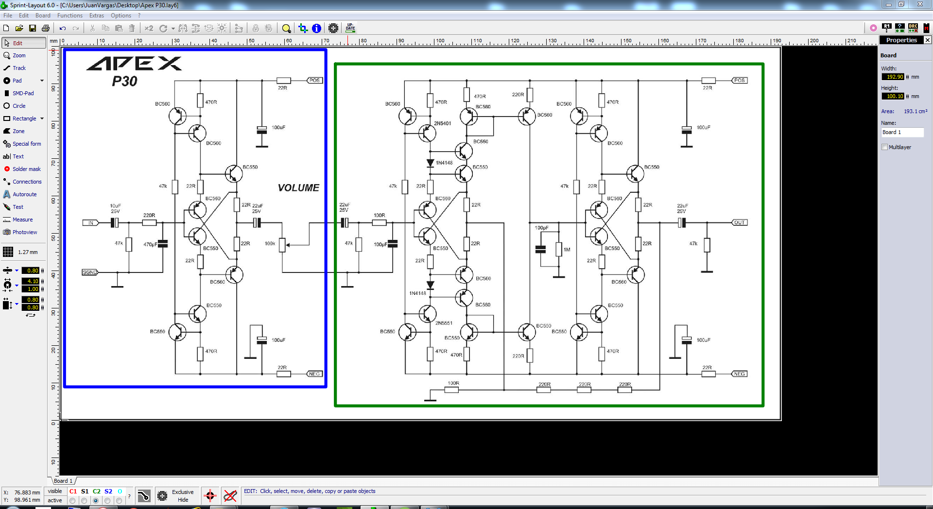

Sorry that I post too many times again one last question of the day, on the P30 is the whole circuit or only the highlighted blue part of the circuit or both circuit blue and green ?

Whole circuit is preamp, blue is input buffer and green gain stage.

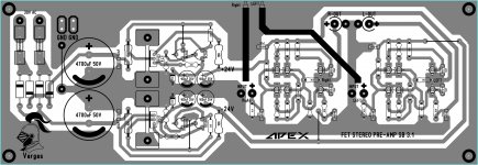

Hey Terry
you where looking for a preamp ? this is not the same as the one you was looking for and I think you might want to try out, it came out too big but I think is better because that will make it a lot easier to etched the traces are lot thicker than usual I mean if you want it to try out, let me first check everything a couple of time before I post the PDF files, here is the image
