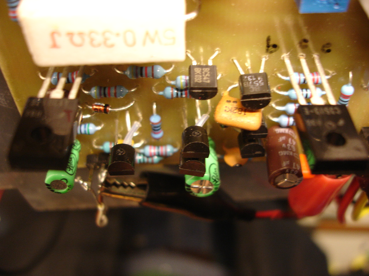

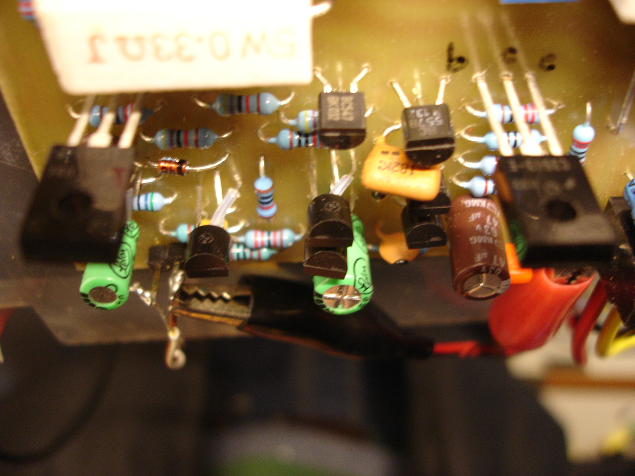

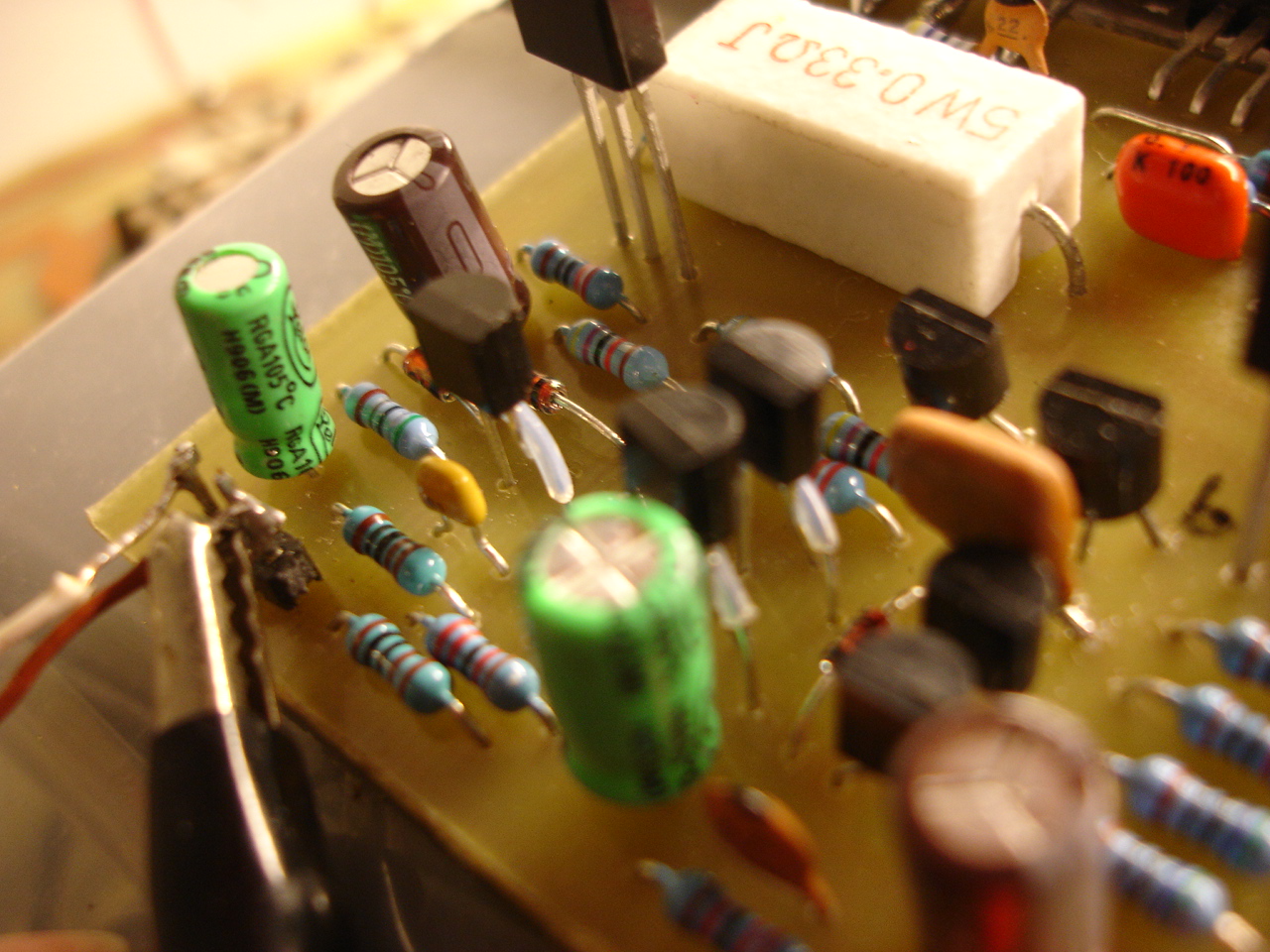

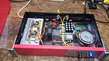

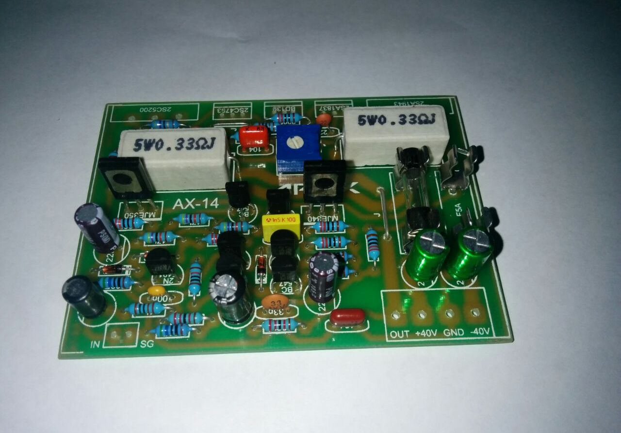

My new AX-14
Don't use these 2n5401 transistors!
I see using here a970,amplifier is more musican.
In VAS stage i use ksa1381,ksc3503.
Pay attention for wrong pin placement only!

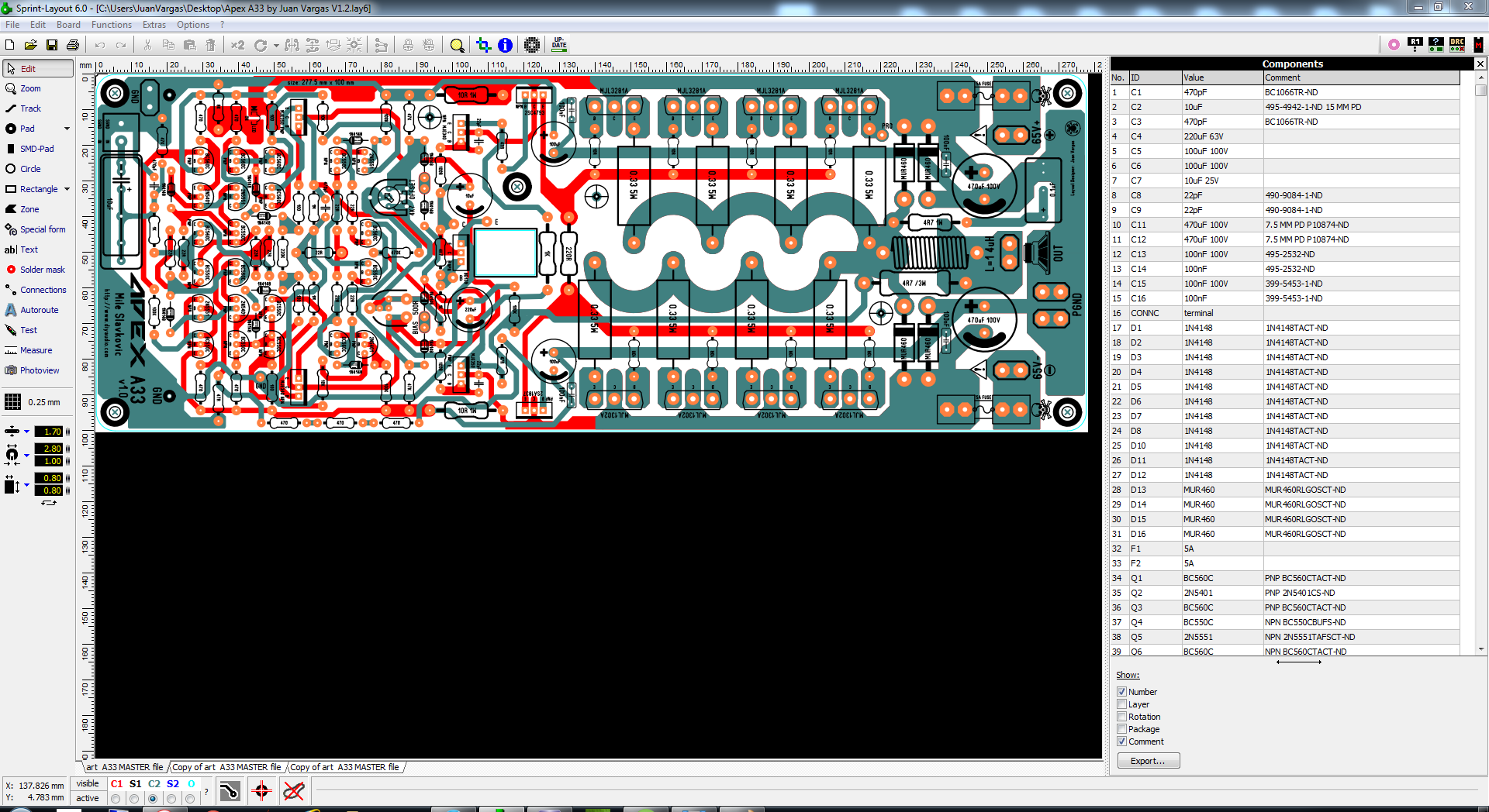

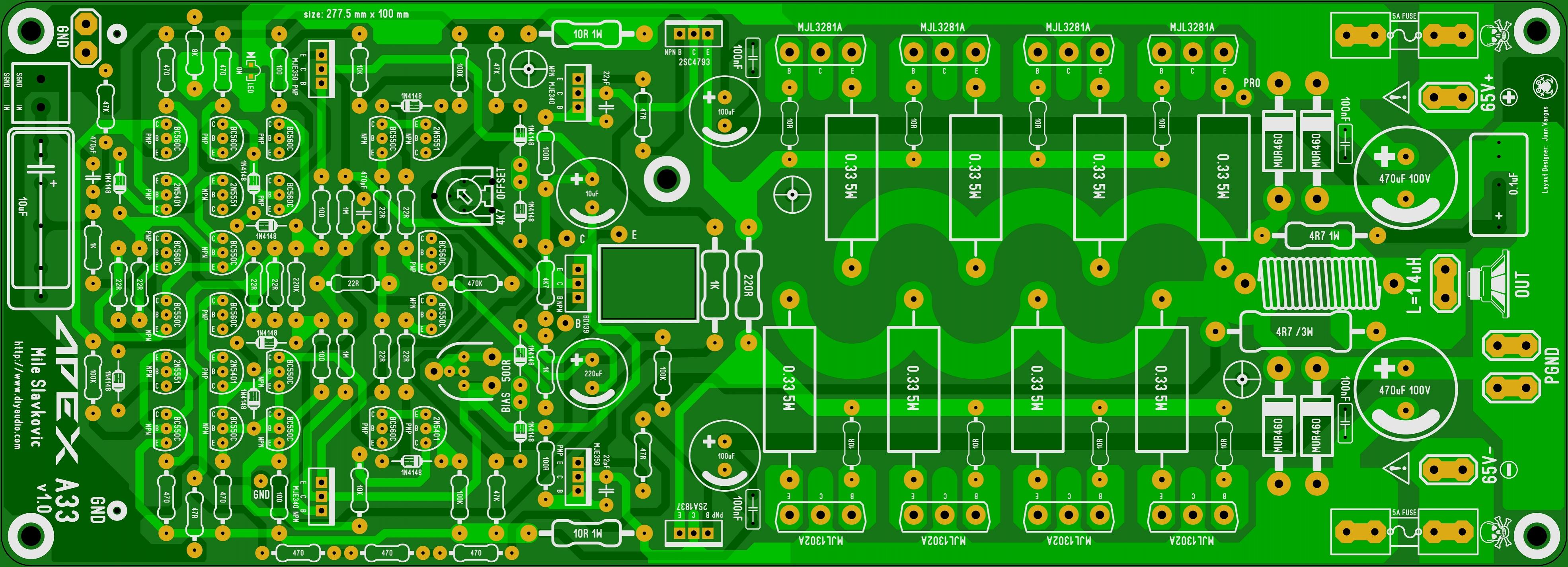

Hello guys I still working on the A33 project and have made my mind I will order a small batch for myself " I will personally make a risk of my own, I rather have an error on me than share the file and some one have the error " so I will continue checking the layout there is no hurry on doing this re-checks over and over I will take my time on doing this, so far I just tweak it a little bit, and I'm identified ever single part that is on the layout to make sure is correct, as you can see on the Sprint Layout image, also there is not changes on the original schematic I'm fallowing the original schematic as it is, the only difference is that it will have 2 more pairs, and the adding of MUR460 diodes and some other components :) same procedure I did to the AX-14T basically :p
yes this time I write a little bit more jejejejeje :D
here is the video of my studies
https://www.youtube.com/watch?v=v5Wc0sGyLrQ&list=UUEV_-UcnVM-o3KnQe6nemTQ
Regards
Juan
