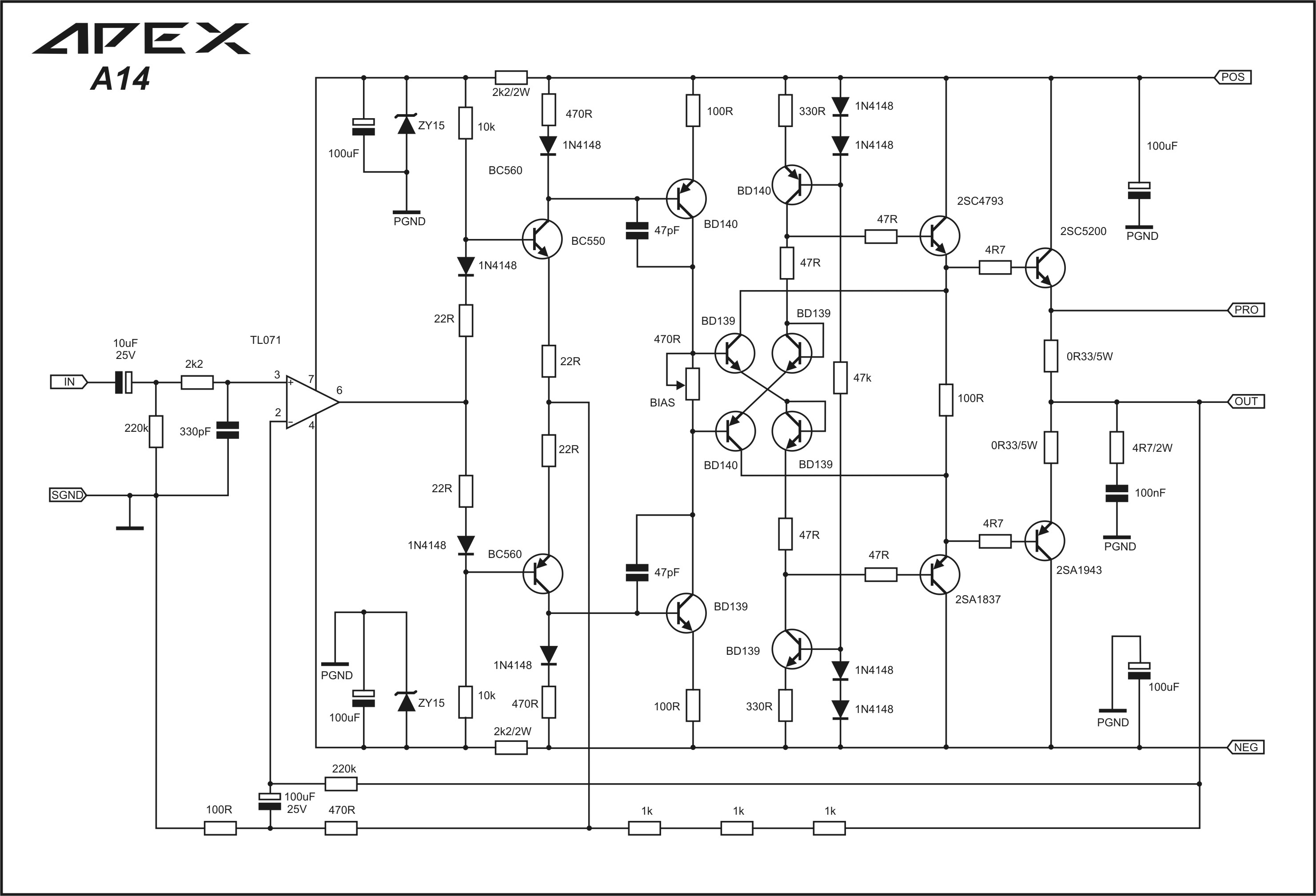

100W Ultimate Fidelity Amplifier

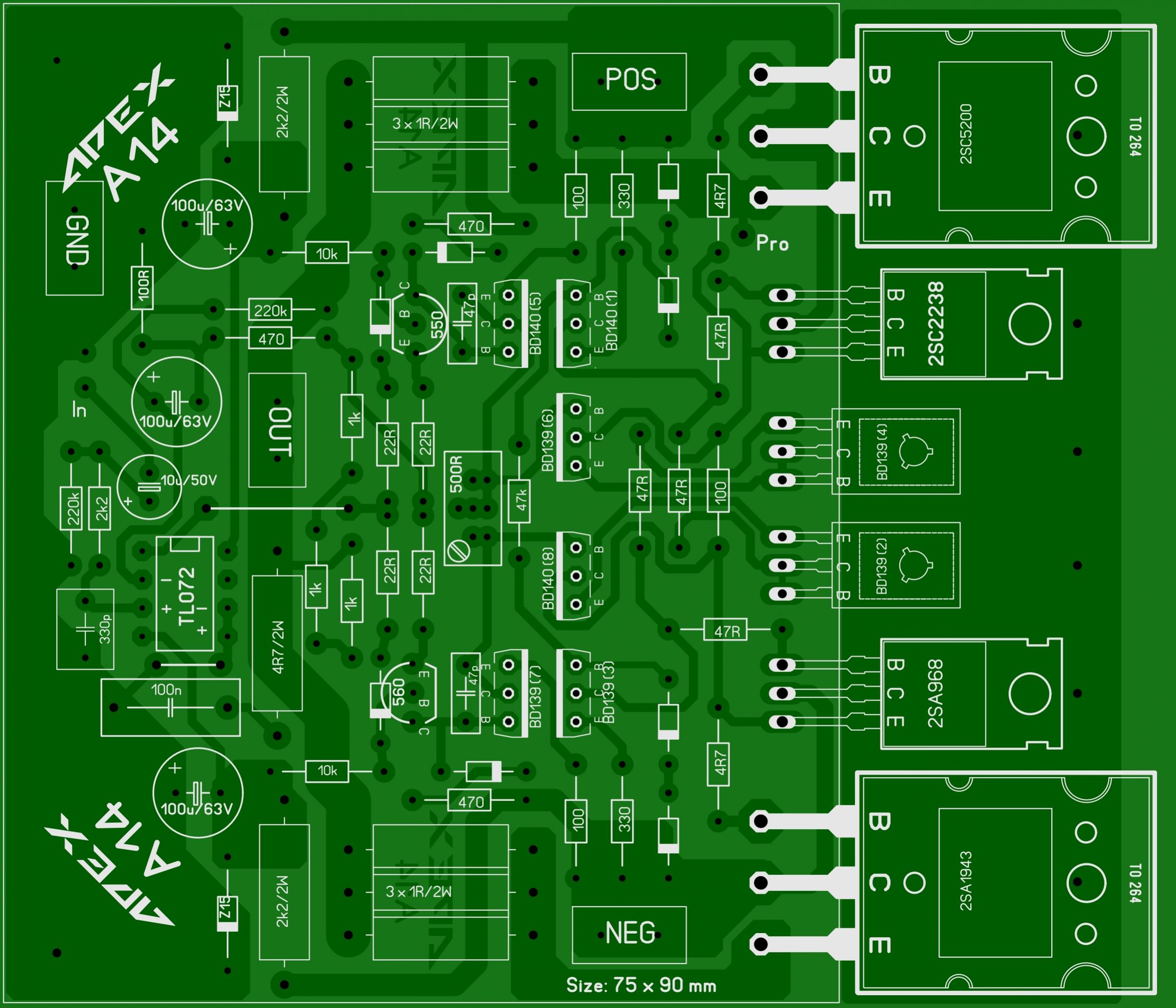

A14 Prototyp Board

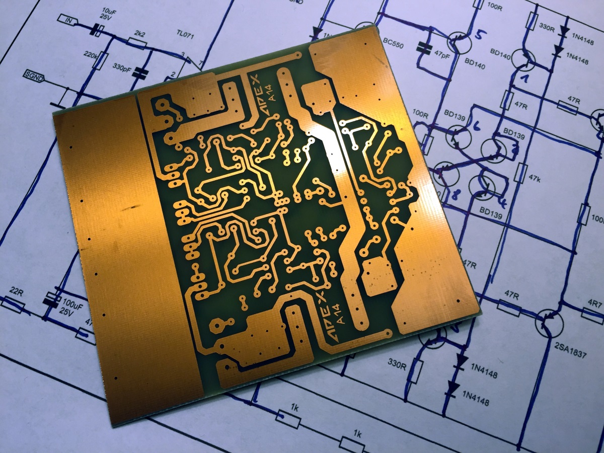

Here we are.
Lots of errors eliminated and etched a prototype board (picture fresh from etching).
So we will see in the next few days if everything is correct.
regards Olaf

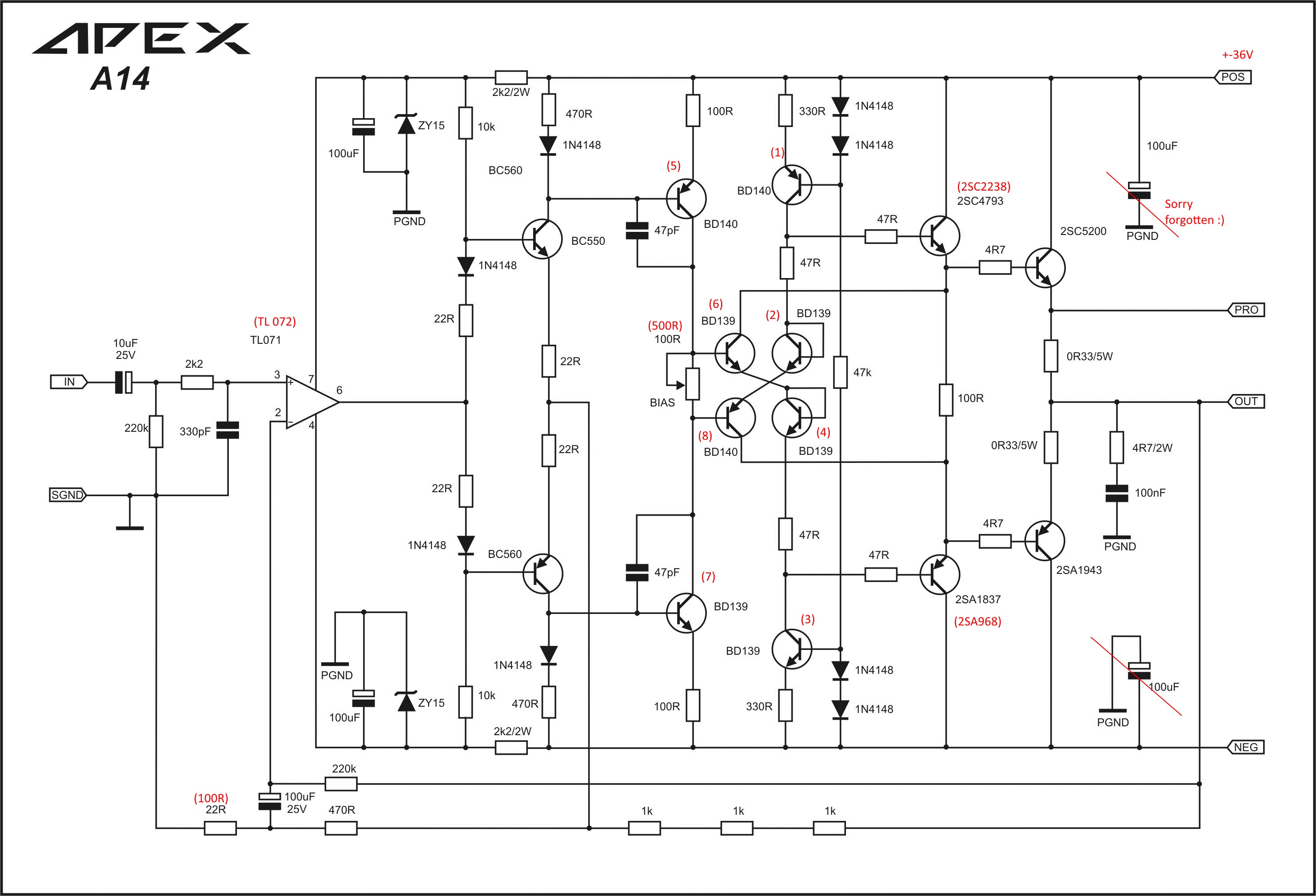

Ok, it's already tomorrow ... (at least in Germany :)).
Here are the print files and a schematic with the changed values. The transistors are numbered. So they can be found better in layout
regards
Olaf
  • A14_ComponentView.pdf
  • A14_Mirrored.pdf
