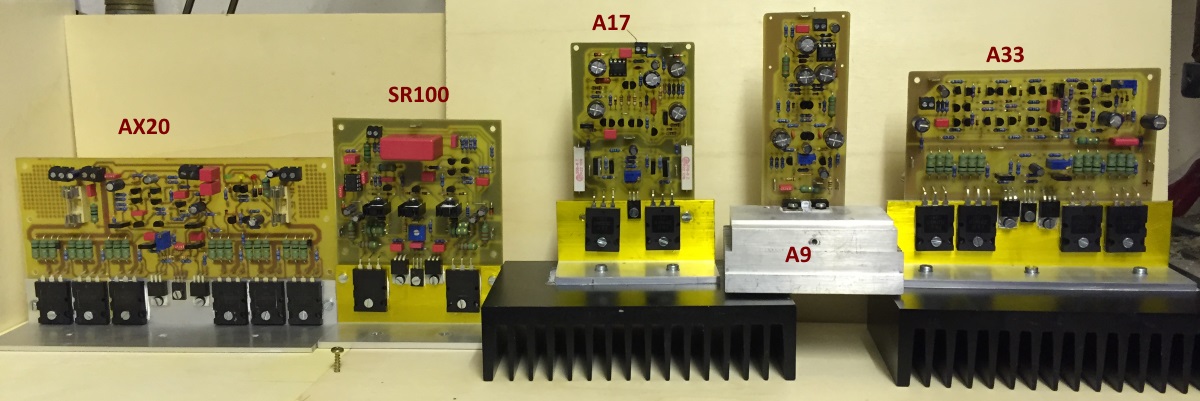

Here are my last amplifiers. There is not one in which a capacitor is more on it as in the specification of Mile. Please be careful in the choice of your examples.
regards Olaf
