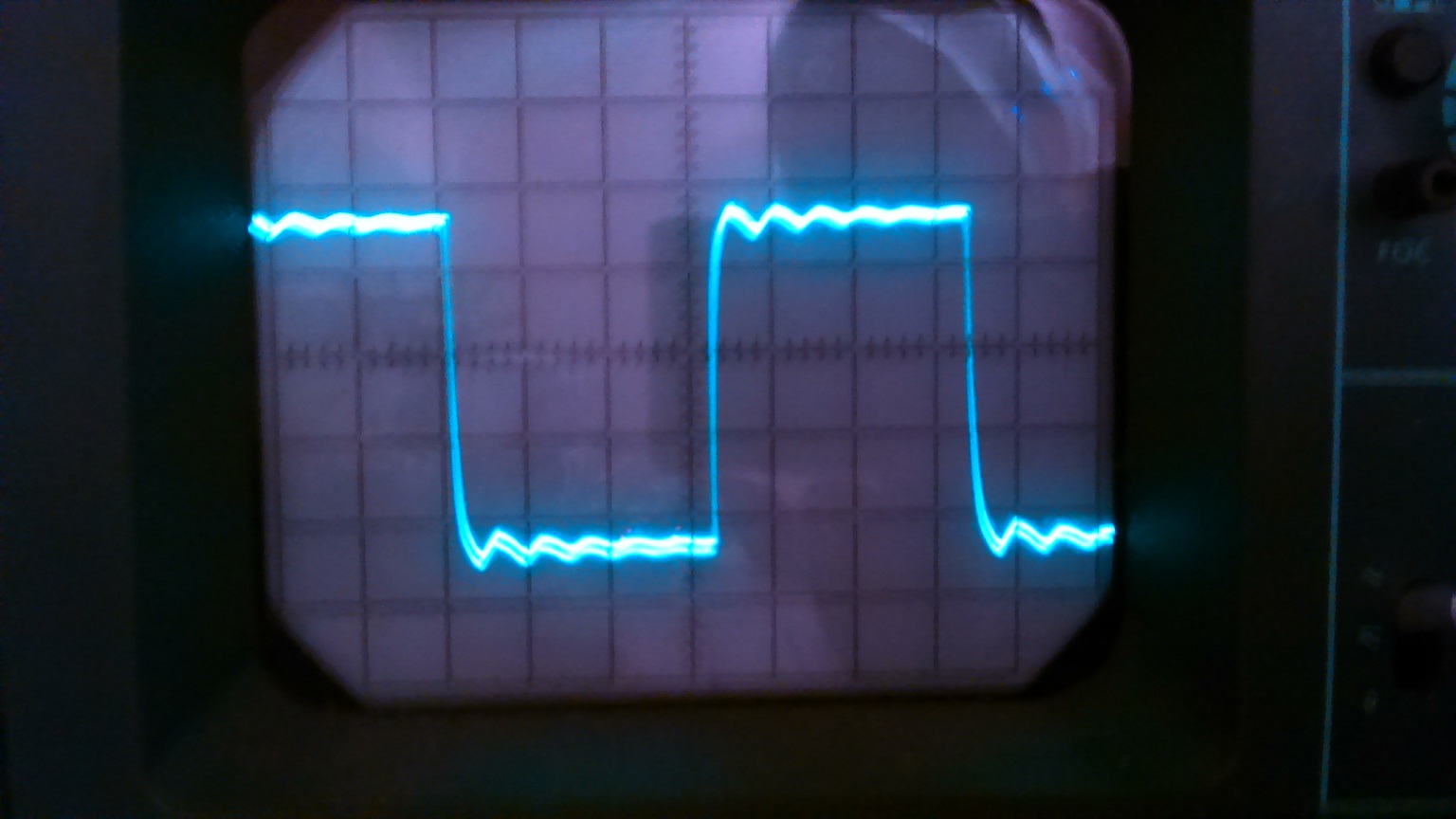

A23 test 15kHz 1V/div 8r with 470nF in paralell.

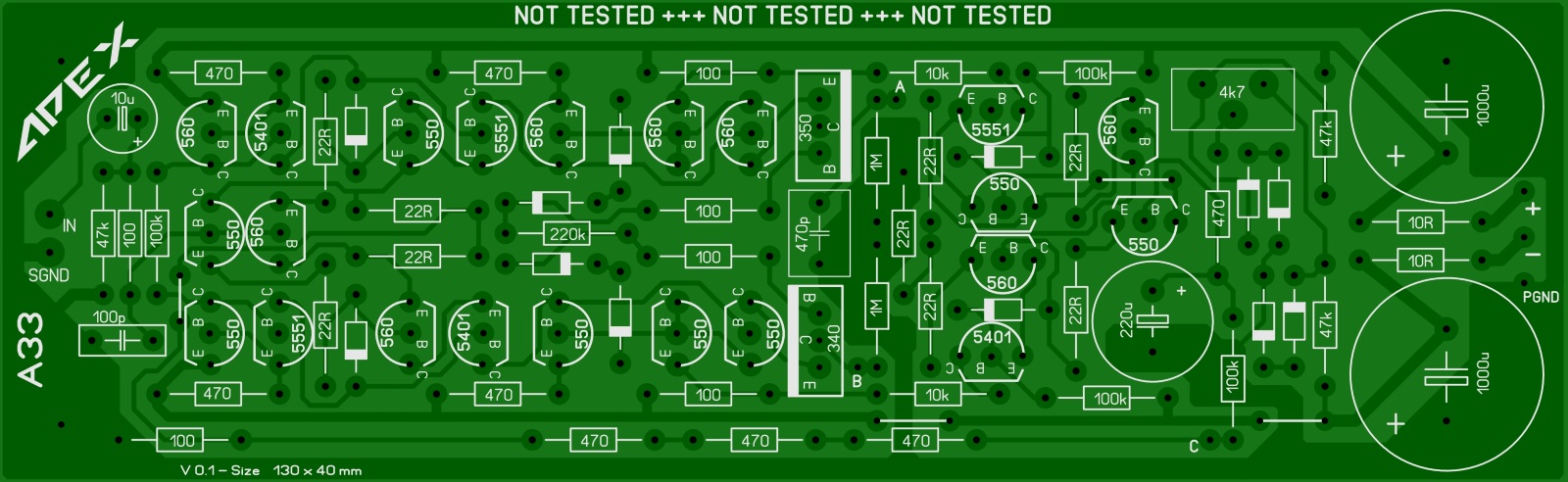

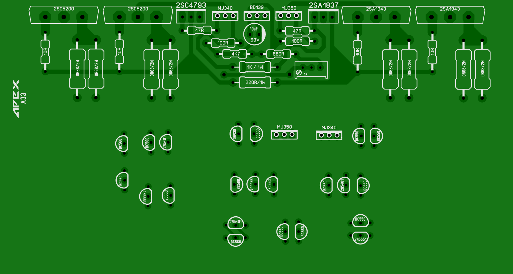

Hi, I started to design a layout for the A33. This is the very first draft for the input stage. I do not know if it's a good idea to share the PCBs in two parts. This gives a better handling during the test. If everything works out, we can make a complete PCB. Recommendations very welcome! Maybe someone can look at the design, I have to double check everything.
Regards Olaf
Regards Olaf
