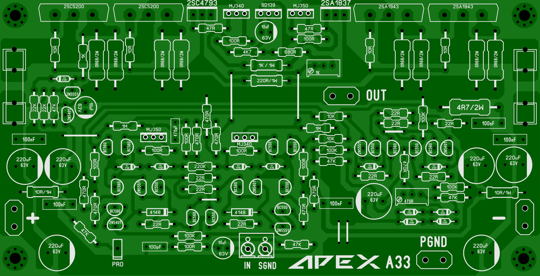

It also goes without wire :).
regards Olaf
Hi Olaf you know more about PCB design that me, but I've been told its better to move the speaker out terminal close to the NFB resistor track on the left hand side of the PCB where the 470R resistors connect to the output trace.
Thicker traces will also make toner transfer easier.
I'm not sure how important this is, but just some advice that was given to me.
Hope I'm not out of line making comments.
Regards

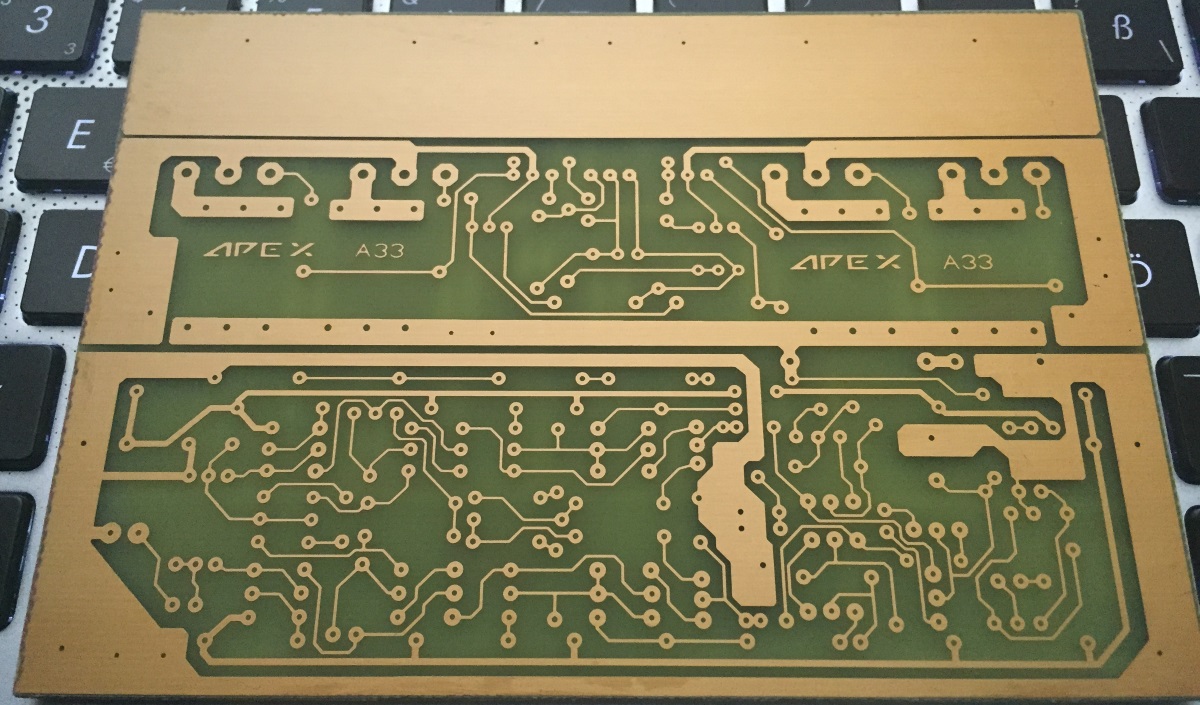

Thanks for the advice. Every time really very welcome.
It is only the very first version to get a test. All the points that you mentioned, still need to be considered in the final version.
But after a last check I could not wait any longer :)
regards Olaf
