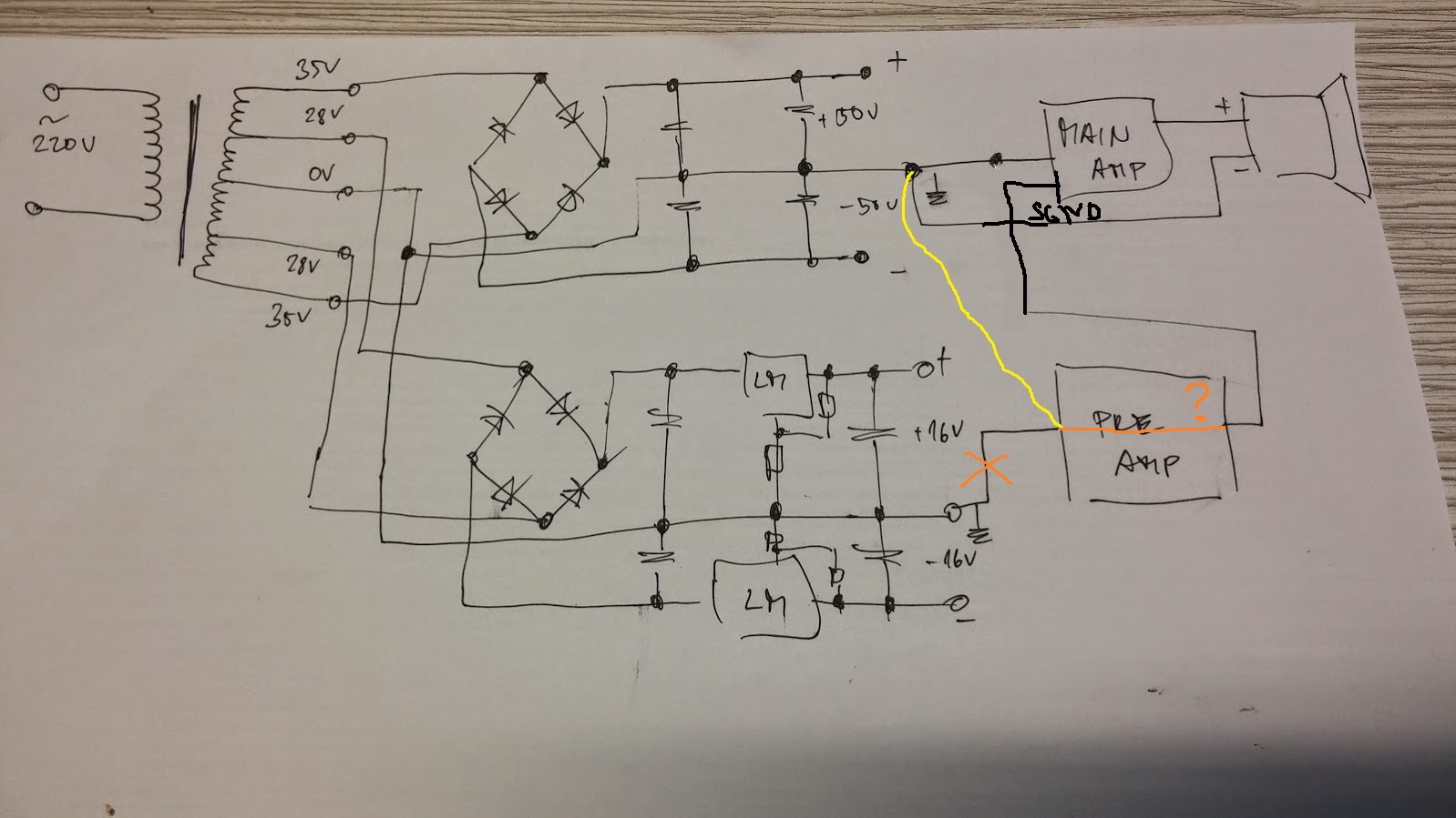

So I am done with this amp.. I used preamp and transformer from original.. for premap was used dual PSU with LM337 and 317 ... I need solve problem with very little hum.. any idea with grounding , because there is no ground wire.. (two wires only for 220V)

There is no earth wire (earth and ground is different), you need star ground for preamp psu ground and amp psu ground... nice work anyway

yes i Know...I usualy using this schematic:

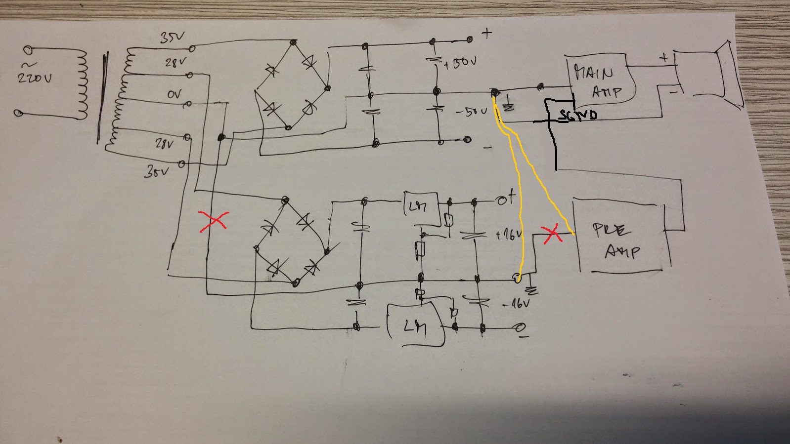

It's schematic ground to chassis conection, can you post your ground wireing (preamp psu gnd, amp psu gnd, preamp gnd, amp gnd, input gnd, speakers gnd conections)
this is correct

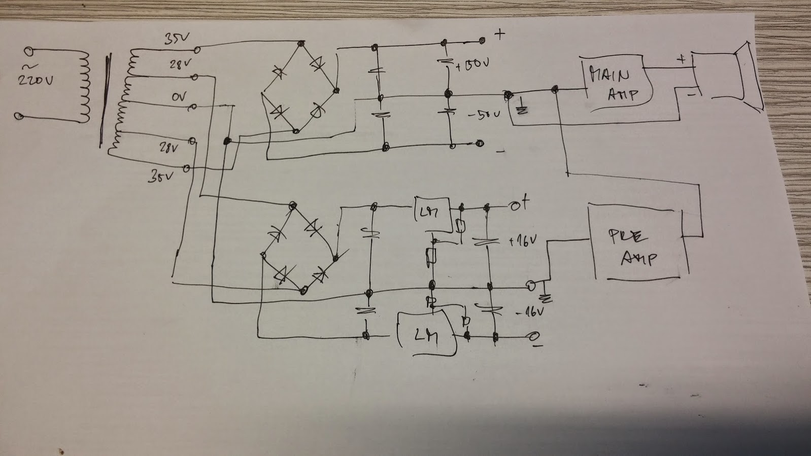

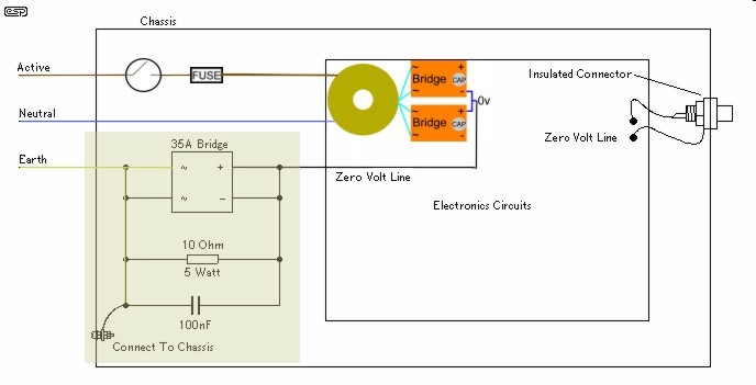

Star ground
Do not connect the PSU "charging circuit" through the main audio ground. NEVER !!!!
The AC twisted triplet from secondaries MUST go to the first smoothing capacitors.
The DC twisted triplet from the LAST smoothing capacitors MUST go to the amplifier.
This applies to BOTH PSUs.
3648 is correct. I note there is NO CONNECTION between Speaker Return and Signal Return

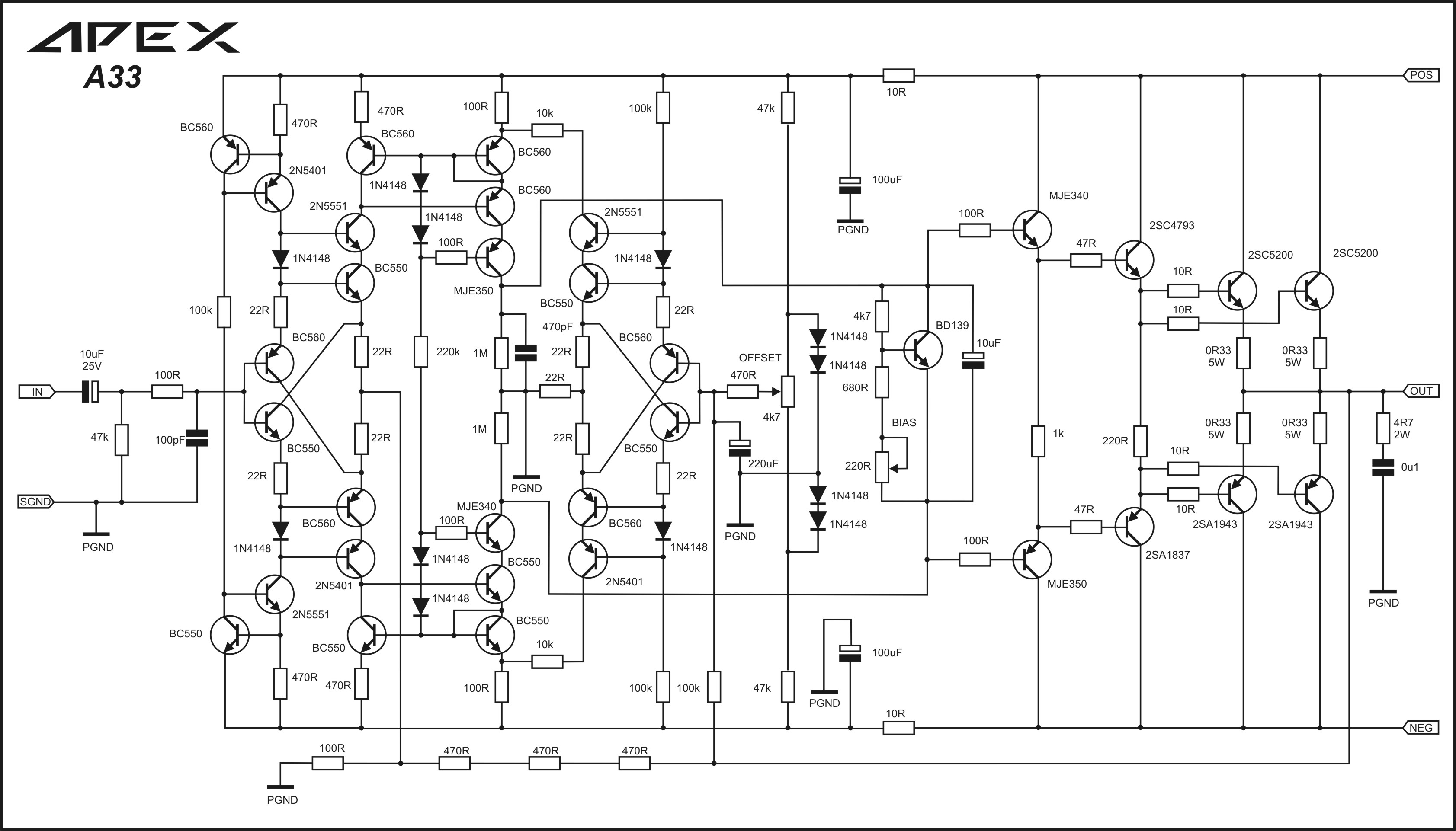

Your A9 with NJM2068 sound good, A17 must be upgrade.
Regards
Do I need changes for running A17 with +-50V DC (because I have some of nice +-36V AC-transformers in the shelf)?
regards Olaf
regards Olaf
No changes, but you can increase gain: use 47R instead 100R in feedback loop.
