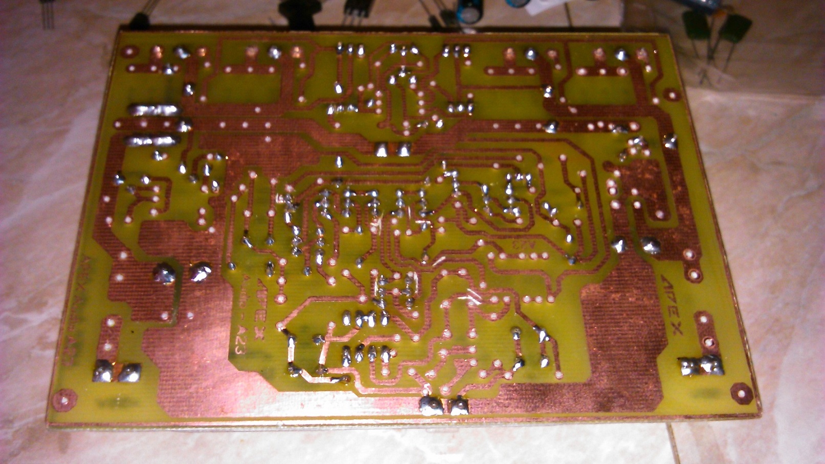

Nice! will you attach the foil?
For sure.
But not before PCB is checked. Was to late this evening.
regards

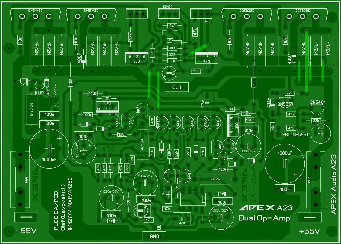

Much success with the A23, great layout - I'm very curious about the sound .
regards Olaf

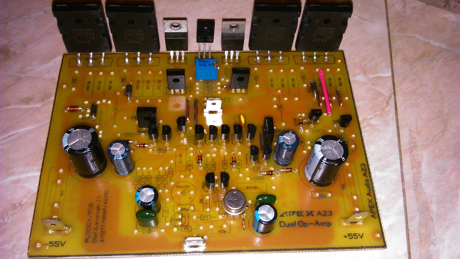

thanks Olaf,most of it was your work (A17 and A20tef) only adjusted to fit A23 good luck with "flat amp"

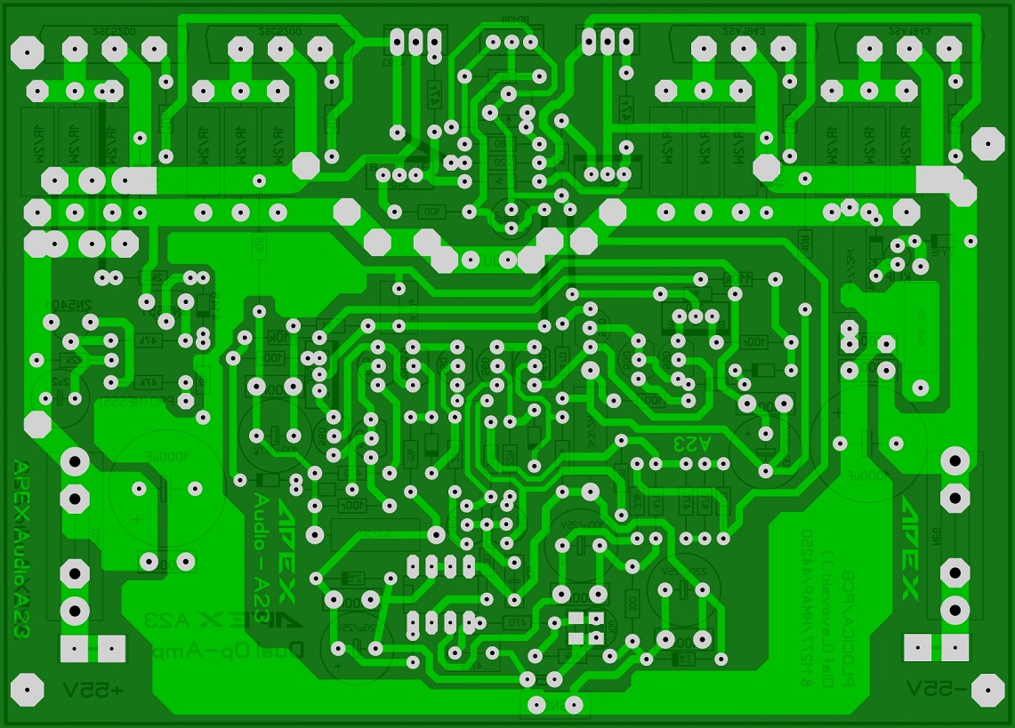

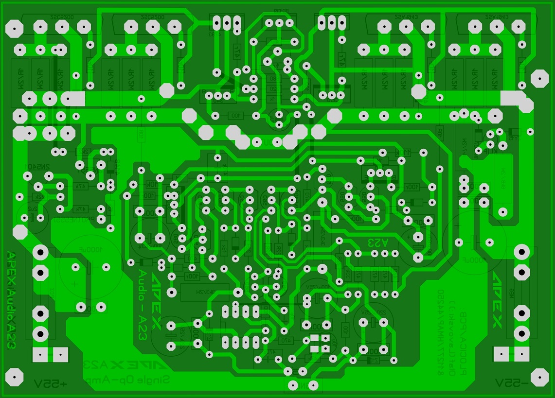

138x99mm,with single and dual op-amp,Zobel network,PRO circuit to suite to NE555 protection,CLIP indication...

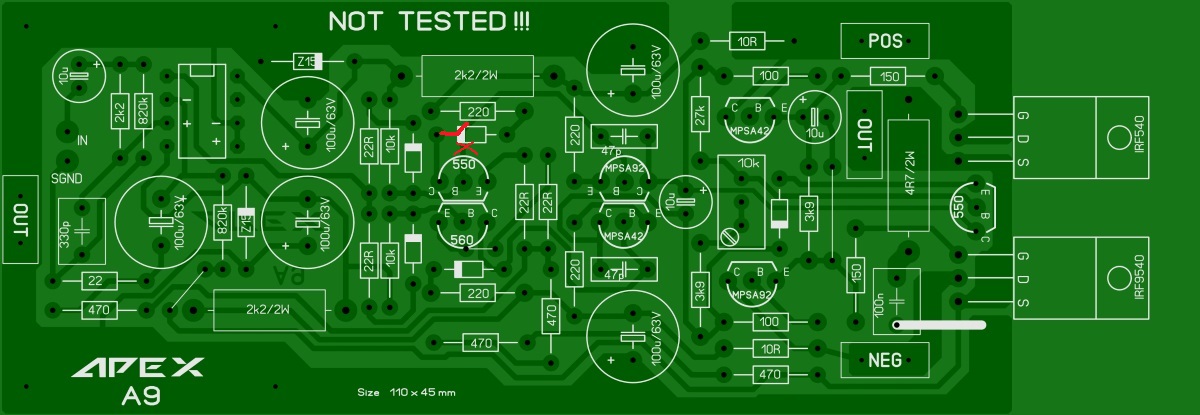

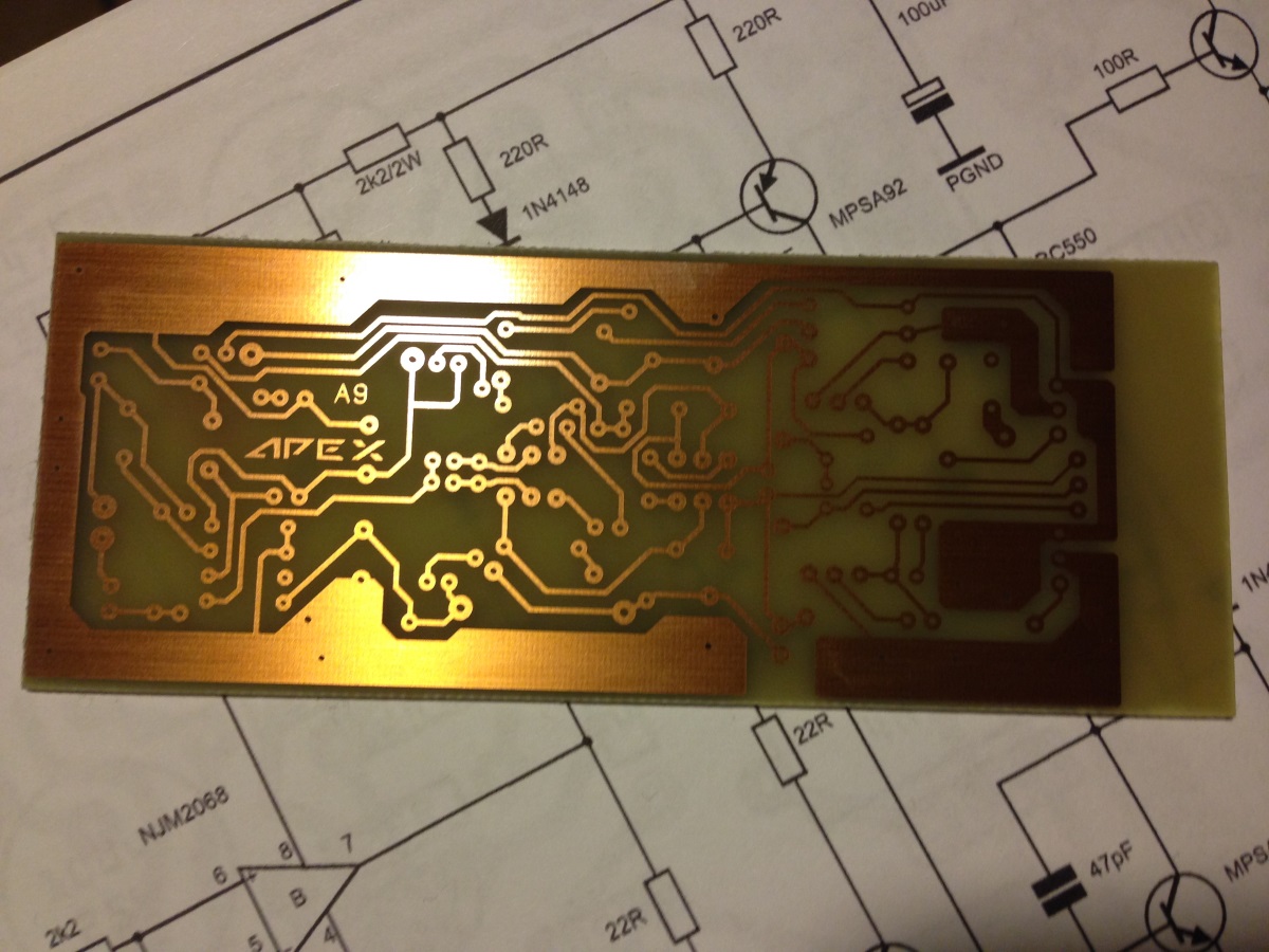

Here the very first design for the A9. A little bit unusual format, but enough for a first test . Could be a little flat amplifier.
Not tested - coming weekend. Notes gladly welcome.
regards Olaf
Very nice pcb, I use it instead of mine,
Regards

Nice work,
Regards
regards Olaf
There is mistake on your pcb: base MPSA92 must be conect to colector BC550 not to base... you can connect SGND to PGND (by mistake note as OUT on your pcb)
Maybe use a BD139 there?
No need, current is only 2mA.
Yes,but pinout will work as-is. How about a ksc1845 then?
Pinout is ok, track must be break and connect to BC550 colector as I mark on picture with red line.
Hello,
thanks for the effort and the information, I'll check everything again and build a prototype at the weekend. I'm looking forward to it.
regards Olaf

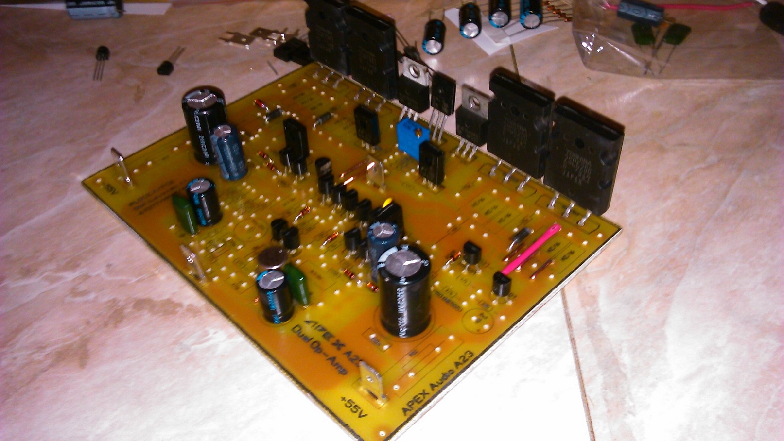

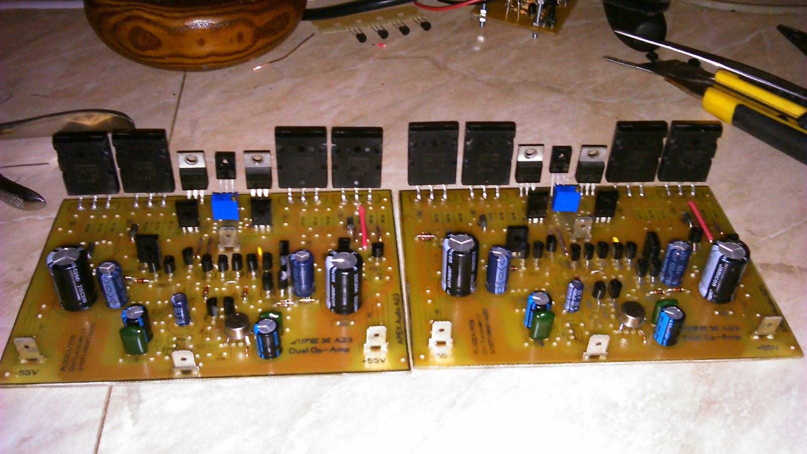

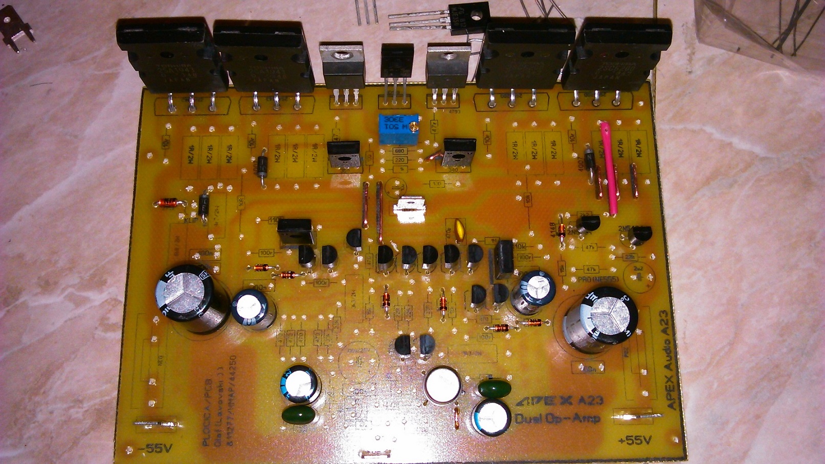

PCB - yet done quickly (sorry for the bad photo).
Tomorrow I have to work, but maybe Sunday ...
regards Olaf
Nice pcb, don't forget SGND connect to PGND,
Regards

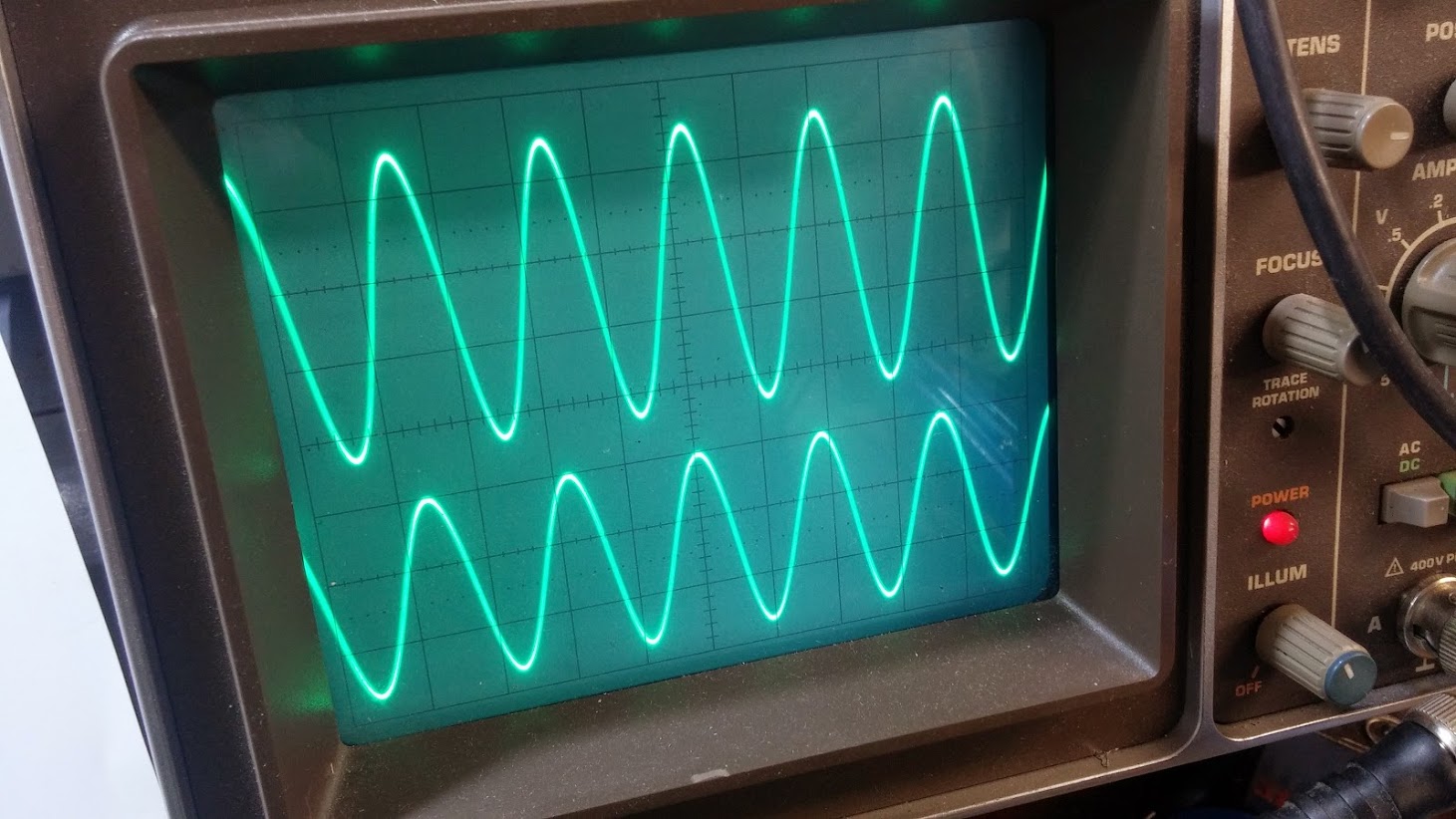

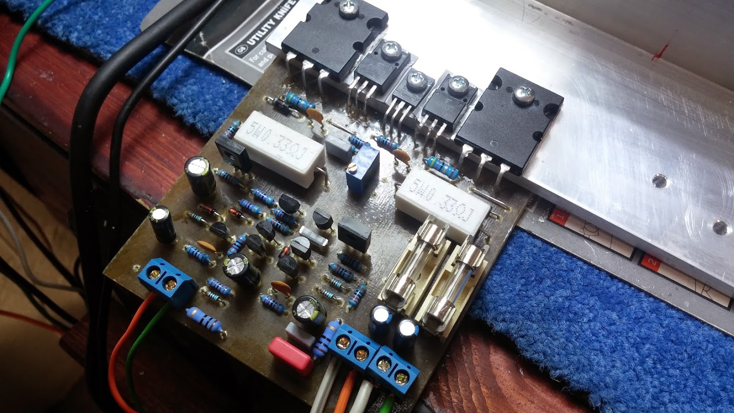

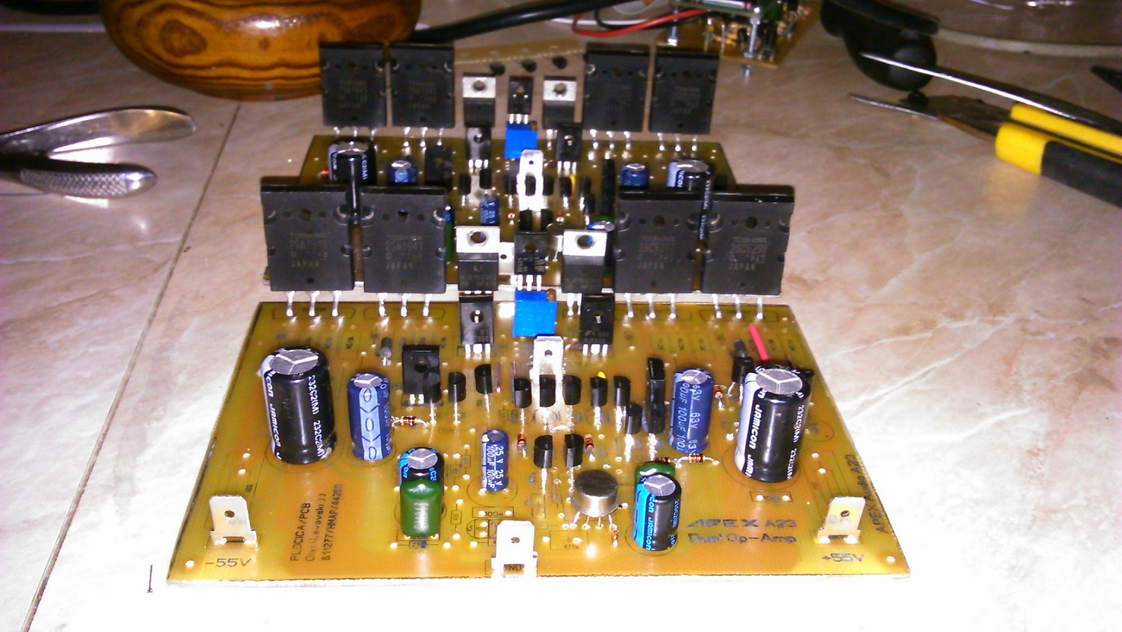

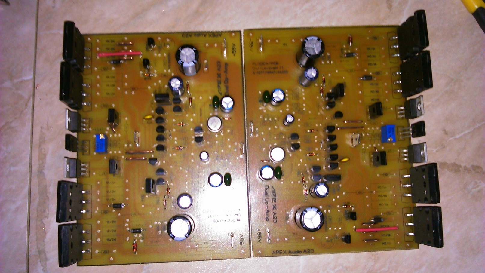

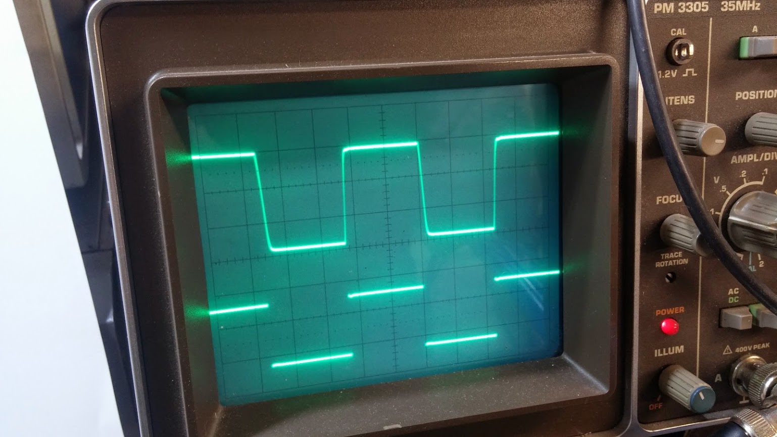

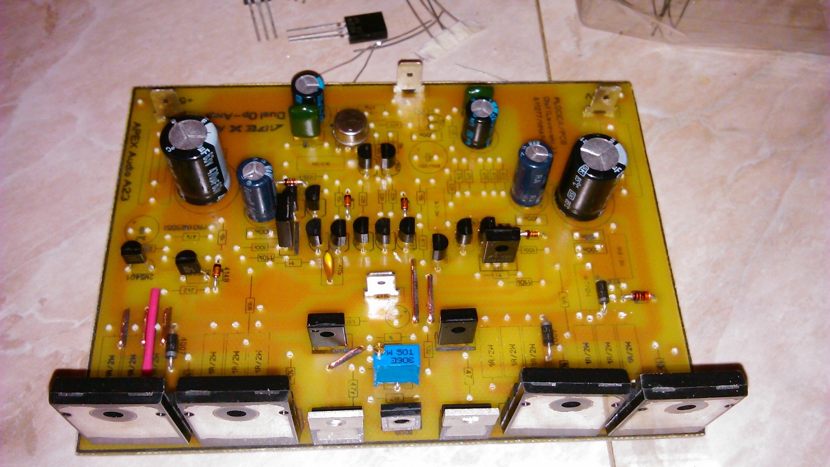

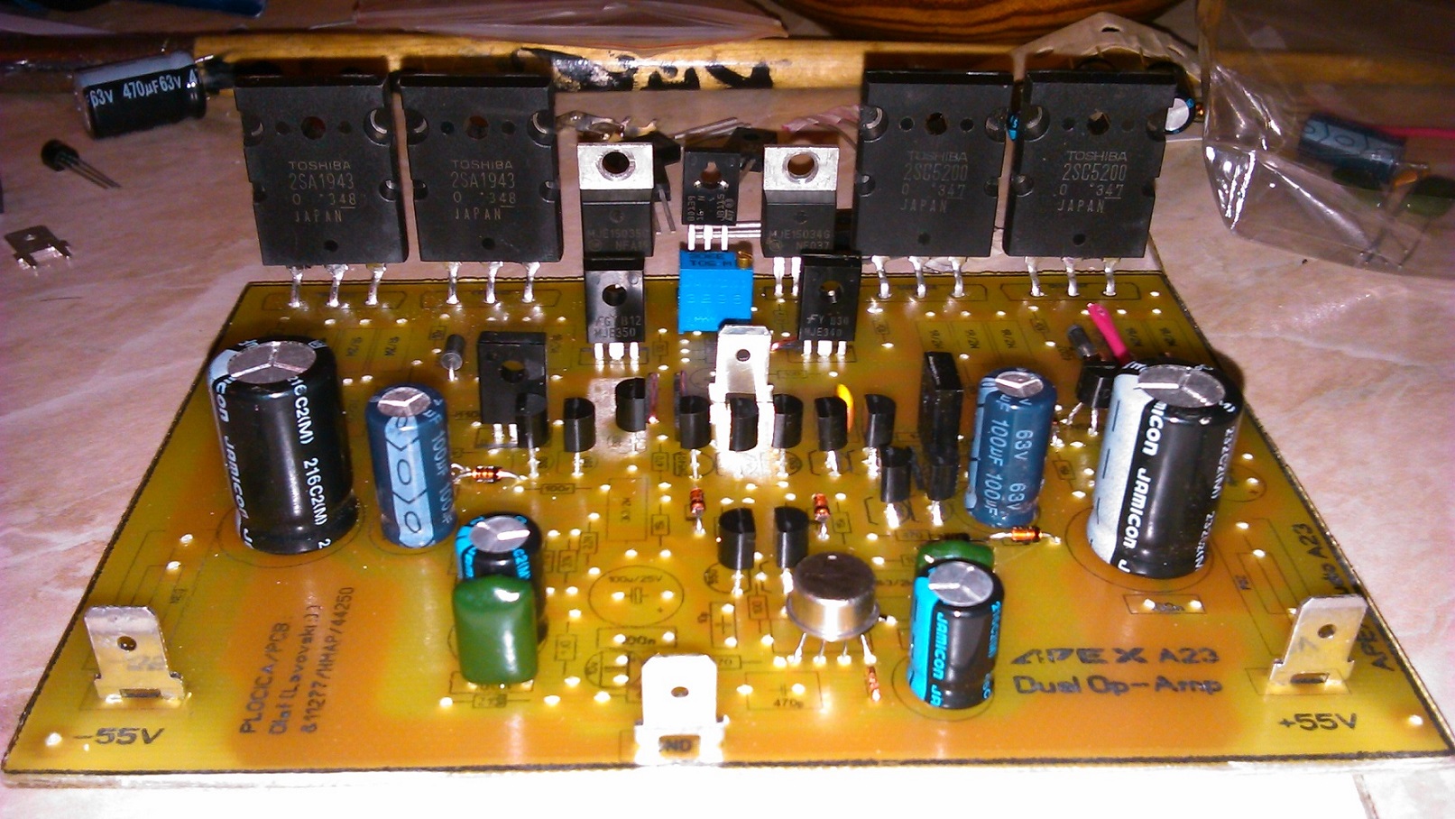

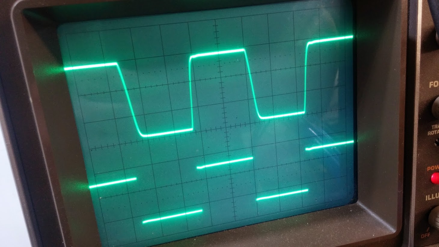

I already done with one chanel ...very easy to build, just need set bias and play.. picture show sine at 100khz, square at 10khz and 20 khz...
