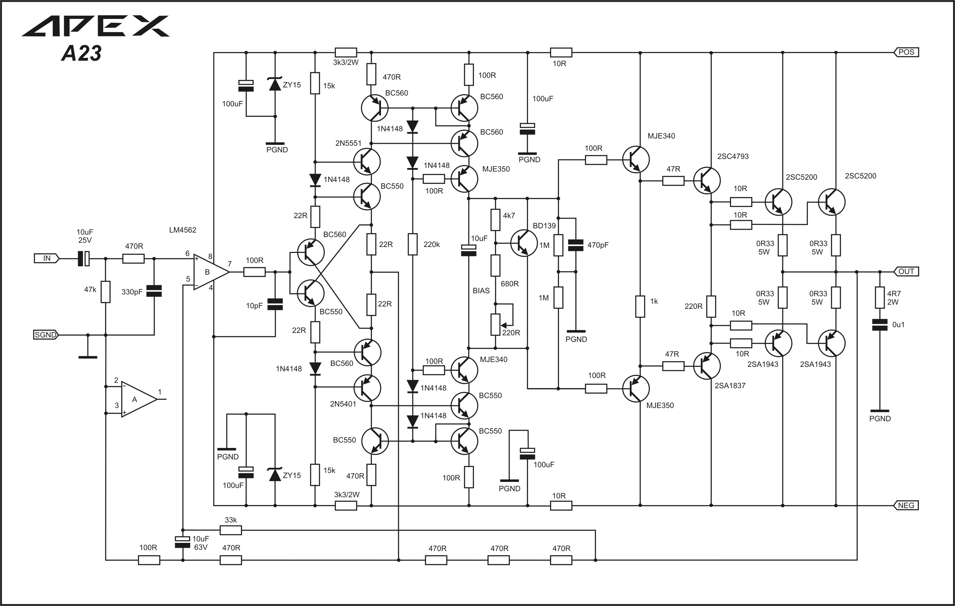

First try beginning with the input stage...
