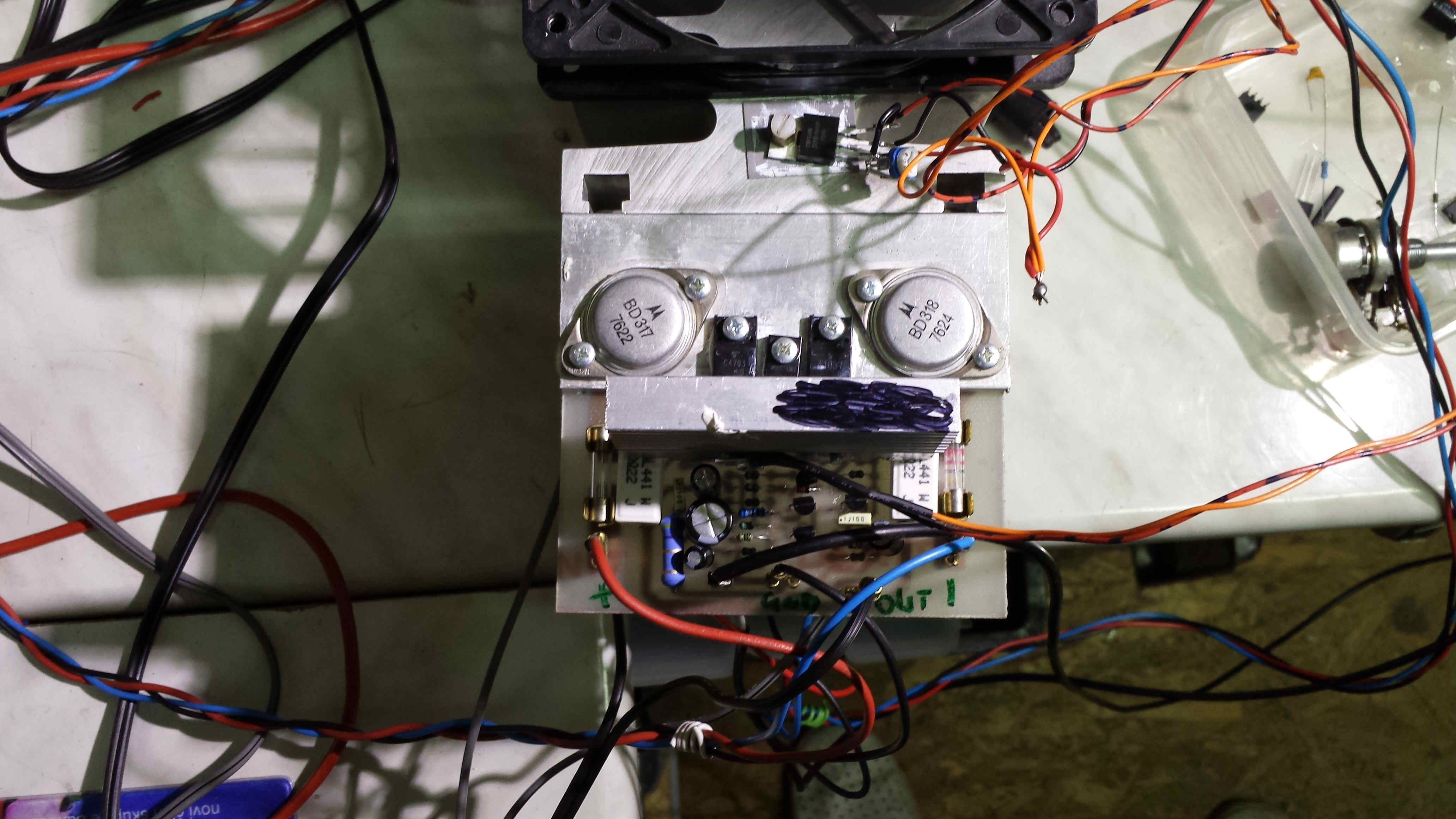

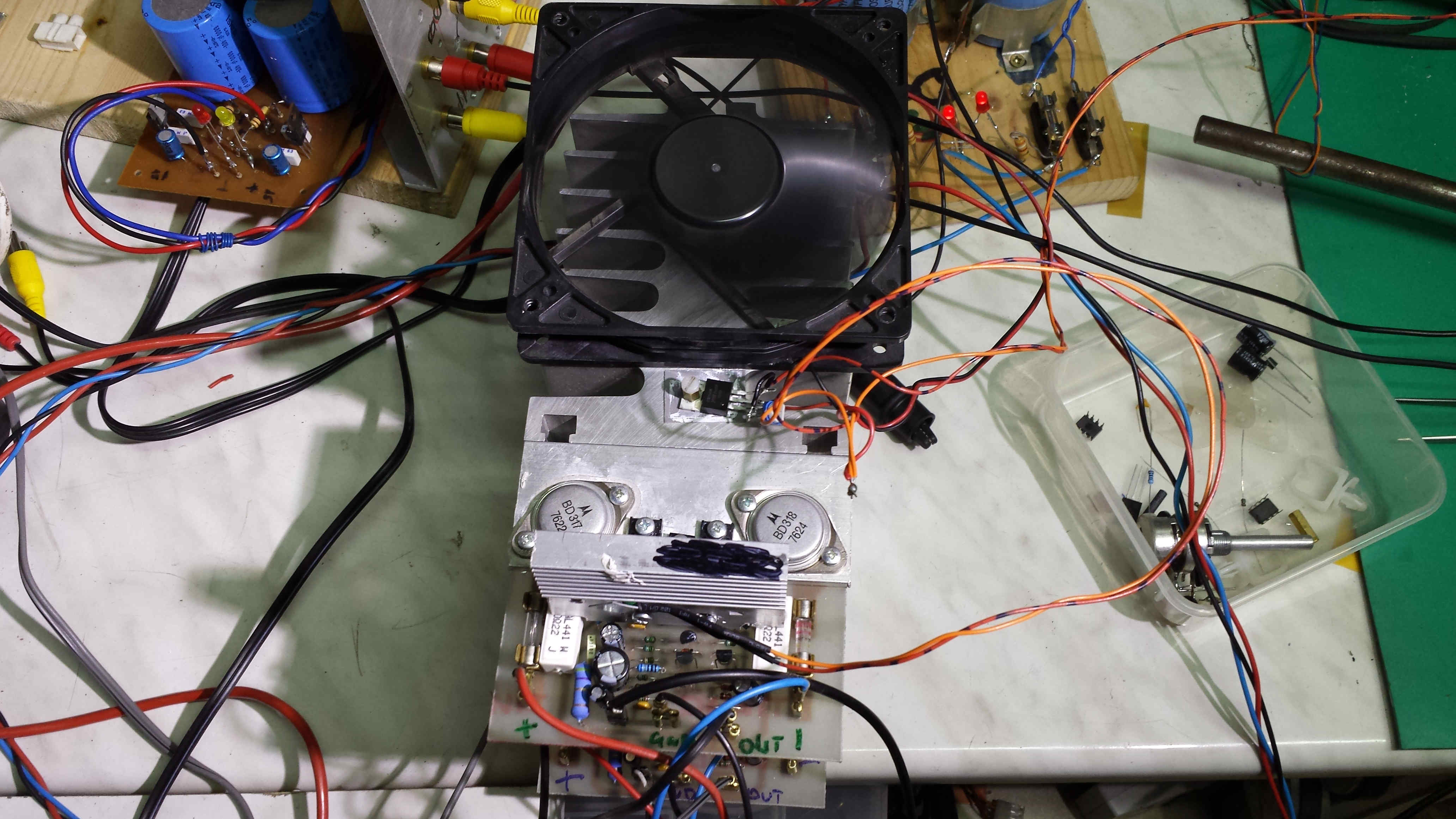

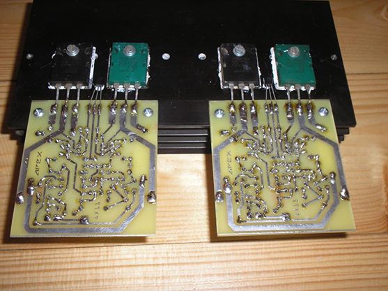

I thought so(the marking doesn't look good), but maybe it is original one...
I saw at post #3317 there are AX-14 also use jengkols (with better marking)

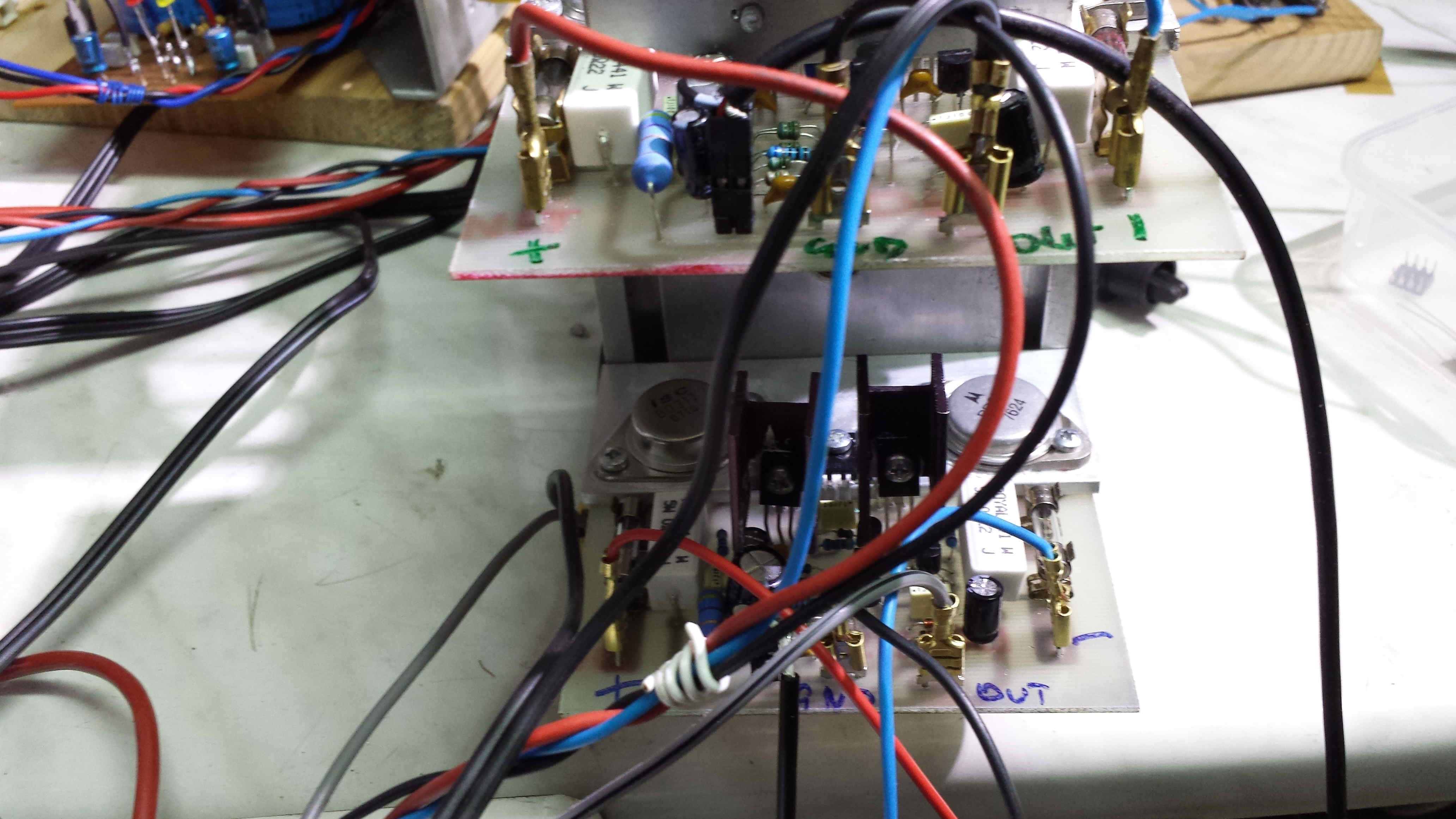

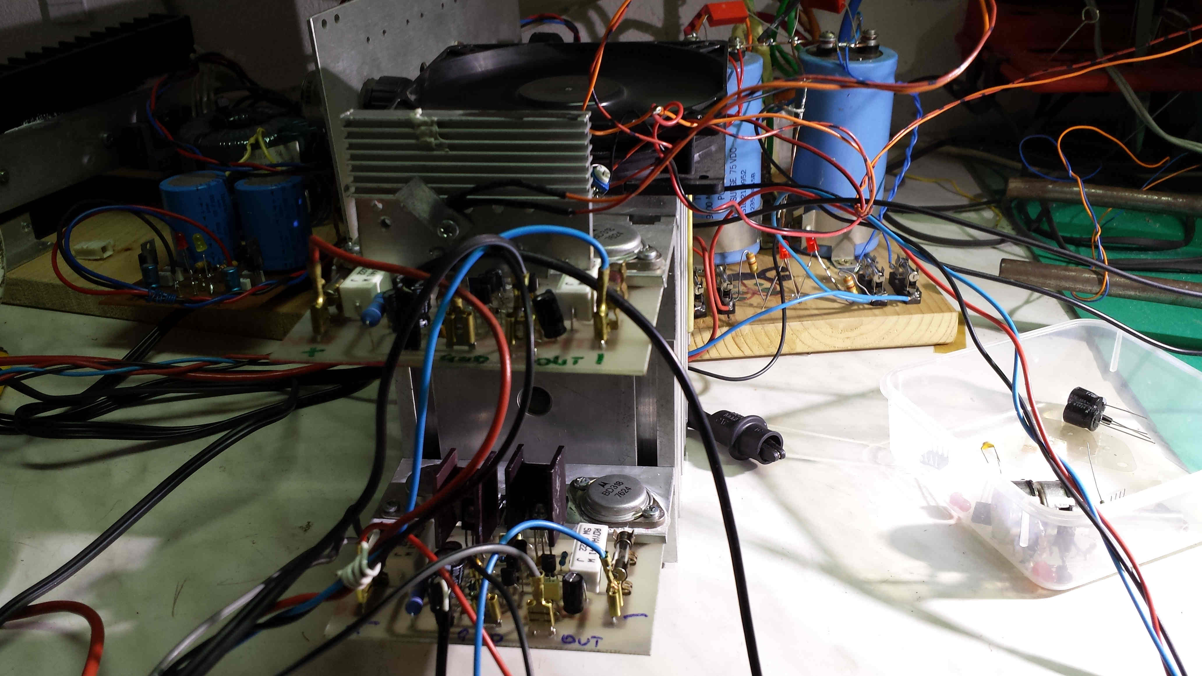

but don't worry I have spares some old motorola 15003-15004 if this one is blown :D
I will try at rail +/-55VDC for 8 ohm load, is it is okay?
if they were original I believe they wont fail :D it is worth to try
I just realize it ... & I will try to redraw it if needed :) & fortunely I have some LM4562 :cool:

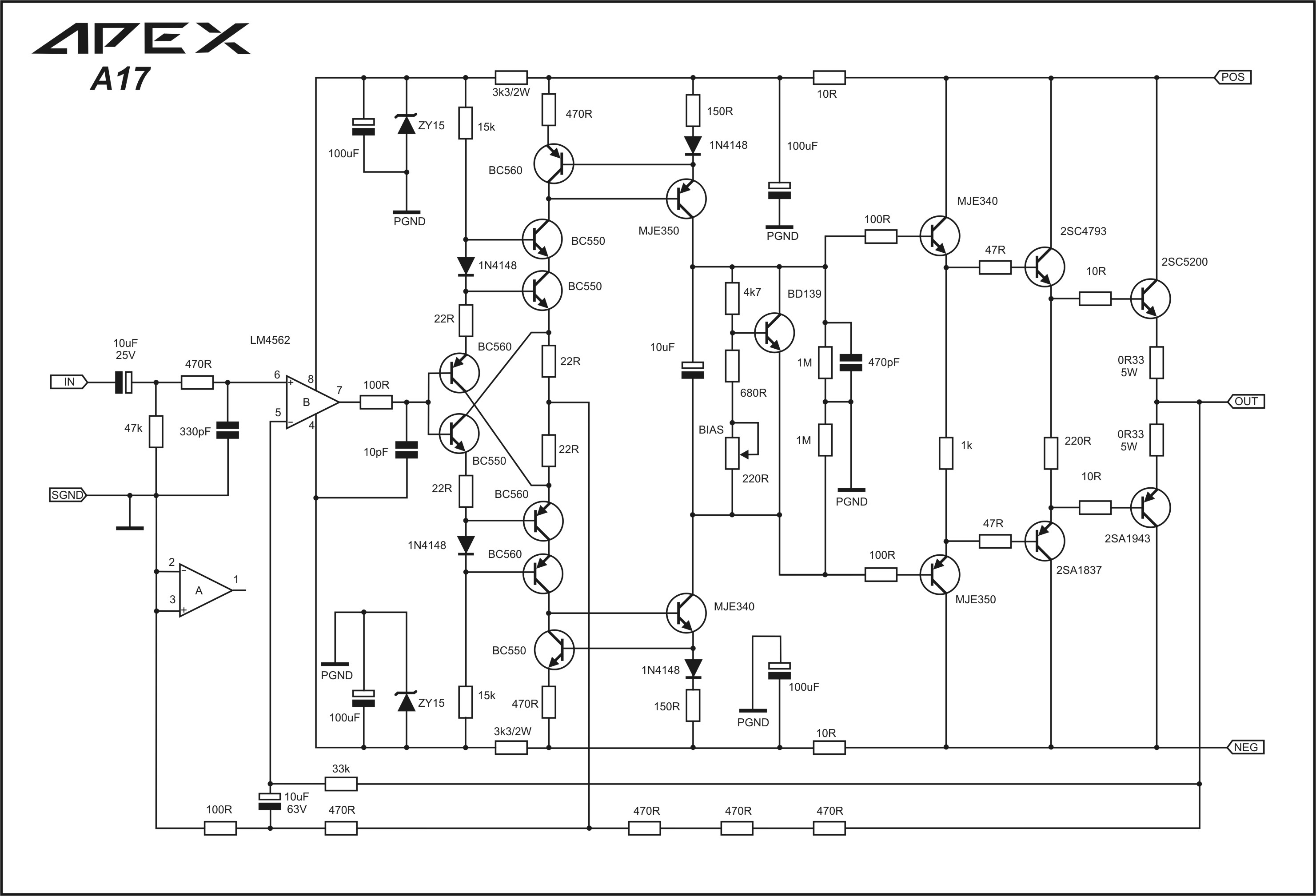

No need to redraw...

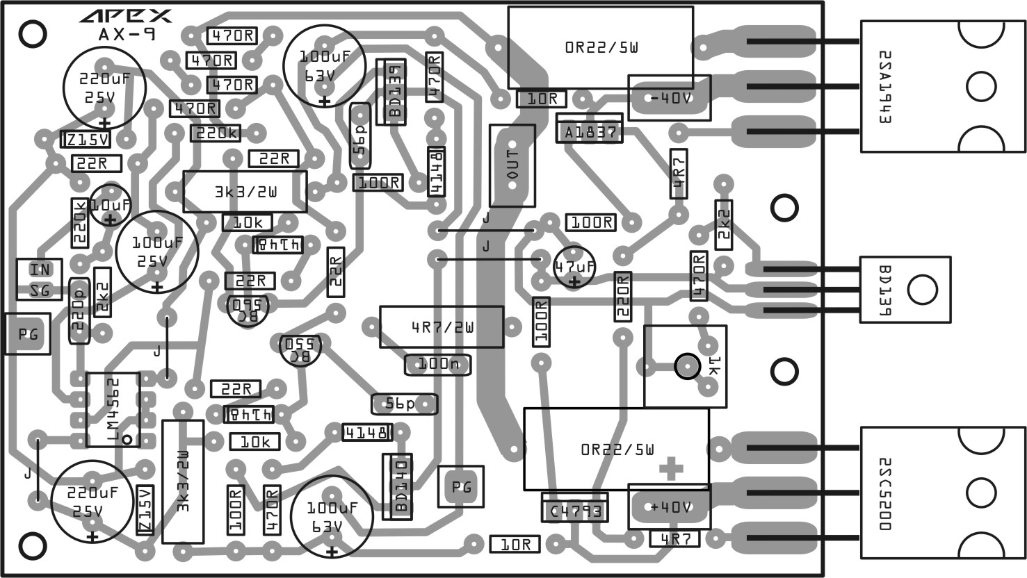

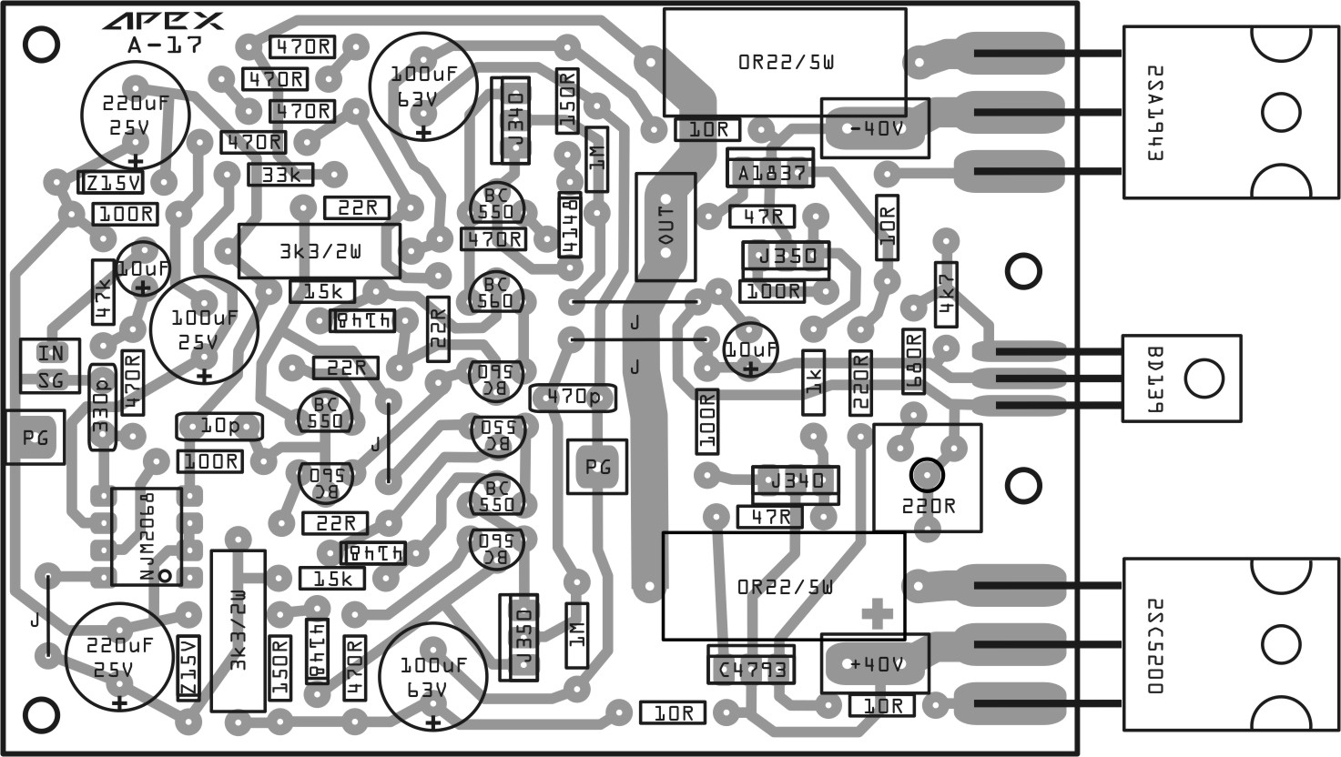

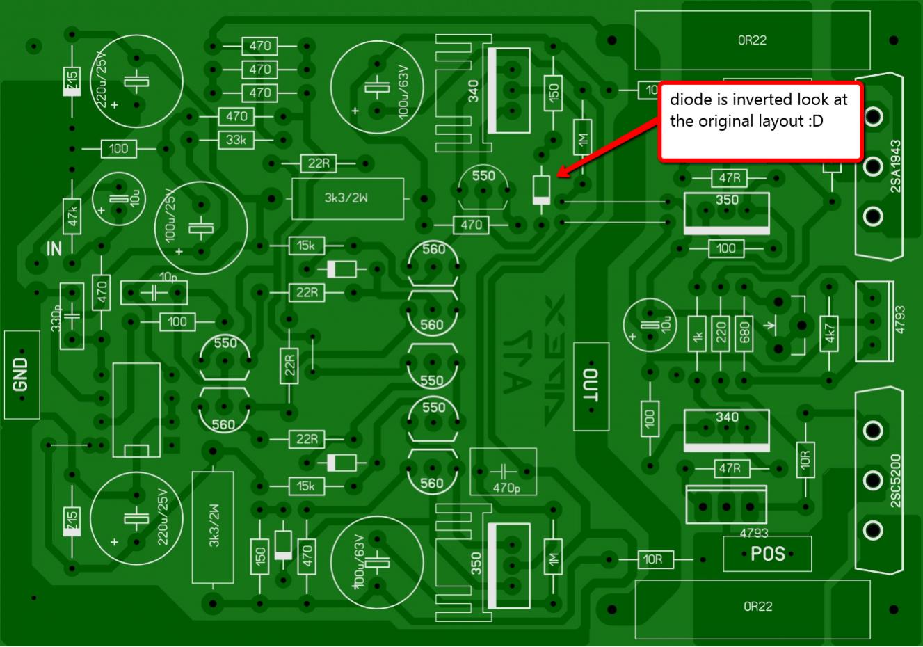

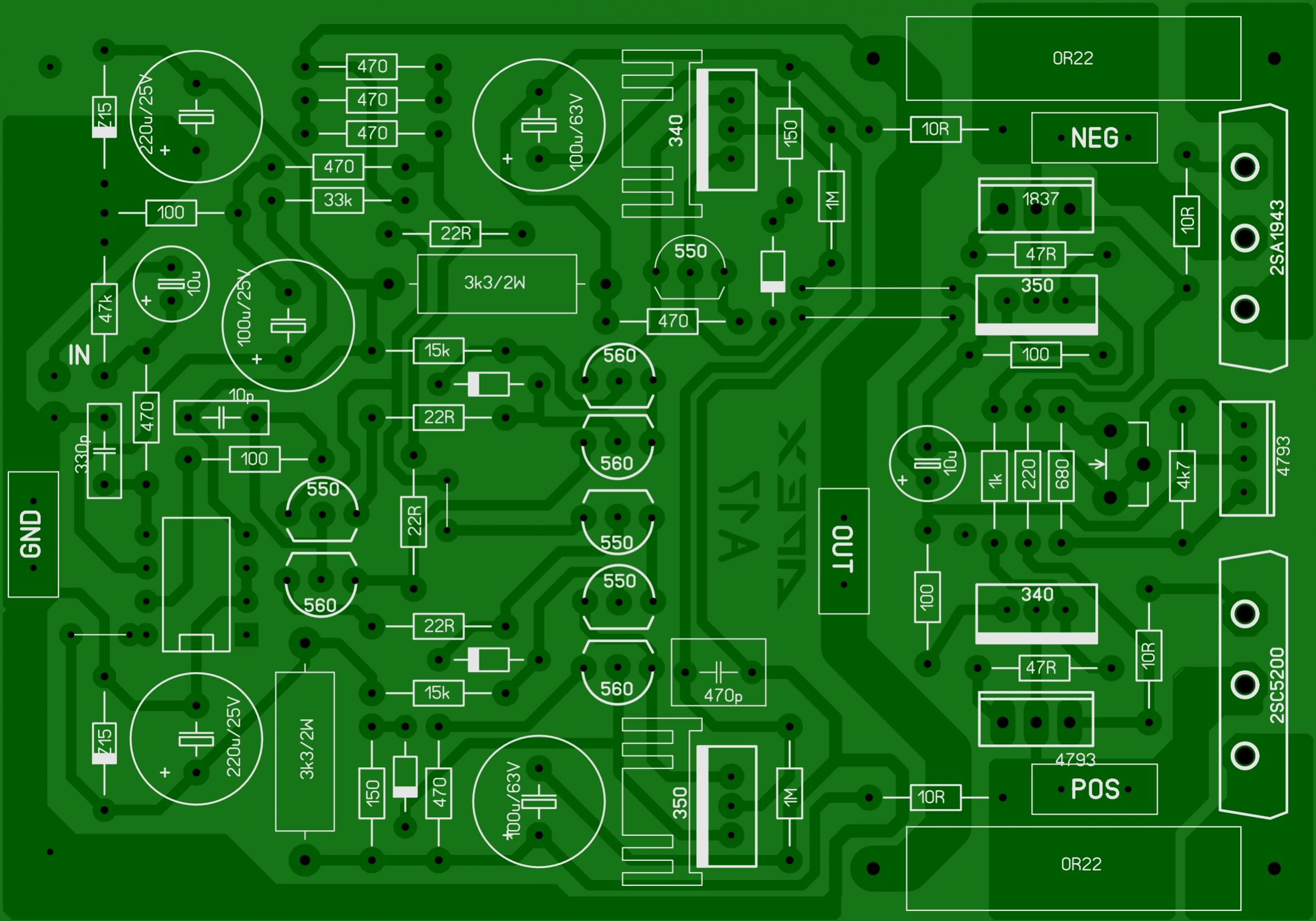

Very first draft with mirrored output transistors. Can someone check it please?

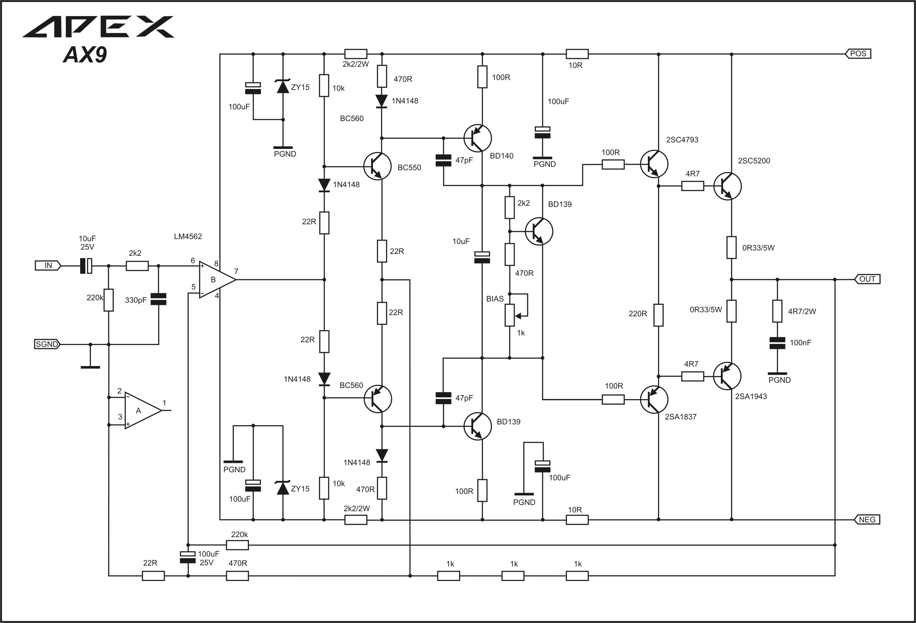

A schematic would be very helpful ;).
regards
I see a inverted 1N4148 make sure all is corrected before you continue, I think the original layout look good no need to redraw :) kind look like vintage style traces I like it :)
Regards
Juan
