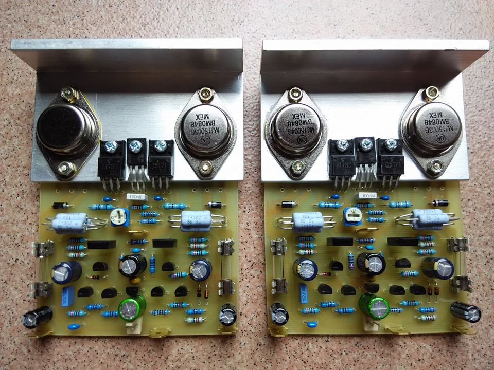

AX-14J
This is AX-14J

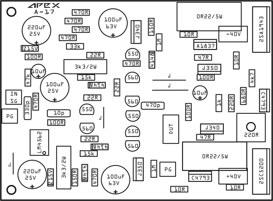

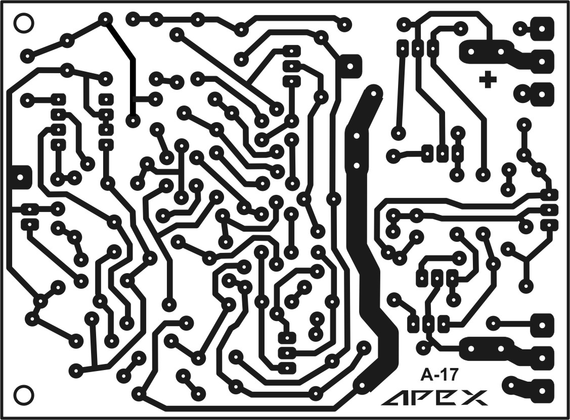

thanks Apex for all your design,A17 PCB size 95x70mm

The jengkols do not look like original, John. But it's not way better than 3055 anyway

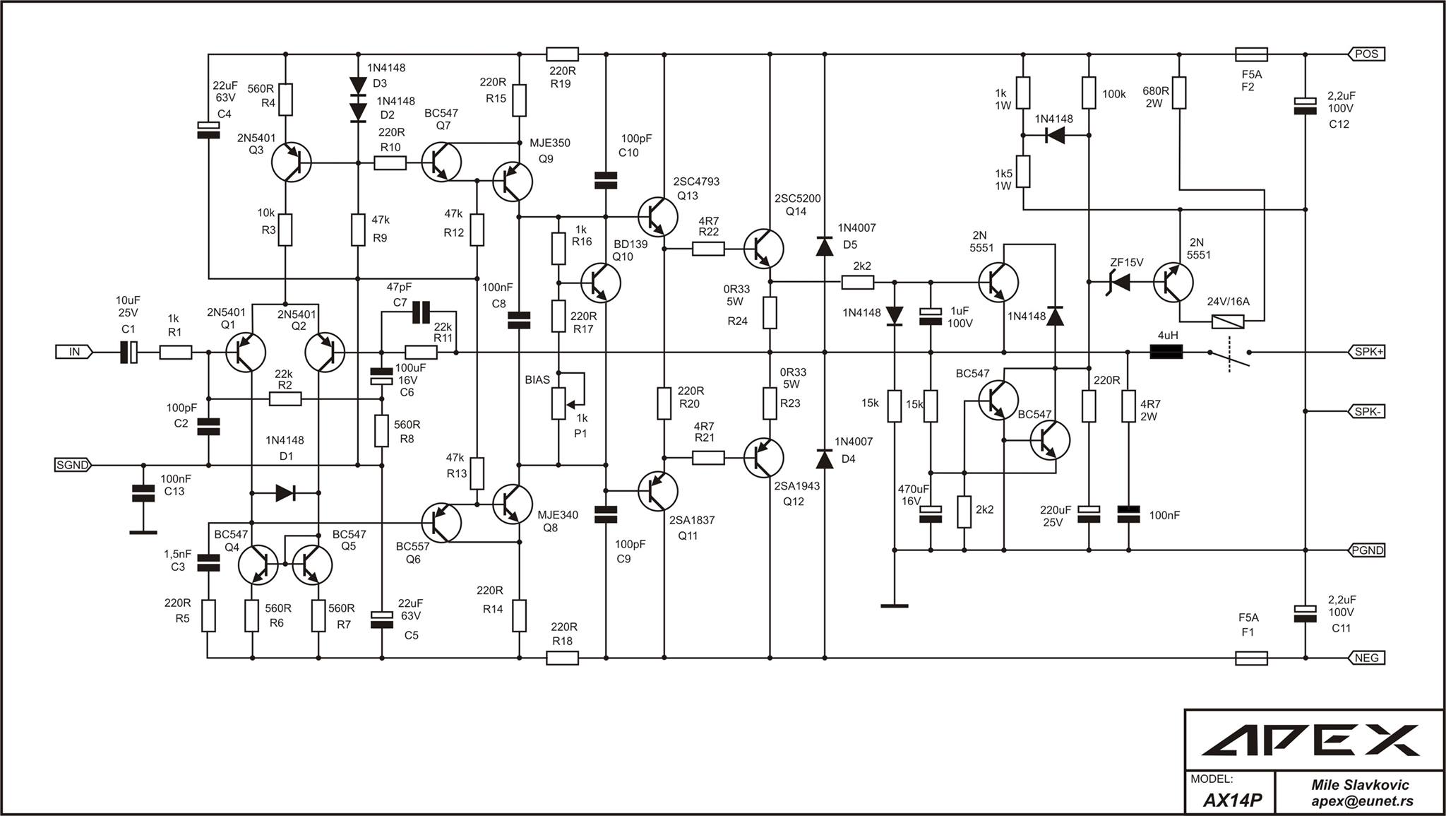

Nice work, output on A17 must be on botom (cooper) side of pcb (pins are reverted), NJM2068 instead LM4562 can be use.

I thought so(the marking doesn't look good), but maybe it is original one...The jengkols do not look like original, John. But it's not way better than 3055 anyway
I saw at post #3317 there are AX-14 also use jengkols (with better marking)
but don't worry I have spares some old motorola 15003-15004 if this one is blown
I will try at rail +/-55VDC for 8 ohm load, is it is okay?
if they were original I believe they wont fail it is worth to try
I just realize it ... & I will try to redraw it if needed & fortunely I have some LM4562Nice work, output on A17 must be on botom (cooper) side of pcb (pins are reverted), NJM2068 instead LM4562 can be use.
