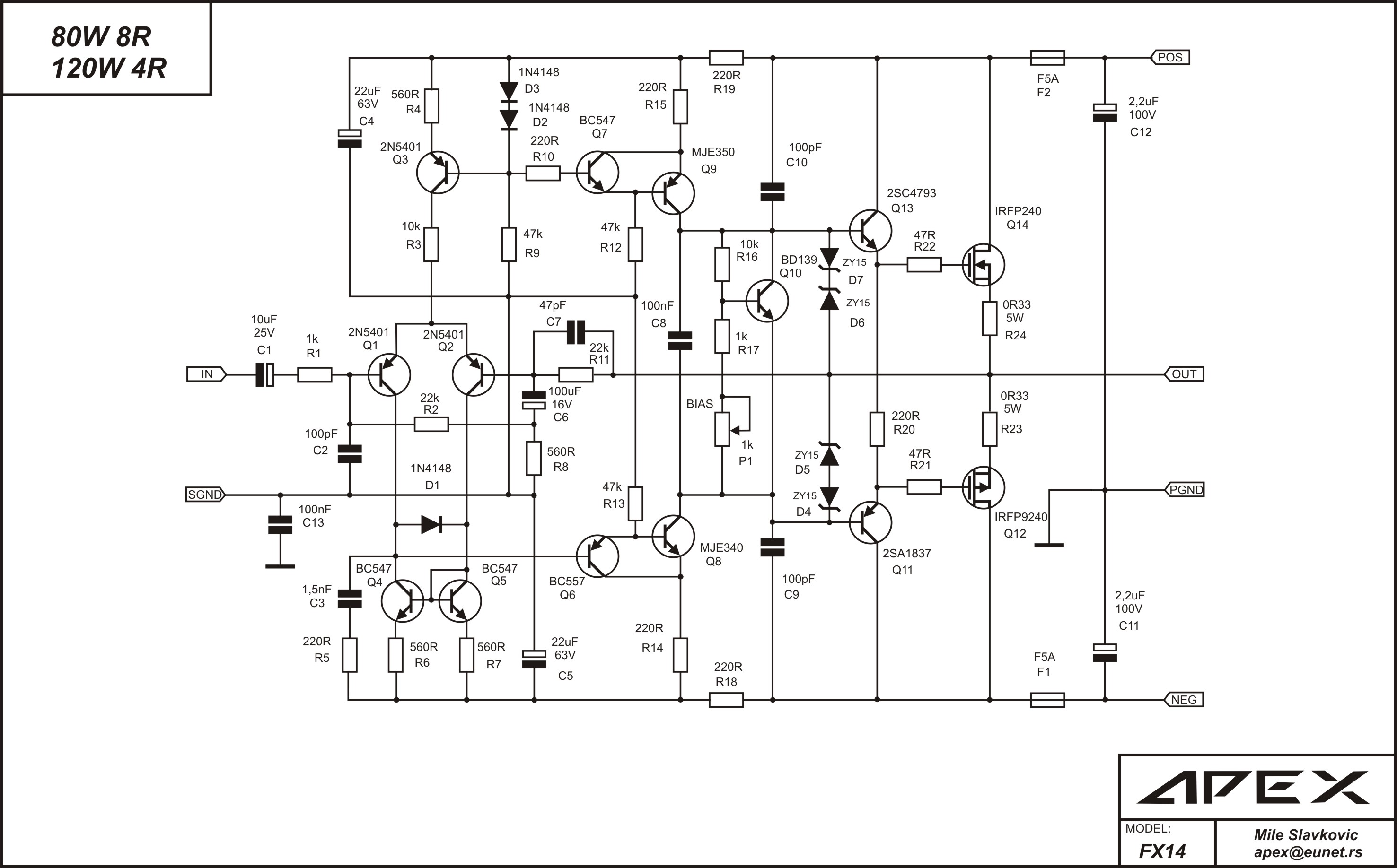

What I'd like to see in that new amp is a complete symmetry from end to end, with two differential input stages, with their current source and mirrors, possibly cascoded so lower noise transistors could be used there.
Perhaps the class H might be a good thing to have, and keep it all bjt, except perhaps mosfets for the class h part.
I was thinking a good thing would be a regulated supply would be better than the simple resistors between the V+/- and the input stages, hopefully isolating the input more from the main supply ripples.
One other thing I definitely want to have is a symetric input, possibly without adding extra circuit to make it symetric, since the differential stages are symetric to beging with.

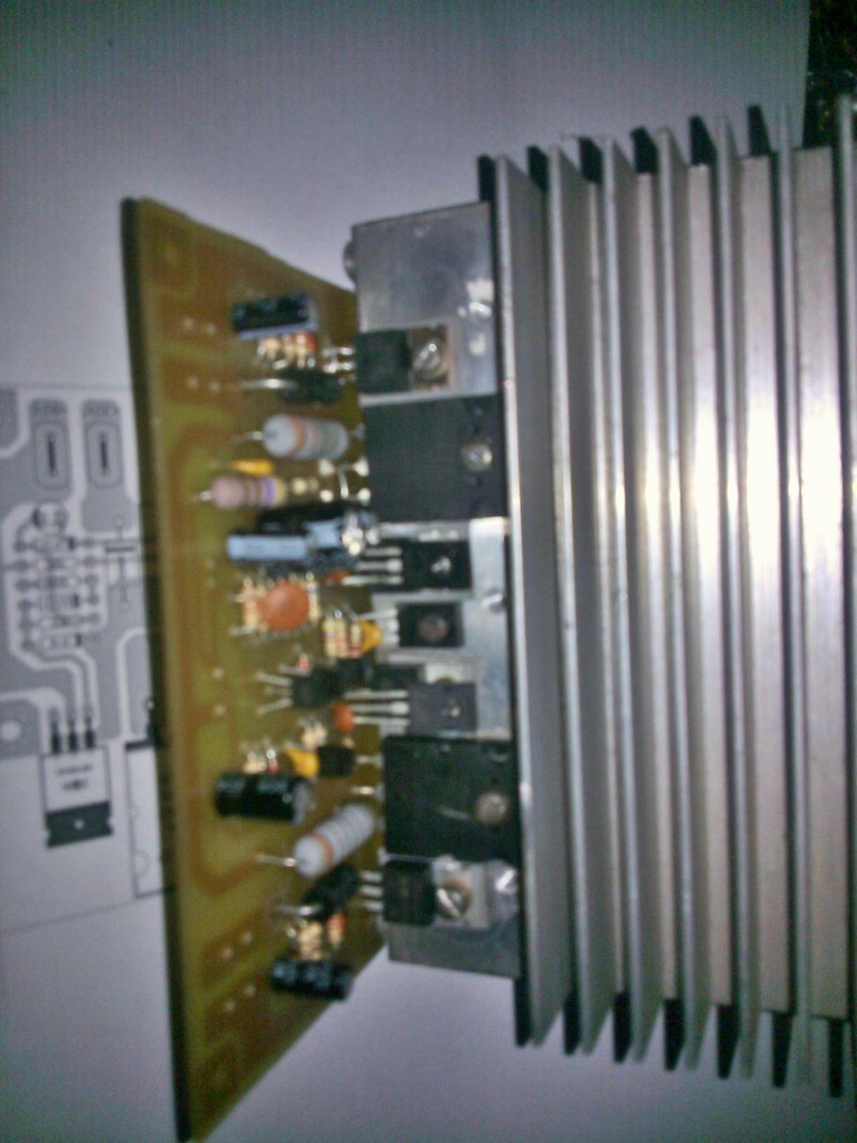

I would think the ordinary 1N4004 would do there...
I managed to get BA159, i hope it will be adequate... i cant seem to post pictures, how do i post pictures. i want to show off the board i built hahaha
First build

Are the attached plans working and updated?
Regards
