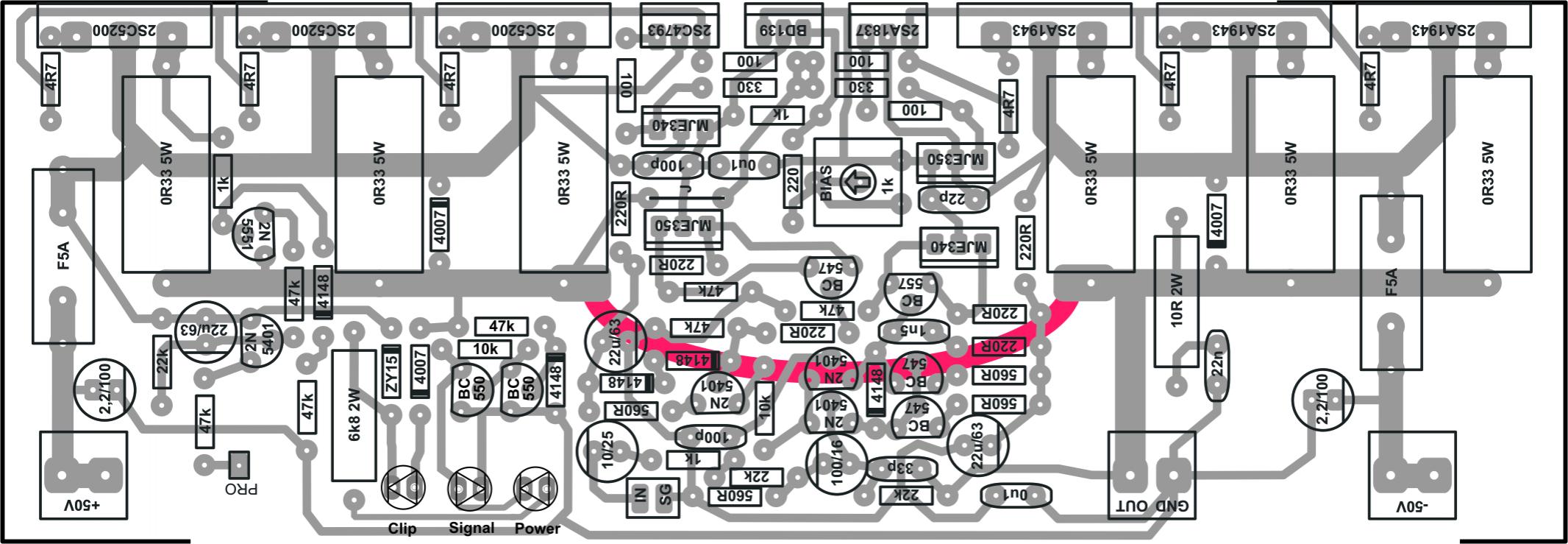

That will be great Wiljj, I'll be able to fit a 5w in there vertically, no prob.
Maybe a hole for mounting post in centre of pcb, in between caps
Thanks so much
If you can manage to install 5W resistor in vertical then thats ok, i'll put a hole tonight in the center of PCB between caps.
Thanks so much
Here's the file....

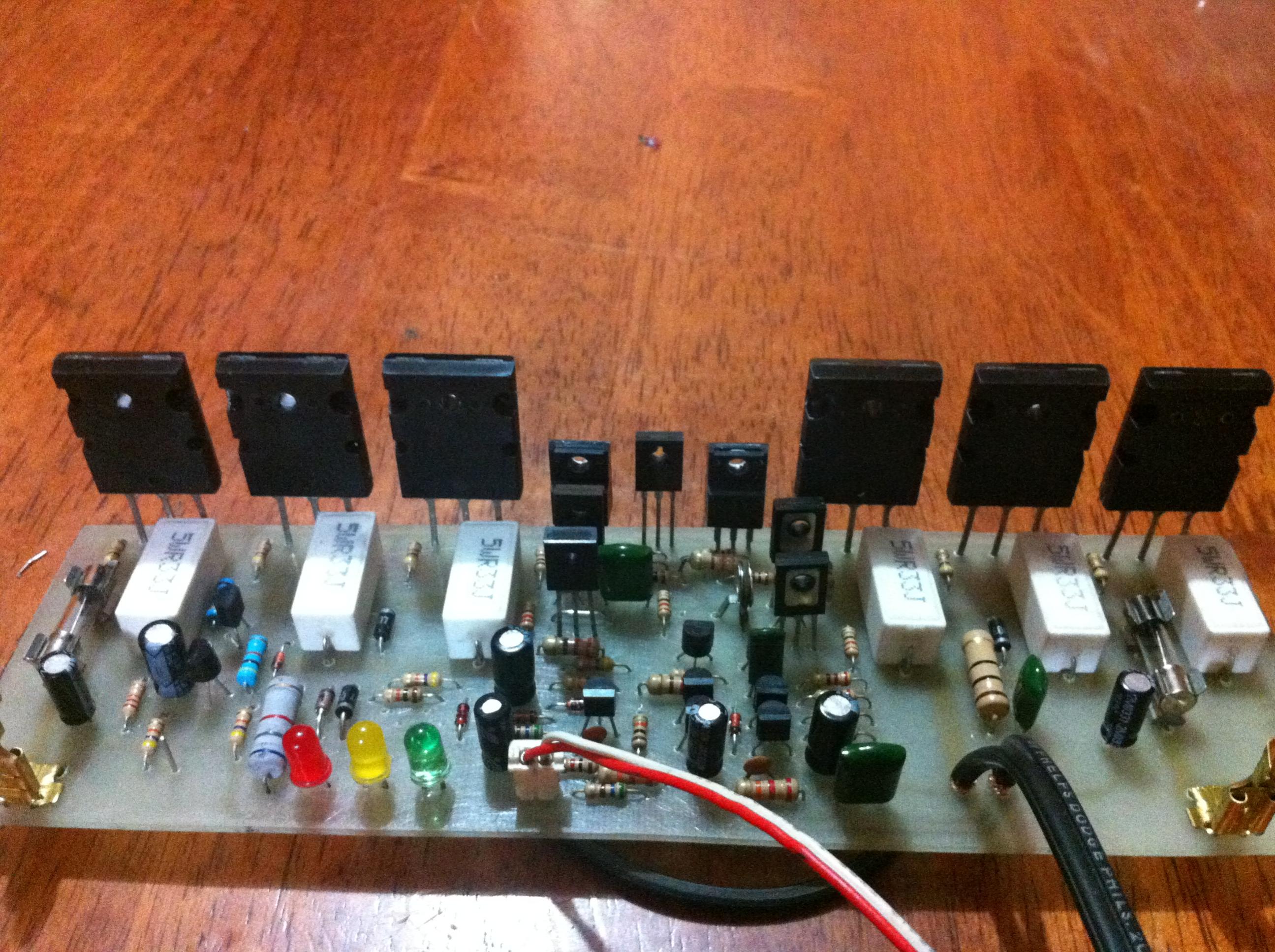

My AX-20 Build (3 pairs) using QQ12E5K1 pcb.
Hi-Fi sound, with softer treble than AX-14!
You can never get tired of listening music, even at a loud level!

Greetings,,, what is its bias v?? and how dc max for 3 pair??

rail voltage +/-50v. i have not correctly measured bias. i tried to measure voltage accross one of the output resistor but got no reading. i think amp worked in class B.
AX14 will work with +/-56V DC rail voltage.

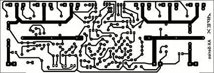

what is the measurement of this pcb?thanks

what is the dimension of this pcb.thanks
hi masood,
pcb size: 93mm x 60mm

ur attached pcb is too big and not ax14

AX-14 PCB Size: 60x82.5mm
