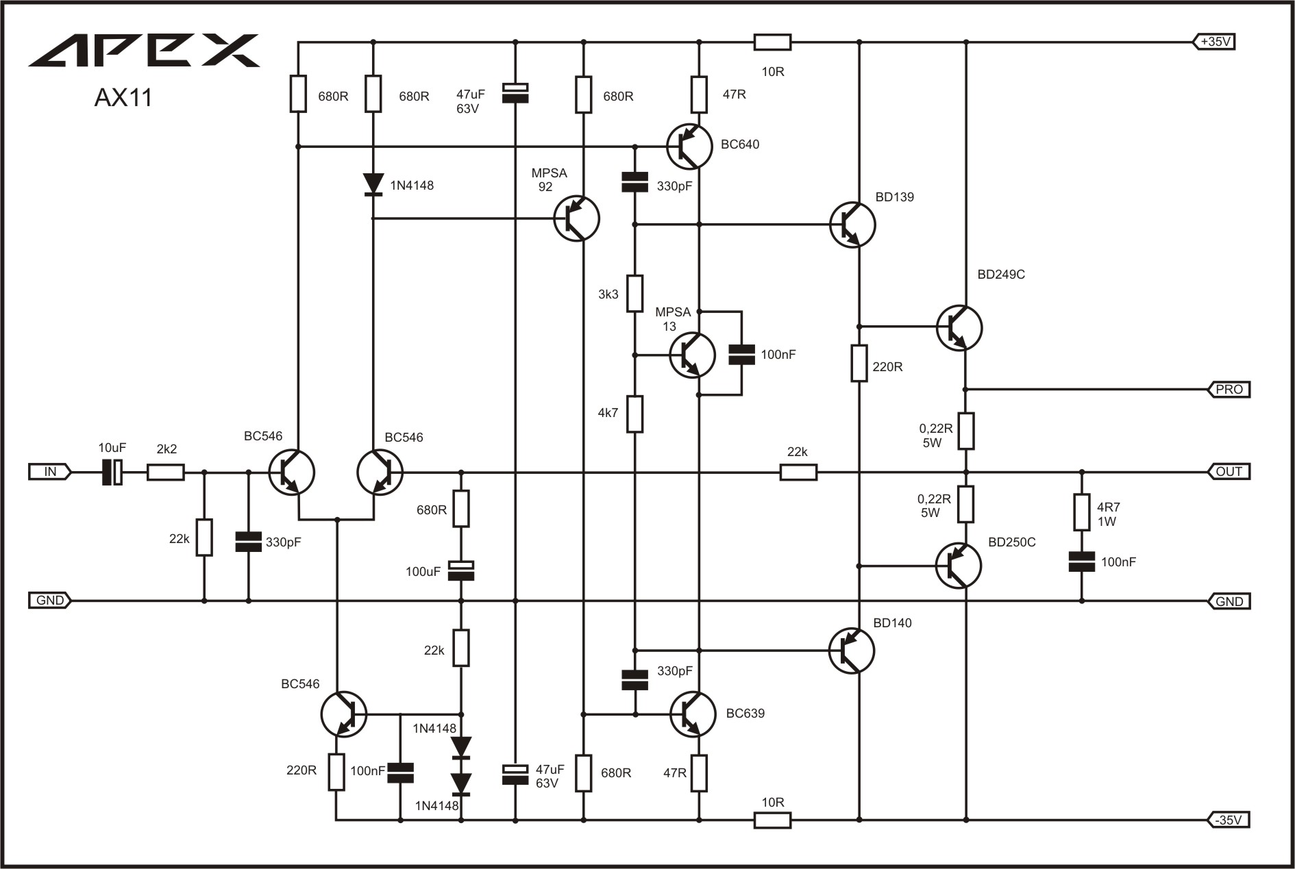

Now, how to bias this amp? This is my first amp build that needs of biasing. please help with procedure.
when i measure the 0R33 resistor with load the value is not constant. if there is no load in the input 0volt that i can measure across 0.33 resistor.
for biasing...
if i want to have a bias of 50mA...
V=IR; ohm law
V=50mA*0.33Ohm
V=16.5mvolts
is this correct? please enlighten. Thanks

congrats!
calculation is correct.
it's normal to have a fluctuating voltage across the 0R33 resistor when there input load.
to set the bias, short circuit the input terminals. turn the pot at a VERY SMALL increment while observing voltage reading on any 0R33 resistor.
as per suggestion, the bias is between 15mV to 20mV (50mA to 60mA bias).
edit: if you have trouble setting the bias, you may need to change R16 from 1k to 1.5k.
if you have unstable bias, you may need to install zobel network on output, that is connect output and ground with 4.7R/2W resistor in series with 100nF/100V capacitor.

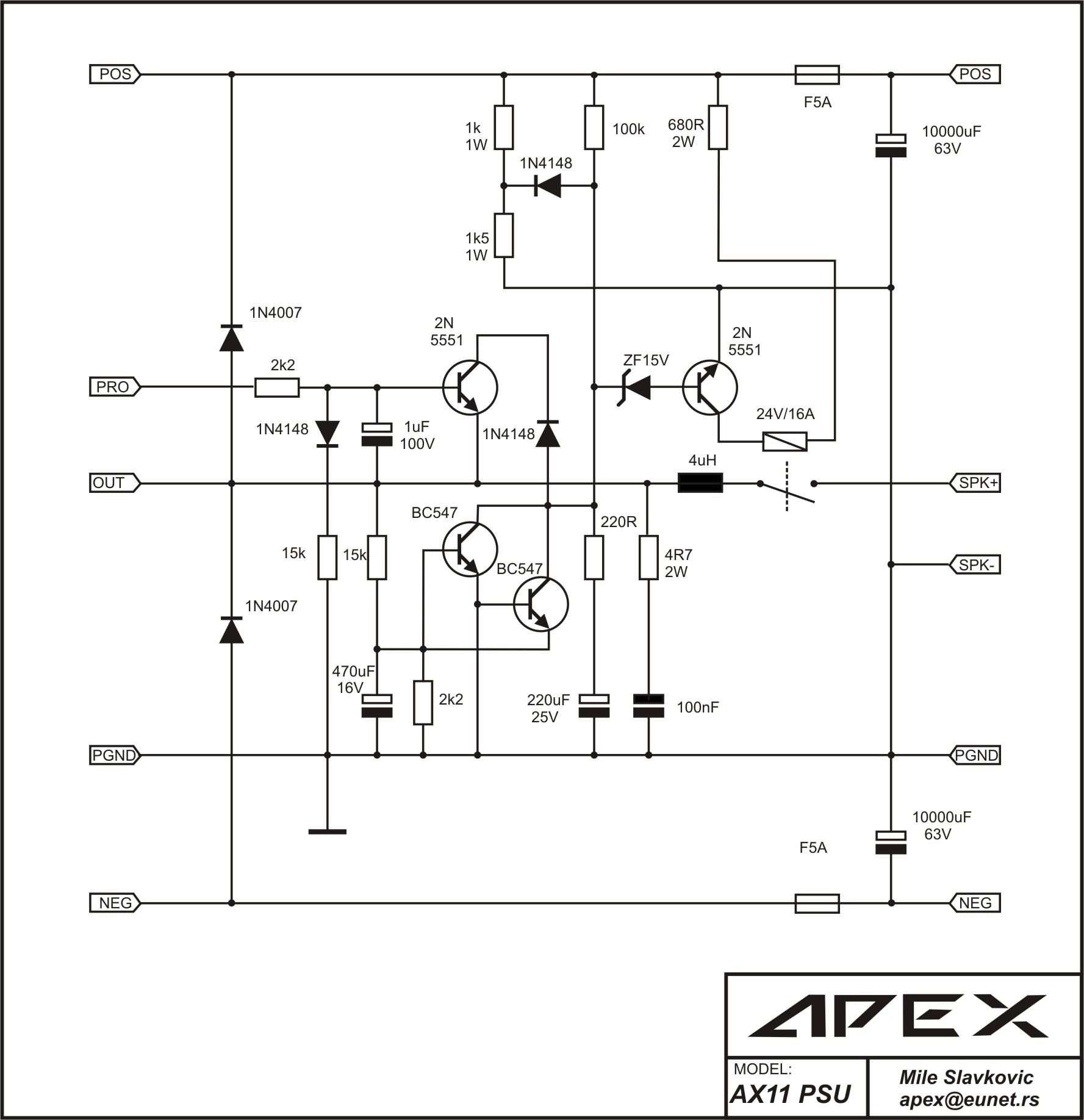

Hello sir, please advice and assistance connecting with APEX AX11 and APEX AX11 PSU Ver.2?
Hope this helps.
With this, you get two(2) Zobel networks. I think either one can be removed.

ax11 is first amp i assembled and it gives me a hard time but interesting. i replaced bd139 and i got 200mv at amp out but 2sa1943 have mv in all its pin, i will replace bd140 tomorrow and maybe amp will work. i am lucky with those defective transistor.
joeyt
busted fuse in -35v is the reason why 2sa1943 is not working,forgot to change the temporary fuse i used. now amp out got 5mv and ax11 is working right now.
have a good bass and its fun to listen with this kind of amp. very quiet amp. 2nd ax11 is coming up.
thanks apex for this amp, and willy for pcb layout

hello apex
im testing right now ax11 at full power, at full power 0.22r resistor has a pluctuating from 45mv to 65mv and mpsa13 vce=2mv and output transistors are hot.using fan to cool them. what is your suggestion to decrease the voltage across the 0.22r? and to keep this amp to warm?
