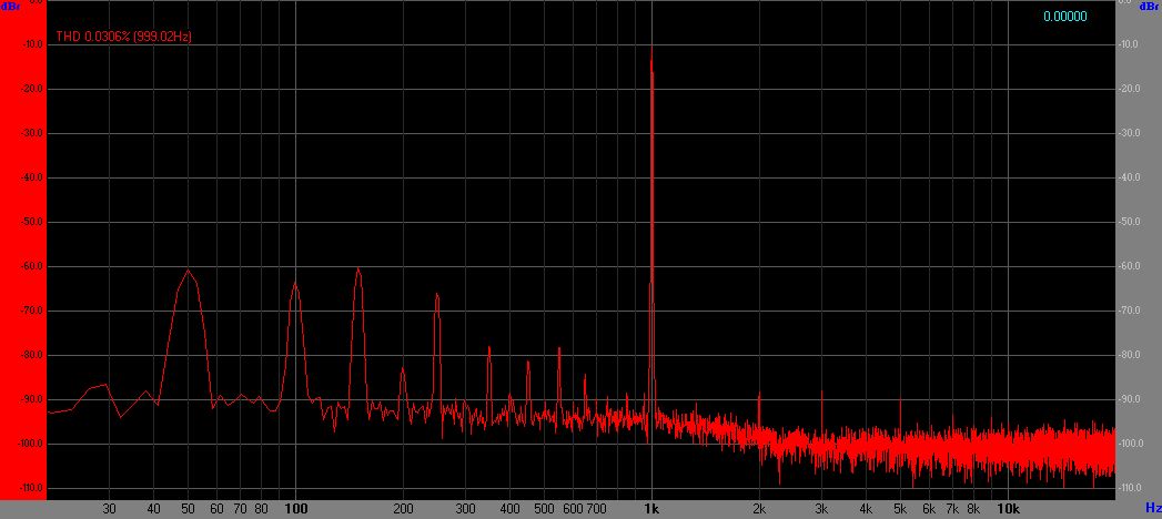

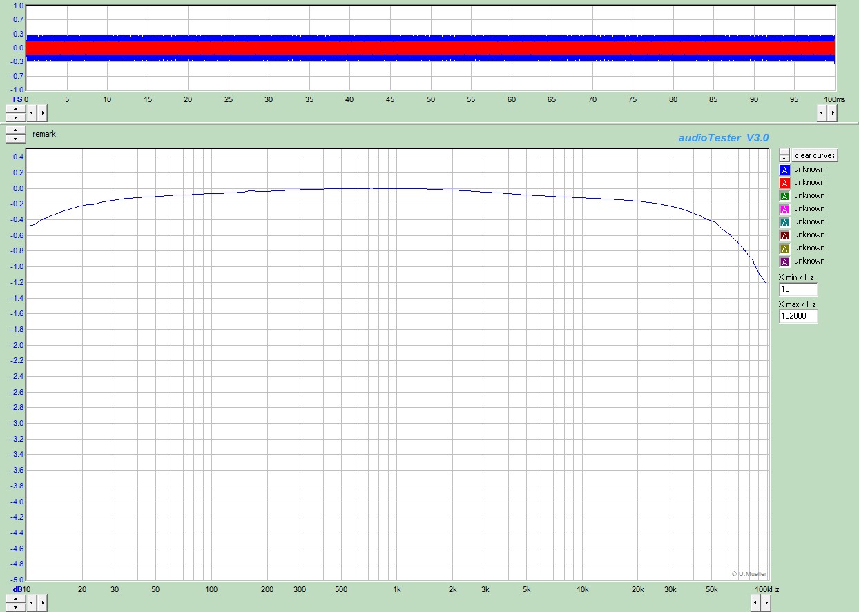

I'm in the middle of transformation of my (5mA CCS loaded, TVC output) #26 preamp to switchable #26/01a.
I overcome my laziness and last night put together the most critical parts, the 01a driver.
I use DC coupled SiC FET source follower as driver between 01a (20R filament biased, 5mA CCS loaded 201a) and TVC.
There are the measurements of the driver.
p.s. the bad hum components due to the breadboard wiring.
