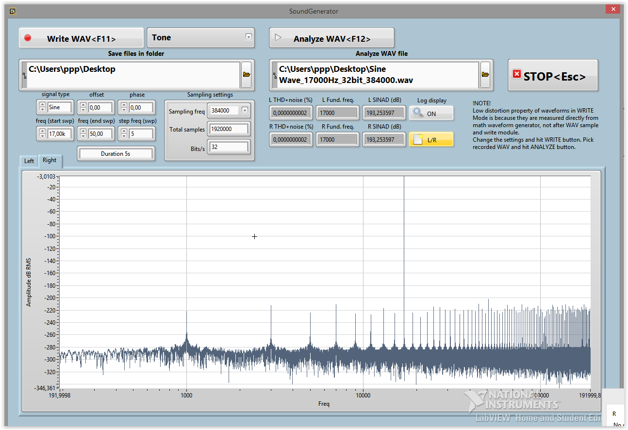

Well, using the Chinese sig gen I got this! Bloody hell!
So I dragged out the old valve sig gen and got this. 1kHz.
20kHz.
But why is one inverting? Maybe I pressed a button on the scope; I'll have to check that out. The response is 6db down at 120kHz, and just starts to droop at 17kHz, but that's hard to see. And 6dB down at about 8Hz. So not too bad, and I will have to play some music through it next.

I checked my scope, and I had pressed the "invert channel 1" button at some point. So the output is inverted, as normal. Phew! Overlaying the input and output traces, the roll-off doesn't really start until 20kHz, and is tiny even then. I still have to finish making the bronze mesh screen clips, and cutting the Sorbothane sheet for the valve dampers, and then I can try it.
It works, but it's incredibly microphonic. And there is some hum, so a bit more work needed. I took off one of the screening cages, but that didn't help, and I have another pair of valves so I will give them a go. And maybe the internal signal wiring will need screening. But the 26 had none of these problems, so I am a little puzzled. But it looks nice so maybe I'll just look at it.
