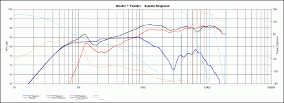

Here's what I got. Keep in mind that I only spent a couple of minutes on it just out of curiosity, so I'm sure it can be refined and probably a few of the components could be dropped with more work. But, it's never gonna happen with just a cap and coil.
The resistor in series with the small cap across the big coil is not a real value. It's probably more like 6-12ohms
And here's with a steeper roll off of the RS225 up top.
It cleans up most of the cancellation in the treble.
Now that's a lot notches and crap! But, a lot of parts is unavoidable in a first order passive, See Siri's Killer note. First order xo's aren't simple, they're more complicated. It takes a lot of response shapeing to keep drivers on first order targets, especially a driver like the RS225 with the broad breakup and also when your crossing near fs like you are on the 10f.
Now, first order electrical is certainly simple, but what's the point of that?
The one Byrtt came up for me had a big 57uF cap and a 2.65mH coil. Both were manageable - you have bigger components than that?
No offense to Byrtt, but I think something may be wrong in his model.
This is what happens with 57uf and 2.65mh. There's no avoiding the RS225's natural response.
This is with some level matching with an lpad. I went with a small resistor across the mid to tame the peak near resonance and it doesn't hurt impedance at all.
This actually looks similar to what you were getting with textbook active filters, see the dayton crossing way up high?
Edit: come to think of it, after working with Byrtt's numbers, you could probably delete the series notch on the 10f that is knocking down the fs peak on the low end, then reduce the series resistance inline with the cap from 5 ohms to around 1 and put a small resistor across the mid, probably about 7-8ohms. Might accomplish the same thing with a cheap resistor instead of the huge values in the RLC

Thanks so much for the XO design. Is there a diagram? I am new to PCD so can't mentally draw the circuit based on populated values.
Regarding the BW1 XO that Byrtt designed, I implemented it as close as I could (I used 5R instead of 4.6R resistors for the padding). Back on post #154 is where I discussed this. Because the mid was not time aligned, it caused an excessive rise at the XO region. When Byrtt added an equivalent of a 3in distance to account for the lack of time alignment, his prediction (using my indoors obtained FRD and XMA files) matched pretty well:
So I think you can get close with "just a coil and cap" plus 2 resistors to pad down the 10F. The photo shows 2 coils used in series to obtain the 2.65mH, and the big motor run cap plus a few film caps to get 57uF. I was able to make this XO for $15 in parts. Although, it does sound like a lot of extra parts will be needed to hit the BW1 textbook slopes via response shaping and RLC conjugate loads, Zobels, etc. We did not do any of that here.
I haven't had anymore time to mess with the passive XO since then though.
SATX,
Looks better than expected really, but I thought you wanted to cross really low?
How did you guys deal with the breakup on the dayton? a cap and coil will start the drivers rolling off, but at 6db/octave the breakup will need work. Regardless if you hear the peaking, it causes cancellation in the top octaves.
There's a little cancellation between 4-9k in your measurements, but it doesn't look too bad so I'm guessing you did something here?
As you know the high xo point is a function of the daton's natural response on your baffle and rising Z. Try a zobel as Greg B suggested, it works a treat to roll the driver off more predictably. That being said, I don't think that 2.65 will work, I show the same response as you with that value and it doesn't seem to have anything to do with phase. I needed about 7.0mH to bring it down to 350Hz! Also, if you did nothing to address the peak in the dayton, then try to bypass your coil with a small cap and maybe resistor, around .22uf and 12ohms.
Anyways, regarding my xo, see post #394-396. it had entirely too many parts. I was quickly able to remove 6 components by just adding a zobel and adjusting the values and slightly increasing the size of the main coil. And the series RCL (// to driver) on the mid might be able to be removed with a fairly small shunt resister and an aperiodic loading. The other two RCL's on the mid deal with the areas above the xo, so that would be up to you really to keep or not.
