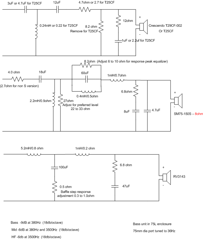

Another crossover schematics from SPD forum member
In a previous post in this thread SPD stated that the capacitor value for the notch filter on the atc should be 6 uF while in the schematics a value of 60 uF is given
SPD could you please clarify and expand your precious comments?

Yes this was one of my first crossover efforts for these drivers and although it does sound good, after many years improving the design and trying different bass drivers and hf units, the crossover I use now is different. I will post details later when I cam work out how to post the schematics/measurements from lspcad.

See attached my latest xover for the ATC mid. This is for the 8ohm version of the driver and also works with the B2500.1 and RV3143 volt drivers. The xover shown uses two accuton 11" bass drivers and the new Scanspeak Beryllium tweeter. The crossover points are 380Hz and 3500Hz.
It sounds amazing.

Thank very much SPD. Which other changes would you suggest if one uses the ATC 16ohm driver? How does the Beryllium tweeter compare to the other tweeters you have used ?( e.g. millennium, Scan-Speak 9900 Revelator) No doubt it is a very expensive driver !!

Without a 16ohm driver to take measurements with it's not easy to determine
component value changes. The plots show you the target response. The two notch filters should be the same for the 16ohm driver but increase the series total resistance to around 16 ohms. You need to measure to get this correct.
The baffle width for this design is 360mm.
Regarding tweeters I have also used the same mid xover with:-
1. Seas T25CF002
2. Seas T29CF002
The Scanspeak Beryllium is expensive and is hard to integrate because the response peaks in 4 -6kHz range and so lots of trial and error to get the sound good. In the end my favourite is the T25CF002. Works really good with the ATC.
