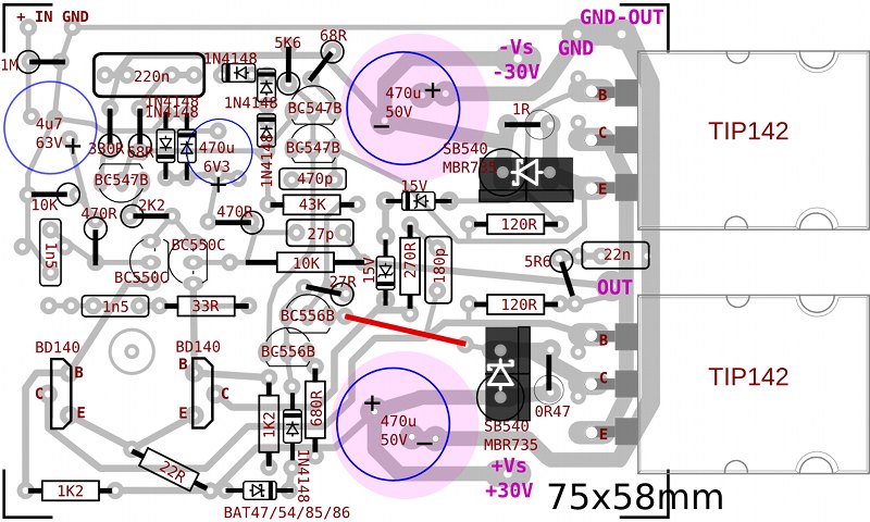

I consider that I finished my PCB layout of N-Darlington output version of vanilla Circlophone. I built two channels and they are running for a while. Purity, dynamics, punchy bass.. I think this version is no less than original output scheme. Even with those ST TIP142's. . . .I used BD140's as servo transistors because mine were good quality ones from Philips and Harris. I measured their cb capacitance at 0V and Harris ones were always lower (35pf vs 52pf).

Unobtainium parts reliance issues: So, not a random BD140, but rather a little "super driver" sort with fine specs. Neither the Harris nor the Philips are widely available. I wonder what we can find for substitute at Mouser, Digikey, etc. . . Perhaps Fairchild has something for us? We need to list something with higher availability, for the documentation.
Other than the unobtanium vas, this version looks fantastic because it is the easiest and most compact way to build a Circlophone.
Given the 30+30vdc (60v) operating voltage and unregulated power (surges happen) we might need to list something other than BC556B (maxed at 60V) in the sensor area.
So, basically, we need an updated photo that lists alternate transistors for vas and sensor, in order to assure expected operation on all builds.
I also tested 2SA1220 (Nec), 2N5401, 2N2905A in place of BD's during tracing overshoot behavior. Actually I couldn't manage any difference between their behavior with oscilloscope. I showed BD140 part on layout because I consider that builder is aware of NOT to choose a random BD device. If I could find a 2sa1360 (2.5pf Cob) from a local store maybe it is going to be shown in the layout. It would be a good candidate for higher supply voltage usage. It is very easy to adapt mounting holes for 8-10pf capacitors between c-b legs of servo transistors in current layout. Maybe these self compensation caps aren't going to be necessary. I can't be sure until test it on real circuit.
KSA922, 2SA970, 2N5401 (and their couples) are suitable for sensors in higher supply voltage usage and they are easily attainable. Transistor leg arrangement must have considered in this case.
No problem.

Have you tried replacing the zener with transistor, per Elvee's post#1151 above?
I consider it must be applied as shown in Elvee's jfet buffered schematic at post #637 (but using a PNP device?) If so, it is possible to alter zeners with a single transistor without altering layout. Not an artistic way but it is doable at least.

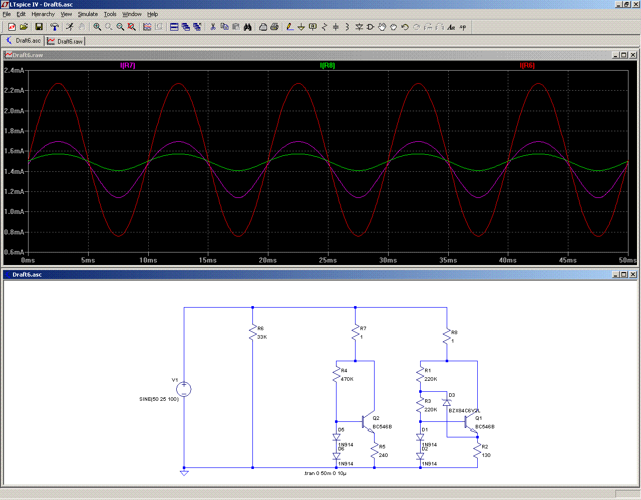

During simulating jfet as CCS instead of R2 (R21 in original schematic) I noticed that ~7-7.5 mA CCS (~8.2K) decreases THD to 0.0004 levels. I don't know that it is realistic or not but it is good to have your opinion on this observation. I doesn't happen with standard version. Darlington version doesn't affect that much.
Normal: the current is so high it overwhelms the common mode servo, forcing operation in class A with a quiescent current in excess of 5.5A :cool:
No surprise it results in lower THD: feel the heat guvn'r, that's the real stuff
Which means amplifier is not a Circlophone anymore? With mosfet output, is it worth to slight increase of current? Or is it just matter of how much we dare to deal with heat issues?
