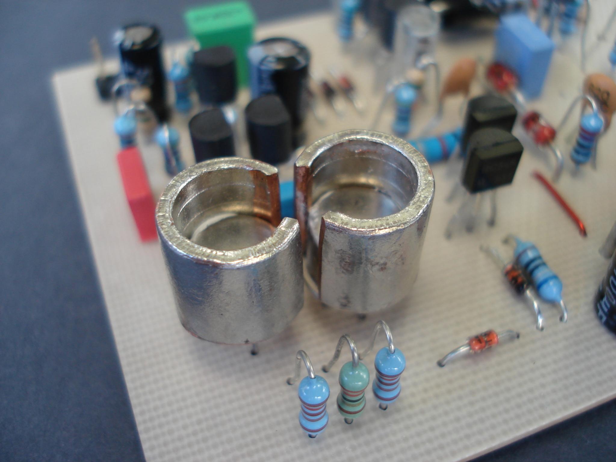

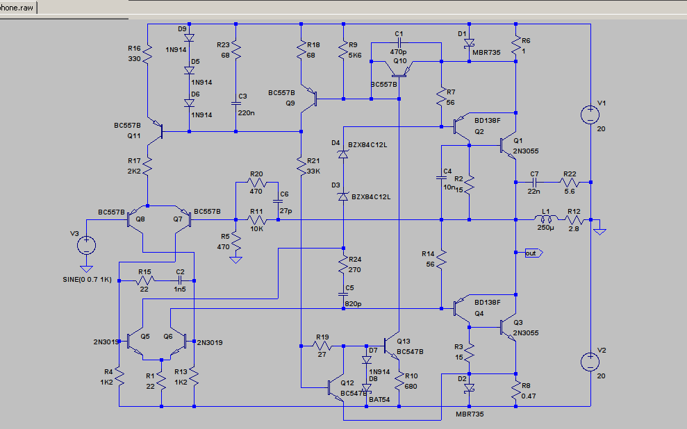

Audiometric, Offset bounce, hammer-pillow-thumb, and current
I was looking at the offset bounce issue with a new perspective, and that is audiometrics. For offset bounce to occur, D10 and/or D11 switch on to the bass beat when not all of the bass can travel the 470u. Well, a ballpark audiometric value for C3 (same value that would keep the diodes off) is far too large to consider; however there are several alternatives.
Simulations of Circlophone consistently show some benefit to buffering the input in several ways. One day, not long ago, I was wondering about these added transistors that effectively serve as a pillow between the hammer and the thumb, and if instead we could reduce the size of the hammer by reducing the current a little bit, and then not need any added transistors.
Reducing the current can be done with R16, R19 to 1.2k or higher figures. It seems to answer both of the above questions; but, as usual, there is the new question if the fix is suitable?
Of course I want the buffer, but I'm doing a "back to basics" review for the dual purpose of possibly running without the buffer and to make the compensations a lot easier. There's something "off" with the tolerances and I don't want to cover that up without first discovering the source. After reading the whole thread again, I find a few things that take priority. First, the audiometrics are so powerfully off the mark that D10, D11 have been damaged by overcurrent surges on a few builds. This area is also the source of the offset bounce.
One possible option is to fix the audiometrics with 470u~1.5k vs 56k so that the NFB cap is then apparently big enough so that D10, D11 accidents are rare rather than frequent.
If audiometrics are not repaired, I we chould change to a triple chain of BAT85 for 0.9v, and even 3 of those makes a LOT less noise than one 1N4148. However, audio quality is not the only concern. This area breaks small diodes from over-current, and then it is difficult to figure out what went wrong. Eventually, not fixing the audiometrics then requires something very much like this: 4.7R~FR\\FR~FR\\FR, a series pair of quiet 0.45v soft fast silicon diode clippers series to 4.7R, giving the approximately the 0.9v tolerance that the circuit seems to need, in combination with enough current capacity to withstand error conditions, still a lot more quiet than 1n4148's, and the resistor is added to the clipper for allowing the NFB cap to compete with the diodes until the loss at cap roll off exceeds 4.7R (a lot lower pitch). In this combination method of postponing the diode switch-on, an undersize NFB cap (470u~470R) may be used without turning the bypass diodes into a problem.
Since we've already exploded some 100ma diodes, we might want to consider that BC556B has 100ma maximum surge rating, and that BC327-40, with 800ma surge tolerance might be a safer bet for longevity of the input pair.
I'd rather use audiometric sized feedback-shunt area (470u~1k5 vs 56k) removing error instead of using high current parts to withstand error. But of course we could do both, since the replacements are excellent quality low noise devices.

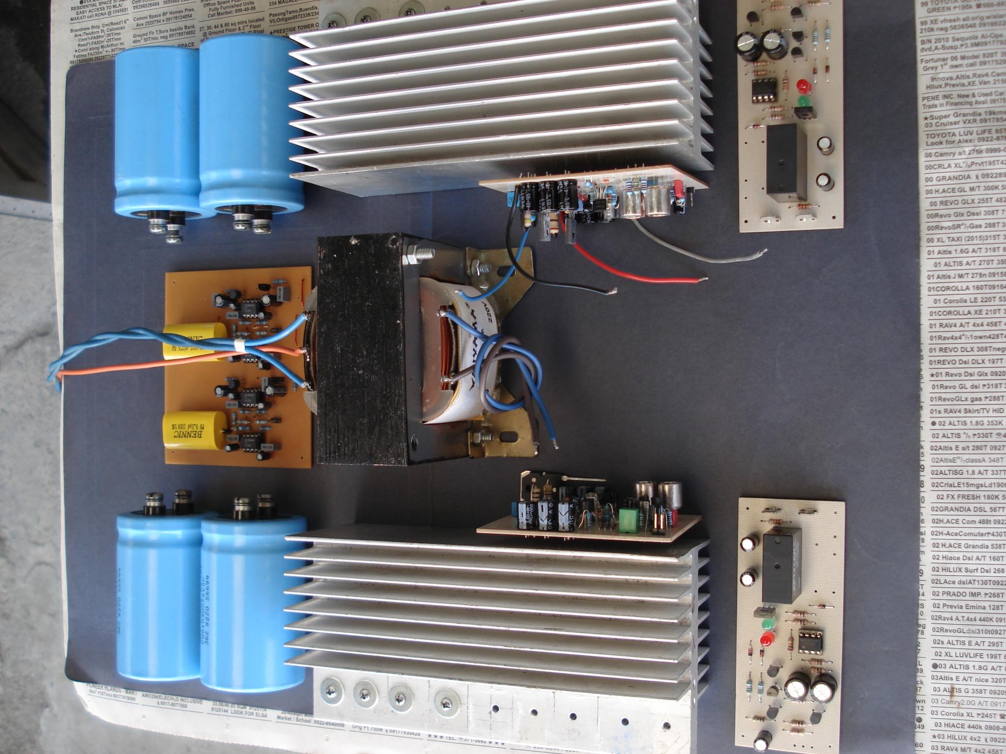

Miniature Circlophone spotted! Thanks!
With 20+20VDC, your R21 at 33K should probably be closer to 27K. Your two zeners, 12v+12v=24v, probably sounds fantastic; however, it should technically be just 1 of 1w 20v zener so that the 2N3019's are both running at the same temperature. At this low voltage, you can show the outputs as MJE3055, which are in more convenient TO220 size packages. BC560C's can be used for input pair. The RF blocking +input RC is missing. R20 is fascinating because I haven't seen it before. The input load is missing. The approximately 150u power caps are missing. Either the NFB cap or the offset trimmer accessory, is missing.

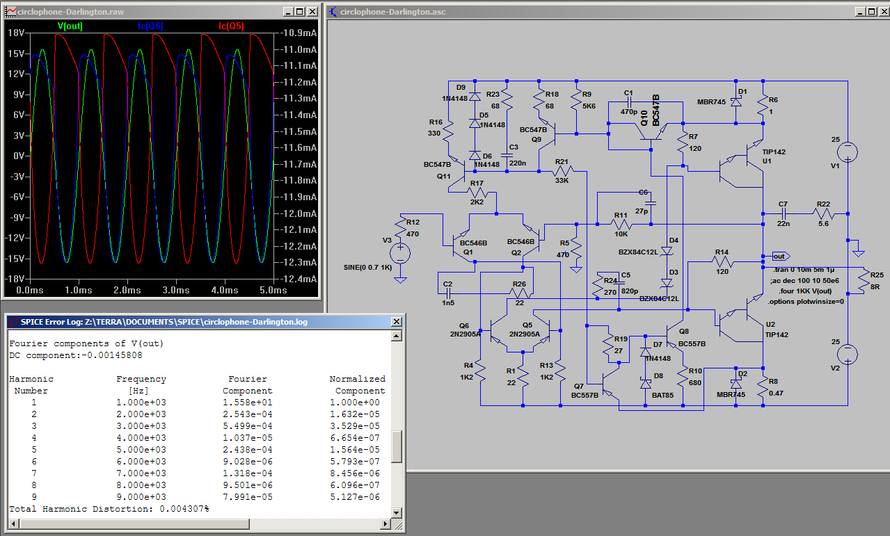

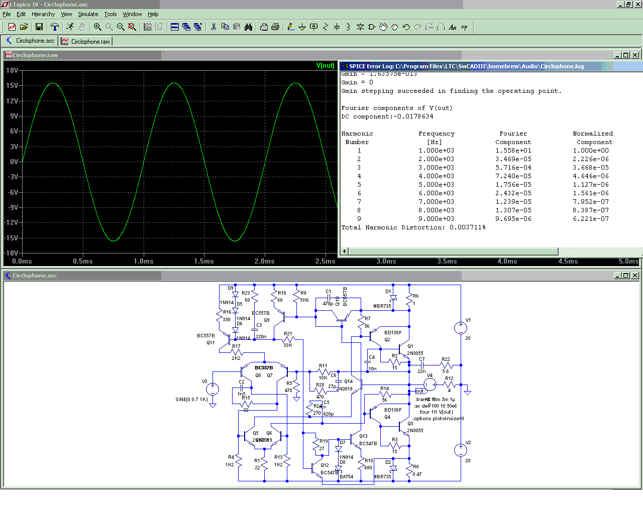

I have simulated Darlington output version respecting the schematic at post #16. I used TIP142 and BDV65B libraries that i found at internet. I measured collector currents of Q5 and Q6 servo transistors and simulation shows 20-40 pico amperes per transistor besides 10-13 mA in standard version. If those such low current levels in simulation are realistic, I think that servo transistors must behave problematic in these conditions. For example, Ft of Q5 and Q6 must drop to excessively low levels.
I adapted my CFP pcb to standard version and I plan to share without attempting to build it. I'm working on a simplistic darlington version pcb and my concern mentioned above is related with this work.
Note: I will check the schematic again immediately to be sure for 120R's (R3 and R6) are there.
Did you notice that this schematic is completely upside down? Supplies are reversed, transistor polarities are reversed, etc
If you missed one thing, nothing will work just like the symptoms you describe.
Alternatively, post your asc file for a check.
I got figure it out. Input LTP alignment was wrong. After correction, measurements became realistic. I attached asc file anyway. When I use on-semi bdv65b spice model distortion level becomes remarkably high comparing TIP42 model below. Maybe it's related with insufficient model. I appreciate to take your opinion about on-semi BDV65B model file, because I plan to use authentic Philips BDV65B's in this project.

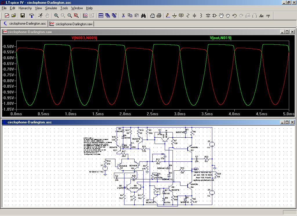

Strange things happen with this model: it looks like half transistor, half darlington. Perhaps it has to do with the integral B-E resistors (real or simmed, I have no idea).
Shown below is the Vbe of the Op transistors.
We see that during their theoretically inactive part of the cycle, only the input transistors must be active because the Vbe is at 0.55V, with an Ic of 190mA.
Why not, that depends on the ratio of internal resistors.
But when the current becomes larger, anomalies appear: when the input transistor's current is insufficient, the voltage should jump to the next Vbe to catch up.
But what we see here is an arch of sinusoid, following linearly the output current.
This is quite strange and unexpected.
If the real component actually behaves like that, the THD will effectively jump to 0.025%. But I suspect that the parameters of the (probably single) transistor have been manipulated to look like a darlington, and in this case the approximation causes the strange behavior.
