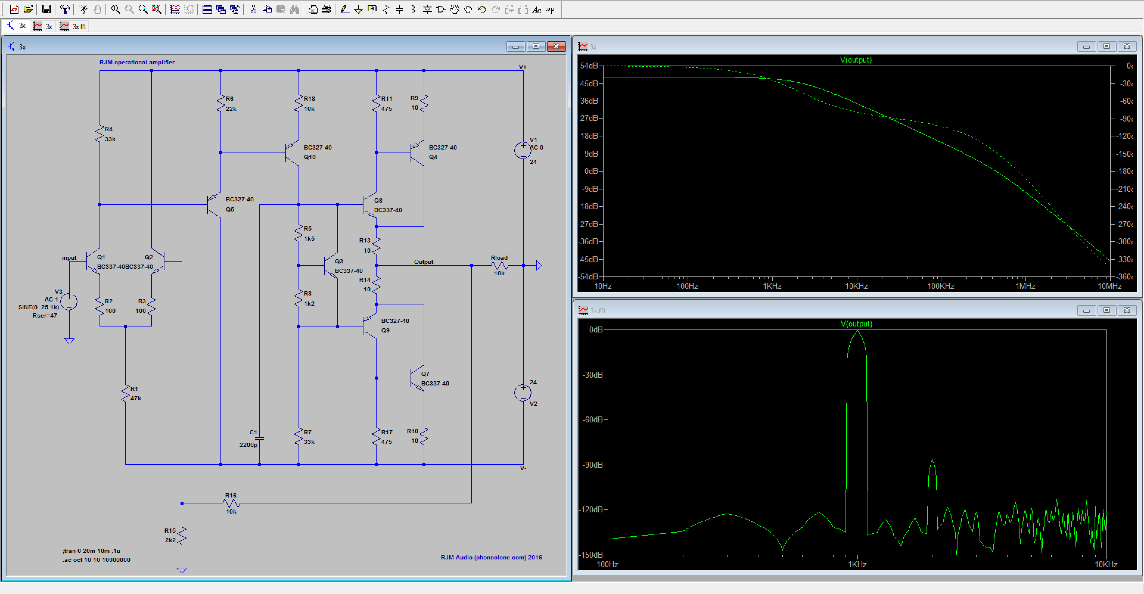

RJM Audio discrete op amp (circuit schematic)
Posted 8th August 2016 at 02:06 AM by rjm (RJM Audio Blog)
Updated 22nd November 2016 at 11:29 PM by rjm
This is my first op amp design which doesn't completely suck.
Now, it's a terrible op amp... don't misunderstand... (Nat Semi will not be making me any offers)... but it does perform the job I want it to do reasonably well: remain stable while providing 6-20 dB of line-level voltage amplification with low distortion, decent PSRR, and sufficient bandwidth.
The main limitation is the distortion at high frequencies rises to -70 dB. The circuit needs less open loop distortion, or more open loop gain above 10 kHz, or both.
You will note the circuit has no current sources. This is intentional. I wanted to see how far it was possible to get without them. Obviously headroom takes a big hit, but distortion and PSRR ended up better than I imagined.
This is a simulation. No guarantee it will work, and there are no safeties (current limiters, input voltage clamps, etc) shown.
PS. Frequency response in image is open loop, while...
