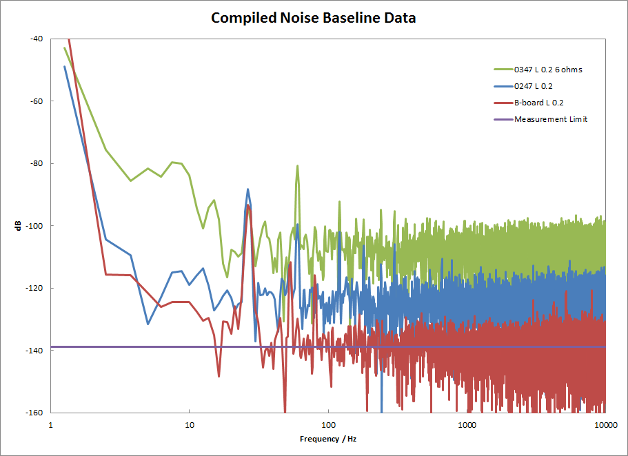

B-board vs. 0247.
Comparison of the noise baselines, measured at the circuit output using a NI USB-6215 DAQ. Unloaded for the preamps, and with a 6 ohm load for the 0347 amplifier.
  • B-board: -139 [300Hz-100kHz] 0 dB gain (-139 - 0 = -139 dB, 110 nV sqrtHz input referred). The actual B-board output noise is below this measurement threshold.
  • 0247: -124 dB [300Hz-100kHz] 14 dB gain (-124 - 14 = -139 dB, 110 nV sqrtHz input referred).
  • 0347: -109 dB [300Hz-100kHz] 31 dB gain (-109 - 31 = -140 dB, 100 nV sqrtHz input referred).
See the attached plot for the FFT data. Note the peak at 28 Hz is an artifact of the measurement apparatus.
By way of comparison, a typical audio opamp has an input referred voltage noise figure of 3-8 nV sqrtHz (-170 ~ -160 dB) and can be expected to return this datasheet specification in most well-designed circuits. In other words the output noise is going to be about -160 dB + the circuit gain.

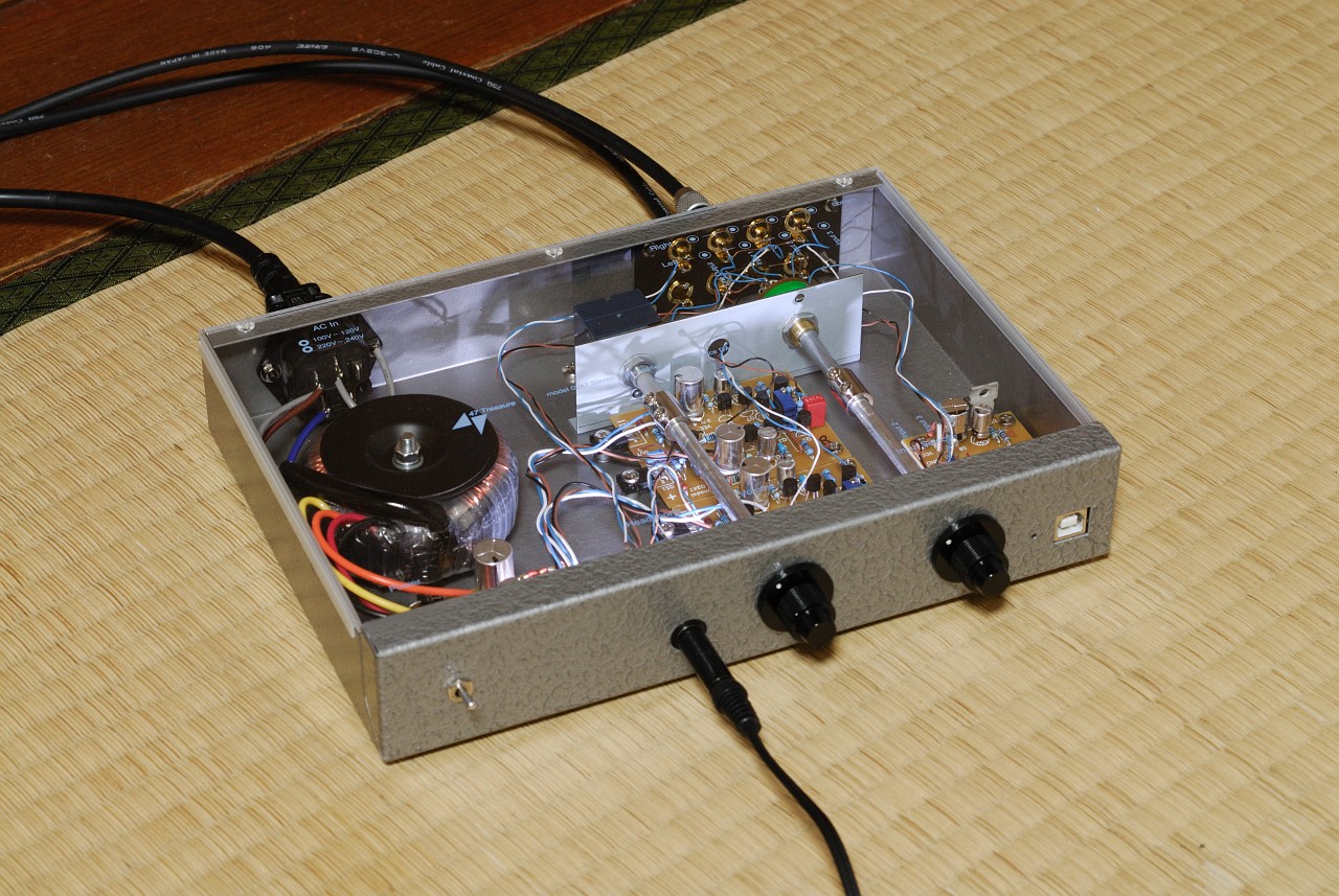

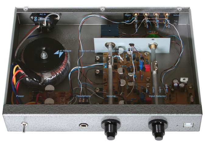

47 labs 0247 : done, tested, working
Posted 12th January 2012 at 01:18 PM by rjm (RJM Audio Blog)
A few bumps along the way:
1. Soldered one of the caps in backwards. Removed and fixed, fortunately before power was applied to the board.
2. Soldered one of the transistors into the wrong place. Removed and fixed.
3. Dead channel on power up. Bad solder joint on the emitter of one the output transistors. Eyesight not what it used to be. Found on second inspection, fixed.
4. DAC board not level with cutout on front panel, had to use washers to raise it to the correct height.
Other than that, things went smoothly enough, though I spent more time with tweezers routing lead wires than is ideal for a commercially released audio kit. It's not so much difficult as it is painstaking - and I have quite a lot of experience doing these things so I imagine I had an easier time of it on the whole than most will.
The final result however is aesthetically quite pleasing, well worth the effort and expense. It is...

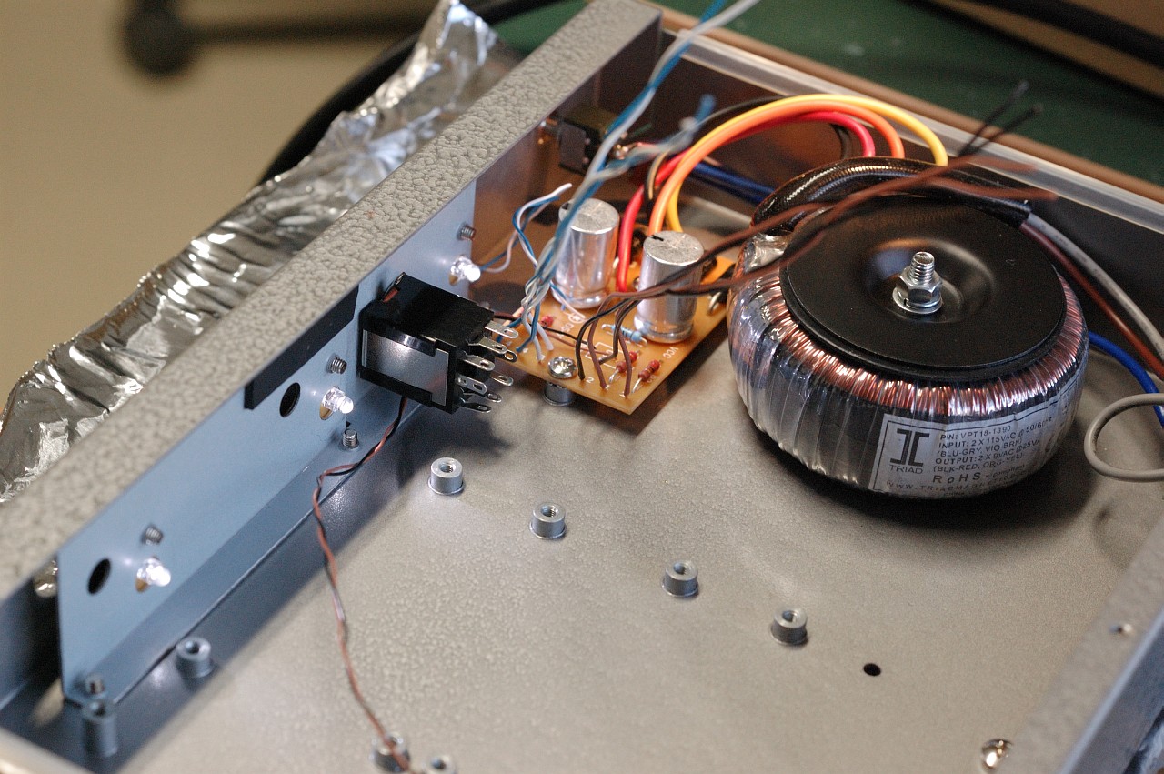

Progress so far
Posted 6th January 2012 at 01:02 PM by rjm (RJM Audio Blog)
Updated 7th January 2012 at 03:00 AM by rjm
The first stage is getting the power supply installed and running. That's the little board by the transformer, which just has the diodes, main filter capacitors, and isolation resistors on the voltage rails. The case top lid is transparent plexiglass, so the internals are lit by three white LEDs to show off, and light the control labels, which are printed on the top lid rather than the front and back sides of the case.
You'll notice I have followed the instructions and removed the plastic covers on the electrolytic capacitors.
For the record I do think they sound better that way, I just normally can't be bothered as, for example, my phonoclone 3 boards have 28 of them and I consider the exposed metal surfaces a bit of a safety issue as well.

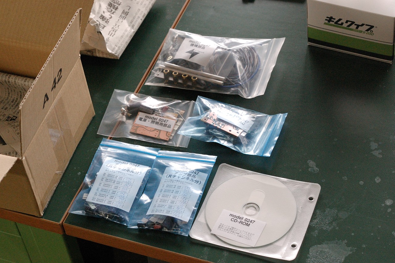

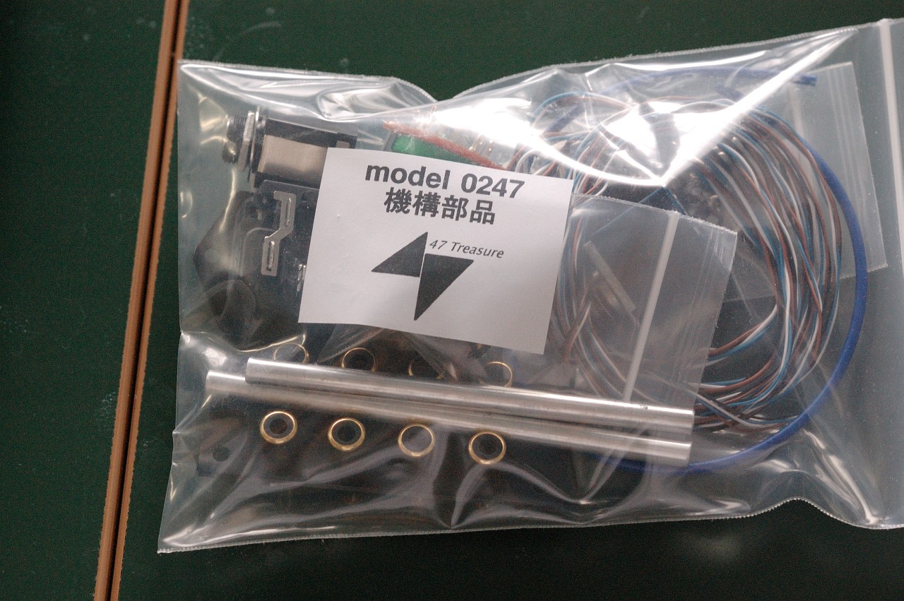

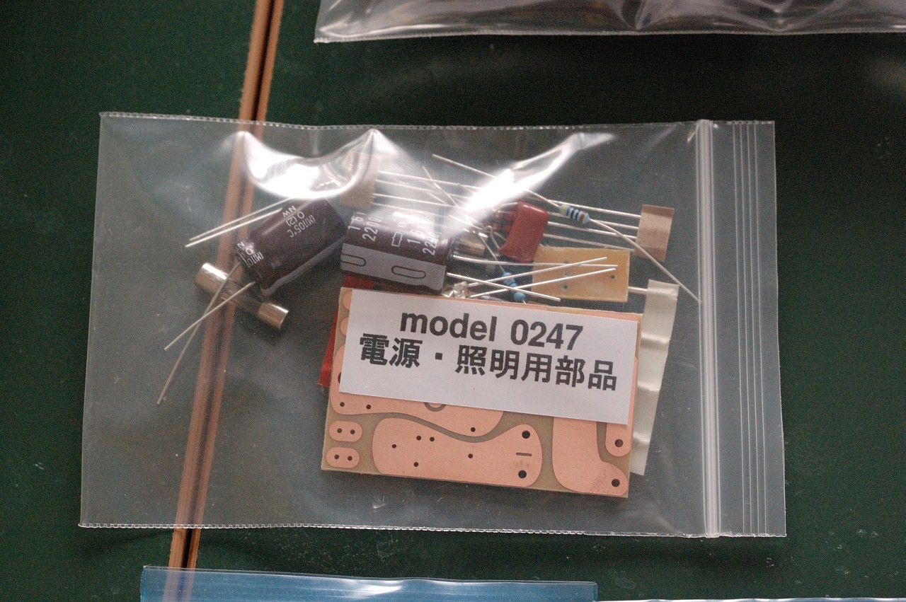

47 Labs 0247 unboxing, part deux
Posted 5th January 2012 at 11:29 AM by rjm (RJM Audio Blog)
My kit was missing the amplifier circuit boards! So many other neat stuff distracted me from this vital fact!
So far I've wired the AC power line components, transformer, and the power supply board. It's slow progress, mainly for wanting to be sure of getting it right the first time. It's dense and fiddly, desoldering stuff in there to fix a ****-up would not be pleasant work at all.

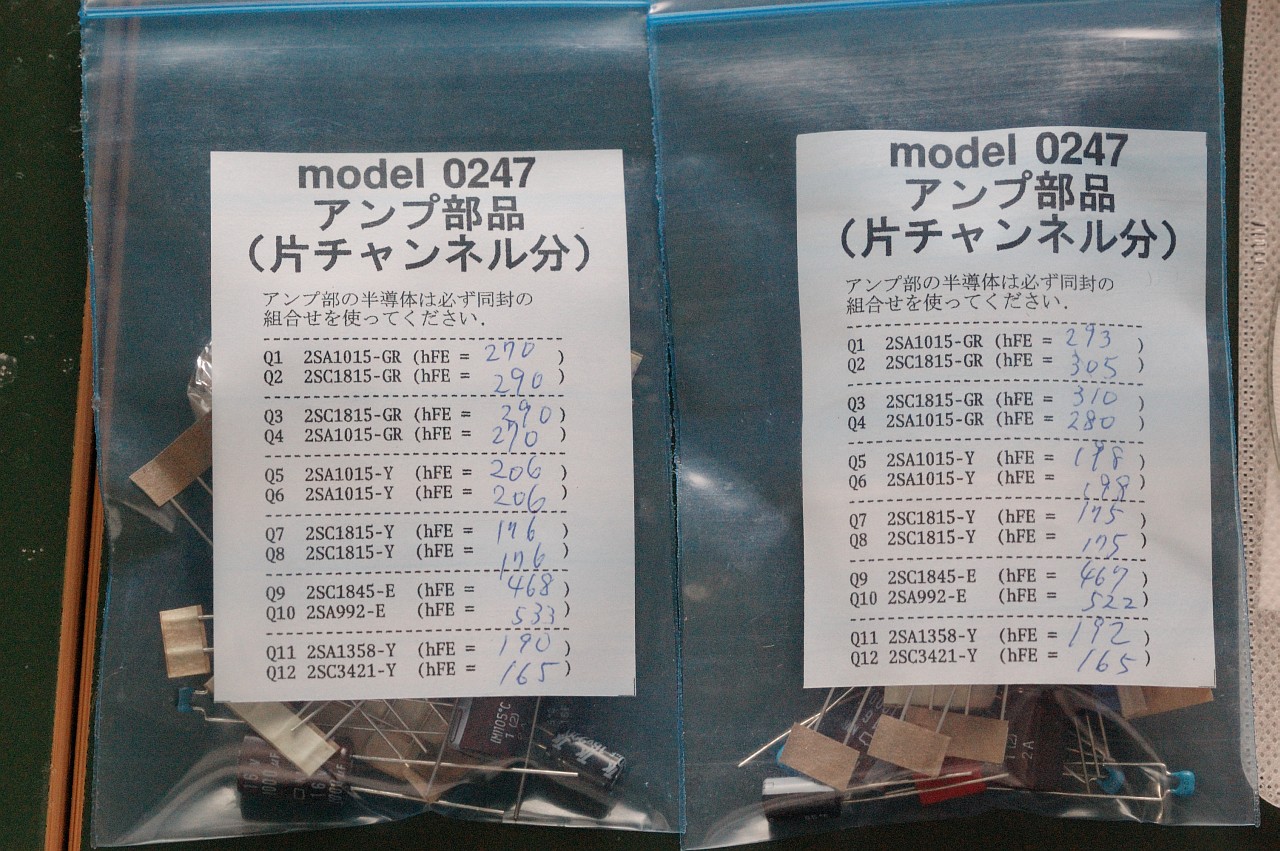

47 Labs 0247 "Treasure" unboxing
Posted 21st December 2011 at 04:33 AM by rjm (RJM Audio Blog)
Updated 22nd December 2011 at 10:47 PM by rjm
It's here!
It came in a box the size of a small shoe box.
Curious, delightful mix of the mundane and the exotic, outwardly plain but clearly immense thought and effort has gone into the preparation.
The gorgeous hammertone finish, hand-matched transistors, and ultra-high quality machined volume/selector knobs are the little signs that immediately set it apart from the ordinary.

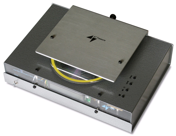

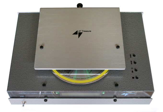

47 Labs 0647 "Treasure" CD player diy kit
Posted 17th December 2011 at 02:54 AM by rjm (RJM Audio Blog)
Updated 17th December 2011 at 03:01 AM by rjm
Fancy building your own CD player with built in non-oversampling DA converter from a kit?
Look no further.
Based on a TEAC transport and ye olde Philips TDA1543 for the nonoversampling DAC
DAC is basically the Progression DAC (see DAC of ther Klones) reborn.
or salient details:
-top loading, close to the lit to automatically load the TOC.
- isolated digital and analog power supplies
- ATMEL AVR microcontroller, custom program/operating system
- simple, easy to understand display and controls
- standalone or use as a transport with external DAC
- small footprint, B5 size(W250 H65 D175mm)
- comes with a remote!
Although offered as a kit or pre-built, my suspicion is that all the real work has already been done: programming the microcontroller, now that's an area where most DIYers still fear to tread!

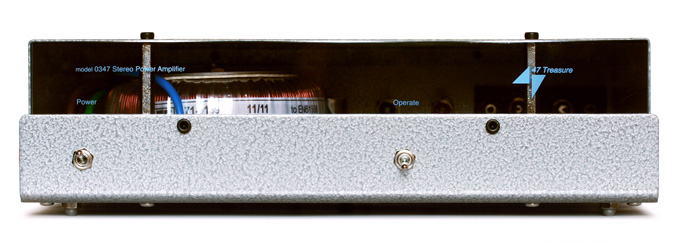

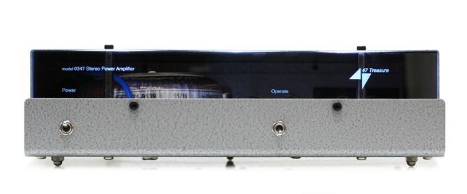

47 Labs 0347 "Treasure" stereo amplifier
Posted 16th December 2011 at 12:33 AM by rjm (RJM Audio Blog)
Updated 19th April 2015 at 11:27 PM by rjm
(regarding the Treasure 0347 stereo amplifier)
Well, think of it as a bulked-up headphone amplifier. The design is one of those "ah, I should have thought of that" moments, but the details are quite tricky, as usual.
If the extend the basic "voltage stage + current buffer" topology of the 0147 headphone amplifier out to 40 wpc territory, you end up with the 0347.
The high power means that unlike the headphone amp design you have to run it out of class A, and that means closed loop operation.
While most people might be tempted to wrap the voltage feedback around the whole shebang, this basically ends you up with a big op amp. Op amps, with their massive negative feedback design, are not so happy driving high inductance/capacitance loads like speakers.
The trick 47 labs uses is to have two feedback pathways, with heavy "local" feedback around the op amp and a small secondary global loop from...
