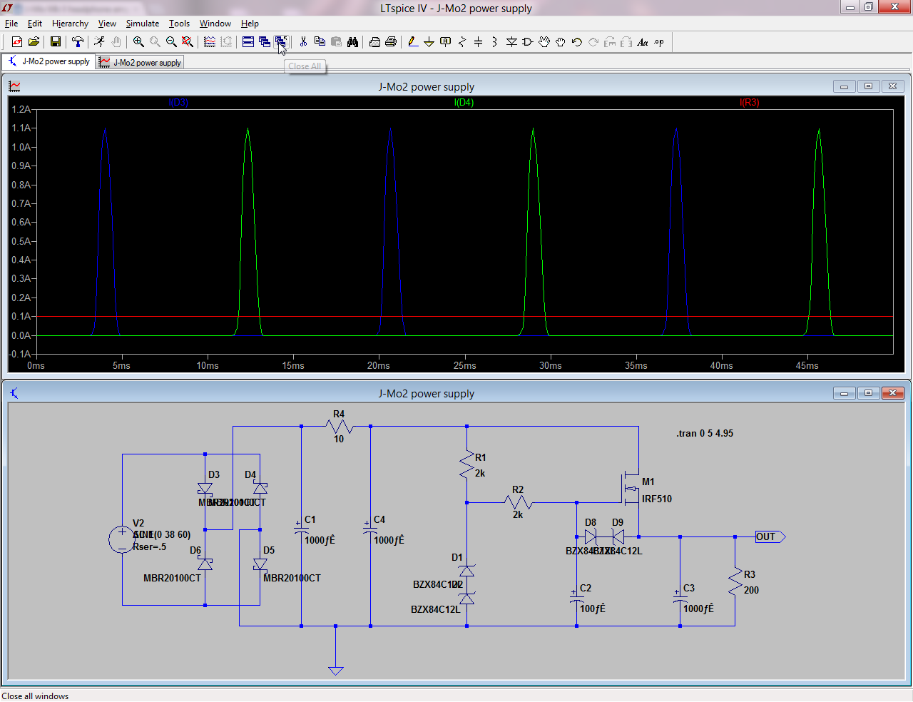

I tell people: "Buy a nice, heavy power transformer. It will sound better."
They are skeptical, because the circuit only draws a couple of watts, and less than 100 mA current.
The image below shows how the power transformer, and rectifier diodes, actually work much harder than you would estimate from looking at the output power.
It shows a zener regulated supply with a load drawing 100 mA at 20 V. That's 2 W.
As a result of the capacitor input filter directly after the diodes, however, the diodes and transformer do not conduct current all the time, but instead for just a couple of milliseconds twice every cycle of the AC wave. They have to supply all the output current in just that short space of time. As you can see in the simulation, the diodes are pushing peak currents well in excess of 1A or 10x the output current. This is a typical "normal" power supply with a initial ripple ratio of a modest 1/40, things only get worse in an "audiophile" power supply, with higher input capacitance, lower capacitor impedances, and ultrafast diodes.
As a rule of thumb, consider that the power transformer is running pulse-wise at 10x the DC output current. I suggest rating the transformer accordingly : i.e. getting VA for the peak A. That's a bit of an overestimate, but a decent guide nonetheless. Those sharp pulses can do all kinds of mischief with circuit inductances, too, and have lots of high frequency energy that can couple over into the audio circuit if improperly shielded.
It's my empirical observation that large, high quality transformers do a better job of damping out these spikes than small and cheap ones. Or perhaps more accurately stated: less likely to do odd and nasty things with them.
Your experiences may vary. However, it's worth keeping in mind.

    Nice read. Makes a lot of sense, although I would love to learn a bit more about what the current spikes can cause.
    Anyway, your simulation might be a bit optimistic too. You are forgetting about the big startup inrush current because of the empty filter caps, which on a very rough simulation on my pc started/peaked at about 12A and eventually balanced at about 1A spikes (with a similar but simpler circuit - just a resistor in parallel to the filter capacitors).
    Reducing the filter cap size (to something like 100uF) caused the current spikes to be reduced to almost half, but the voltage ripple was quite bigger.
    I guess it is a give-take situation...
    The thing is that we can afford more current (bigger transformer/bridge) but bigger ripple is always a big problem, although smaller caps might be nice.
    So QFT... do not cheap-out on transformer and rectifier specs...

    Sreten, the VA rating is quite precisely defined as the maximum AC current that can be drawn before the voltage falls below VAC_rated(1-regulation/100). This is a very valuable parameter, but does not tell you how big a transformer you might want to use in silicon-diode-rectified, capacitance-input power supply circuit for high-end audio. There is only a "rule of thumb" for the scaling factor s=VA/(output watts).
    My point was that "s" should take conductance angle into account. Anyone who designs power supplies knows that. Not everyone who builds DIY audio does.

    Another way of explaining it is to consider the current that flows through the transformer, diodes and filter caps without ever passing through the load.
    Posted 30th March 2012 at 03:50 PM by PChi PChi is offline
    True. In other words we have to take into consideration the power consumption of the filter/regulator as well...
    In the simulation if you check the current passing through the filter cap, it is almost the same as the that passing through the rectifiers...
    But even then, a 12VA transformer should have been enough to provide for the 1A spikes.
    And of course that consumption is way below the power abilities of a 160VA toroid @12V for example (13A to cover for 1A spikes).
    And still upgrading from a 48VA to a 120VA and then to a 160VA all made a big difference to the sound of the phono preamp.
    Perhaps there are other issues to consider too. Maybe bigger transformers are built with higher standards or precision to reduce risks and flactuations that should be less evident on smaller currents.
    Yes, but the voltage drop when attempting to do so will be much greater.
    The 12 VA (say 12 VAC) transformer has a regulation of ~20%, so at 1 A the output drops to about 10 V. A 2 V drop.
    A 120 VA transformer would typically have a regulation of about 5%, and that's for 10 A! So the voltage while making the 1 A current peak (1/10th VA rating) only drops on the order of 5%/10=0.5%, 11.95 V. A drop of just 50 mV. Rough numbers.
    Big difference!
    Now, how much difference this has on the actual sound is something we can debate all day, but the numbers suggest that it could be an influence.
