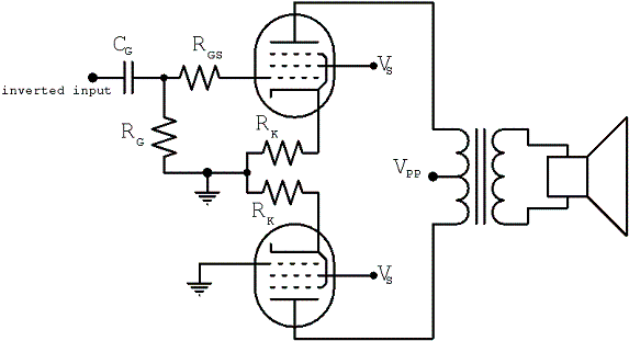

is this classic and standard circuit for push pull ?

It's just a simplified output stage for illustration purpose, what of it?is this classic and standard circuit for push pull ?

do you compare sound quality in this simple topology with classic push pull your self?It's just a simplified output stage for illustration purpose, what of it?
First, let me apologize, I mistakenly took the above diagram as a conventional PP output stage but after another look, it's not one at all, but rather a self-splitting type, which was commonly found in cheap radios/consoles back in the day, and some guitar players seem to like it too. The biggest disadvantage of the self-splitting output stage is that it only operates in Class A, which wastes power, and the biggest "advantage" is its lower cost - since a separate phase inverter stage is no longer needed.
Post 21 schematic is an attempt to make a push pull output into 'sort of a single ended' output.
You will notice that the cathodes are Not coupled to each other, there is No self inverting in this stage (the cathodes are connected to ground through their individual respective cathode resistors.
The "pull" stage control grid is connected through a grid stopper resistor to ground. That makes this un-driven pentode stage into a constant current source. the current merely balances the quiescent current of the "push" stage, so that a push pull transformer without air core can be used as a 'single ended' output.
In order to be a self inverting stage, the cathodes have to be tied together, and then through a suitable Common resistor to ground, or better yet through a current source to ground.
Second mistake of the day... had I bother to read the texts in the link or paid more attention to the drawing itself... sigh. But why are we discussing it in the context of PP amps?

Post 21 had one question: is this classic and standard circuit for push pull ?
I should have simply said no it is not.
