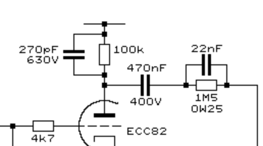

Well, I was more interested in these part of the circuit (in the attachment)
Looks like some kind of compensator? thought I might saw similar ones somewhere

guitarnerd,
Where did you get those schematics in post # 33? I do not remember seeing those. They almost look like some passive frequency response networks for something like phono preamps, or similar.
Take a look at the dyna stereo 70:
dyna st 70 schematic - Google Search
It has 2 negative feedback compensation networks:
1. A series RC (82pF 18kOhm) dominant pole from the input Pentode plate to ground (often found in amps). The dominant pole on your amplifiers may be your output transformer.
2. A capacitor from the screen of the bottom output pentode (Ultra Linear tap) back to the input Pentode cathode circuit (very unusual). Instead, these compensation caps are more often connected from the output transformer secondary (across the main negative feedback resistor) to the input pentode cathode circuit.
The main feedback resistor is 1k Ohm from the output transformer 16 Ohm tap to the input pentode cathode circuit.
With negative feedback that comes from the output transformer secondary to the input cathode, there are usually a self bias resistor and bypass cap in parallel from the cathode, with the bottom of that network to another resistor to ground. The negative feedback is applied to the junction of the bottom resistor and the self bias network.
if have more gain can use this kind of passive circuit for high frequency response .
