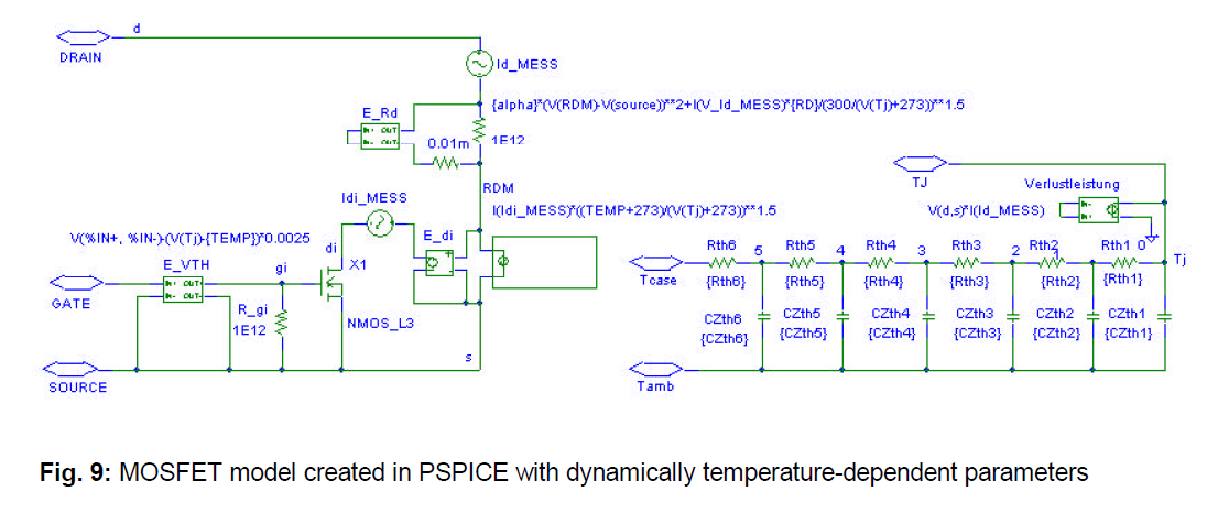

I think this is solvable with math using a system of differential equations for the heat transfer. You could make some assumptions like a uniform heat sink temperature, assume a mass and thermal conductivity of the transistor to heatsink junction. Each transistor is a heat source given by the equations of dissipation (electrical), then heat carried off by fins and radiated via natural convection needs to be assumed per rating of sink. You could make it complex by adding transistor to transistor conduction and not assuming uniform heatsink. Mathcad or Matlab will almost be essential to solving this. Although it could be modeled as lumped elements as resistor and capacitor networks and all done in LTSpice.
Check out this publication from Infineon, Figs. 8 and 9 in particular to see clues of how to go about this. It shows coupled electrical and thermal models for 1 MOSFET. Now add second and coupling between two via thermal model of heatsink.
http://www.infineon.com/dgdl/Thermal+Modeling.pdf?fileId=db3a30431441fb5d011472fd33c70aa3
Fig. 13 is good too.

It's the time-dependent part that causes thermal runaway, which I assume you would like to be able to capture? The heat conduction equation can be solved for SS by setting dT/dt=0.
Something that just occurred to me: if I'm to set this up in simultaneous equations or SPICE, there has to be something that starts the temperature difference between the devices. If all are the same, then so are the temperatures. So I guess I have to assign a cause by varying something in one of the BJTs ( I(S)? That would send things right off non-linear).
