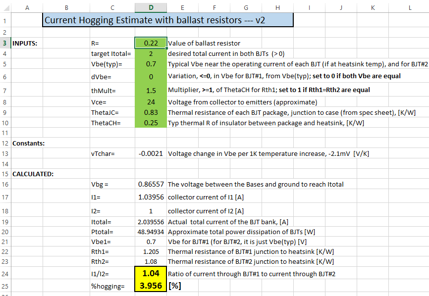

Spreadsheet, 2nd try
OK, try again...

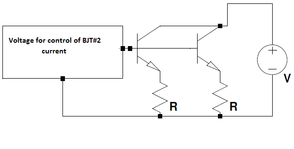

Assume that:
The value of interest is I1/I2, or the percentage that I1 exceeds I2. IOW, the amount of current hogging!
The current in either BJT is the voltage across its resistor R, divided by R. The power dissipation in either BJT is its current times Vce. The temperature of each junction rises above the heatsink temp by an amount equal to the power dissipation times its Rth, which causes a corresponding decrease in its effective Vbe. So
If you buy all these approximations, then a few things of note:
1) If the Rth values are equal, then the result doesn't depend on that value of Rth, but can depend on the operating current.
2) If the Vbe values are equal, then the result doesn't depend on the operating current.

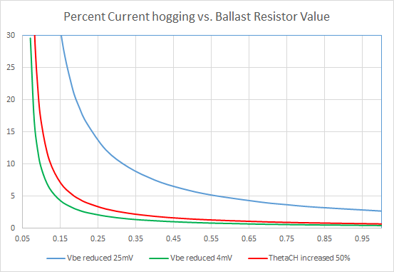

See the attached v2 spreadsheet if you want to play with the relationships. Attached is a graph of a situation I'm looking at with Vce~= 24V, Itotal = 2A, ThetaJC=0.83K/W, ThetaCH=0.25K/W. The y axis is "% hogging", the x axis is the value of R. The blue curve is for an assumed decrease of 25mV for Vbe of BJT#1. The green curve is for a decrease of 4mV for Vbe of BJT#1. In the blue and green curves, I hand-adjusted the target Itotal value to keep the calculated Itotal near 2A for all R values. The red curve is for an assumed increase of 50% for the thermal resistance of the Case to Heatsink for BJT#1 (might be about right for too much grease or a lump?). No target Itotal tweak needed for the red curve.
I picked the "4mV" value as something that might be practical matching for some 2SA1943N PNP transistors. Does that seem reasonable?

Assume that:
- Vbe(typ) is typical Vbe for linear operation if at the heatsink temp, somewhere around 0.7V
- Itotal is the approximate total current for the bank of bipolar transistors
- Vbg is the voltage between the bases and the lower net on the drawing
- dVbe is the voltage variation that BJT#1 has in Vbe, relative to Vbe(typ). (<=0)
- Vbe2 (for BJT#2) is assumed to be Vbe(typ); Vbe1 is assumed to be Vbe1+dVbe.
- ThetaJC is the thermal resistance of each BJT package (assumed equal)
- ThetaCH is the typical thermal resistance from package to heatsink
- thMult is a multiplier on ThetaCH, for BJT#1 (>=1)
- Rth1 is the sum of thermal resistances for BJT#1, equals ThetaJC+ThetaCH*thMult
- Rth2 is the sum of thermal resistances for BJT#2, equals ThetaJC+ThetaCH
- Vce is the approximate Collector-Emitter voltage of the BJTS (>1), assumed close enough to equal for all
- I1 is the emitter current of BJT#1
- I2 is the emitter current of BJT#2
- base currents are ignored
- Vbe varies by -2.1mV/K of the junction temp;
I(N) = [(Vbg - Vbe(N) -2.1E-3 * (I(N) * Vce * Rth(N)] / R
Collect I(N) terms as in feedback equation:
I(N) = (Vbg - Vbe(N))/(R - 2.1E-3 * Vce * Rth(N))
then
I1/I2 = (Vbg-Vbe1)*(R - 2.1E-3 * Vce * Rth2)/((Vbg-Vbe2)*(R - 2.1E-3 * Vce * Rth1))
then
